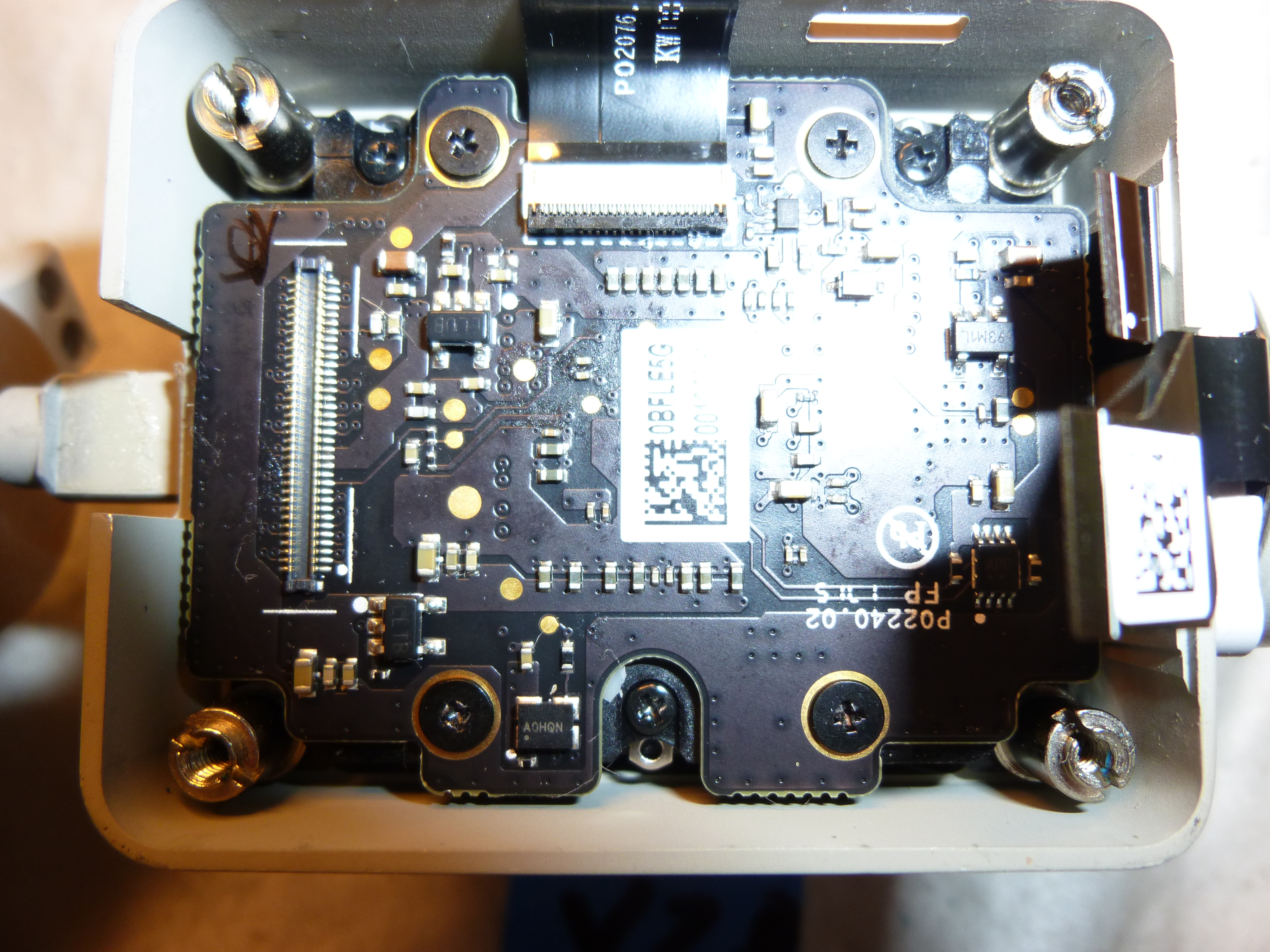

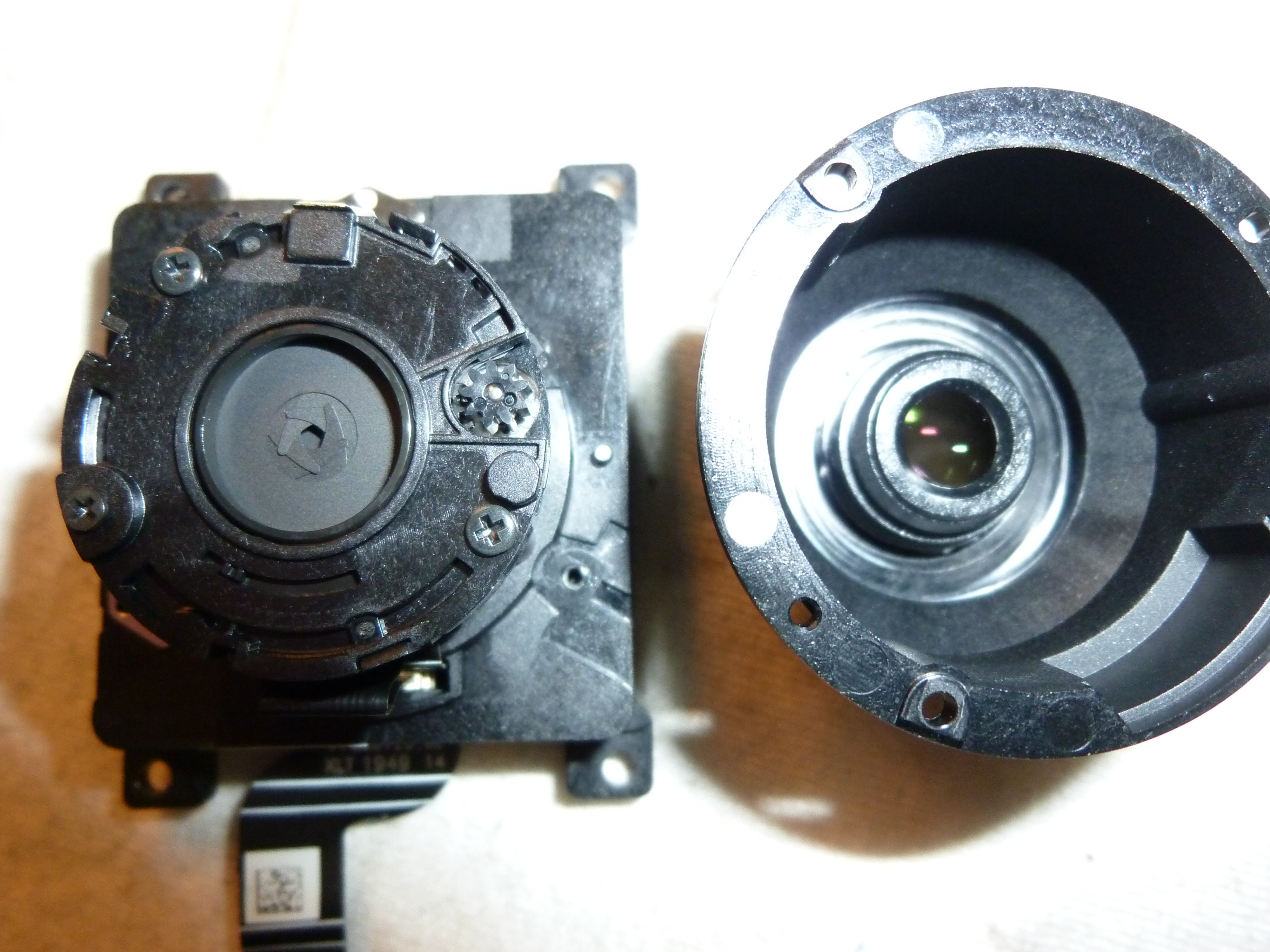

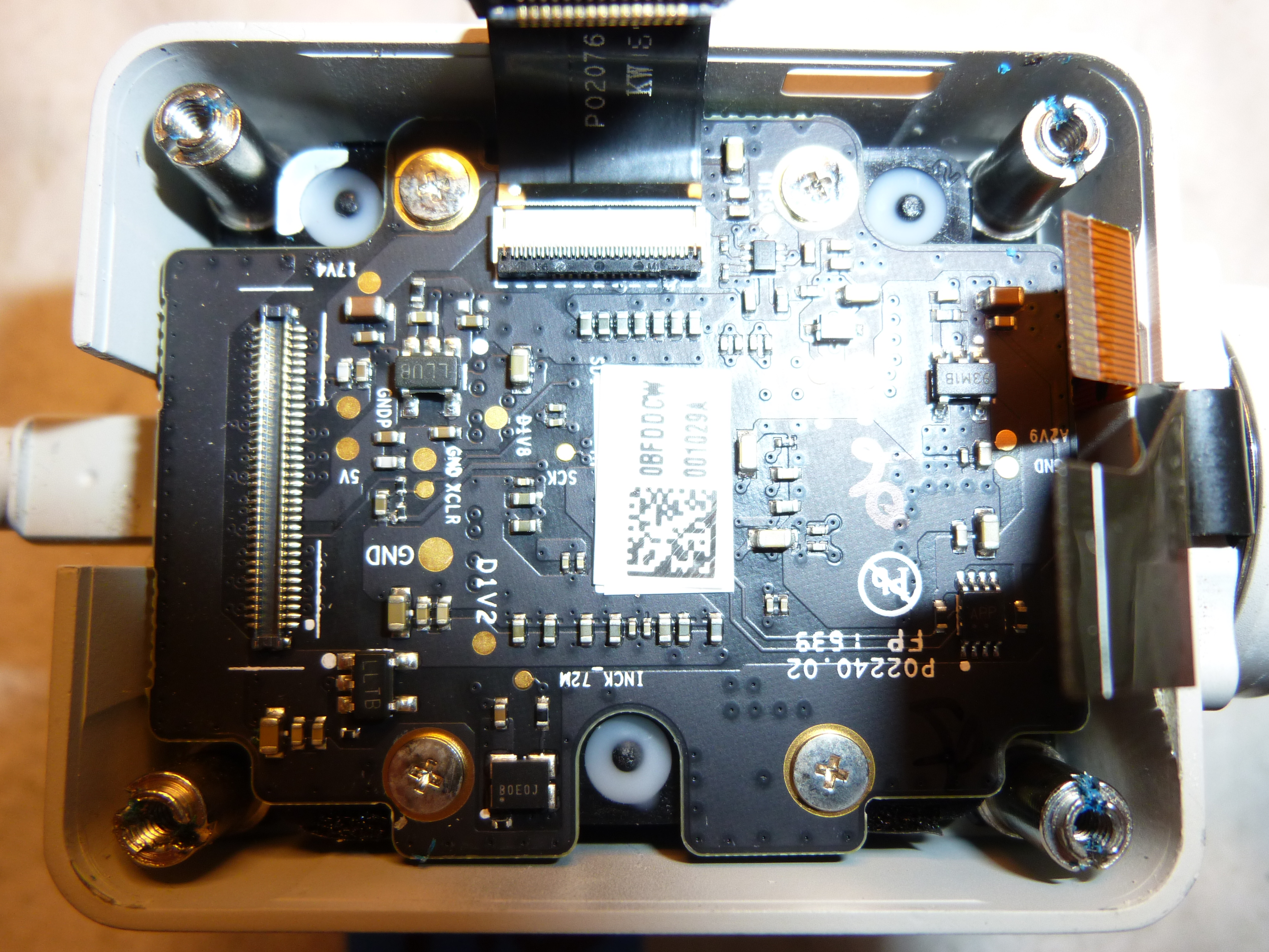

There is a difference. If you remove the back plate on the cam body & remove the top circuit board, you will see 3 black screws, 2 top, 1 bottom, at the perimeter of the board, see attached images. If you were to get gutsy & take that board off & access the lens module, you would see the shutter assy. The shutter works for stills only. The regular cam has smaller screws in the same location with white washers.
