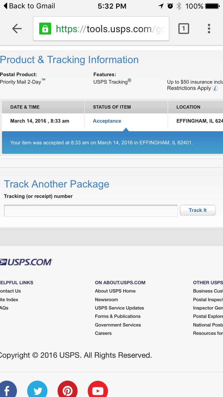

Will is there some sort of delay in deliveries? Horizon Midwest received my brand new batteries Saturday 12 March. I received the tracking number on Monday the 14th. And have not seen any tracking updates since.
Will is there some sort of delay in deliveries? Horizon Midwest received my brand new batteries Saturday 12 March. I received the tracking number on Monday the 14th. And have not seen any tracking updates since. View attachment 47672
My tracking did not show up until the day of delivery. It took 5 days counting the day I got the USPS tracking for my v3 to show up. So you should maybe expect your tomorrow, Saturday? That would be the fifth day for you.
I'll keep checking but gonna be 2000mi away this weekend. Thank god for good neighbors.

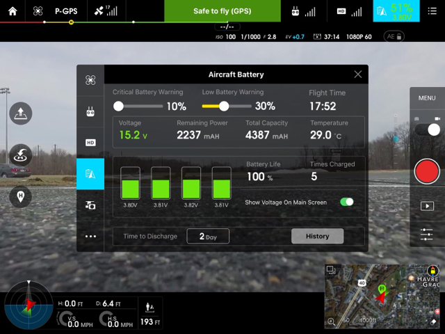

100% at 3.95v .. something is wrong here.. you should discharge to 10% and charge again..
I'll look into it Gizmoh, i noticed that too, late lastnite!
BTW, Gizmoh, i tried take off w/ (4) diff bats and they all dropped to 3.95-4.00 at takeoff w/ the exception of (1) I did with (2) 1800 lipos for comparison, it read 4.05 at take off. So i think the # is normal. Give it a try w/ your bats, tell me what you think!
Something tells me you have a problem with your main battery. The voltage reported in DJI Go is from the main bat.
The main battery (horizon modded) ends with 4.33-4.33-4.32-4.33
And starts the app with 20+ min.
That seems normal to me. Am i misunderstanding?

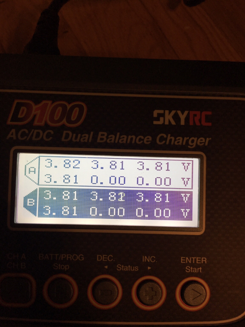

Not good. Other externals discharge evenly. This is weird. Here's a sample after a flight to 50% with Hyperions. I can't remember if they were 1800s or 2400s but look at the time and the voltages.
Reactions: dirtybum

Not good. Other externals discharge evenly. This is weird. Here's a sample after a flight to 50% with Hyperions. I can't remember if they were 1800s or 2400s but look at the time and the voltages.View attachment 47772
My uneven discharge rate between the externals and main battery may be the reason why I'm not seeing a gain. The externals have more voltage left in them. Perhaps the main is what is reporting voltage to the GO App. So I'm seeing 50% left when I land but in reality if the two battery sets where discharging evenly I would see/gain a little bump in voltage remaining.
I wonder if this is discharging unevenly because we were told to connect both the balance lead from the externals and the XT60 connection? I mean the balance lead is working. When charging the whole thing it is doing a good job balancing all 8 cells. I may try leaving the balance lead disconnected tomorrow just for kicks to see what happens.
