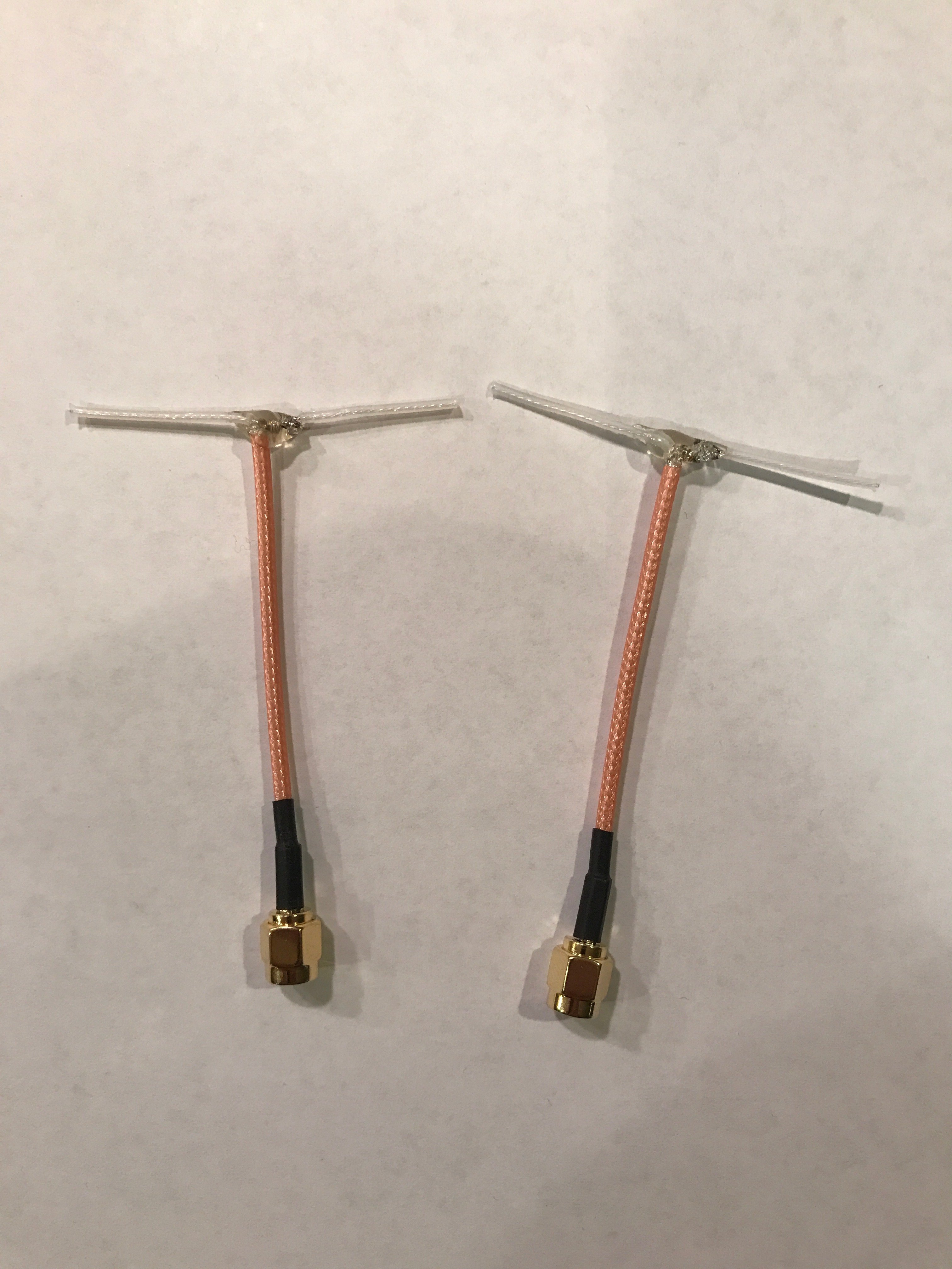

Honestly, I have no idea on specs like that. I would have no way of testing something like that. It's just a simple 2.4ghz dipole. No magic here at all. All I know, and the others members on this thread will confirm, is that it definitely and noticeably improves video range vs. factory.
A weekend? Nah... this takes like 1/2 hour tops. An hour maybe, if you made them from scratch.
The connection is made in the same place as the originals, on top of the camera/gimbal with rp-sma to u.fl connectors.

In the mean time, if anyone would like to build their own, I will gladly give dimensions and instructions on how to do so. (requires intermediate soldering skills).

OK. Hopefully this makes sense. If not, I will clarify. yjander, I hope you don't mind that I stole your photo.

Well I've got the antenna made now to do the bird side modifications......
Nice. If you want to strengthen that assembly up a bit, cut a zip tie to 60mm, then cut 2 peices of black heat shrink to 30mm. Put the zip tie along side the "legs" and then put the 2 peices of heat shrink on. Like this:

Bought from mats175 and installed. Comparison test flight was with itelite on controller @ 1000' distance and 400' altitude surrounded by 100' trees. With stock antenna, video was choppy. With the dipoles video was steady. More tests when the weather warms up.

Is there any reason I can't use the existing wires that go to standard antenna's (by cutting them off) for this mod and mount them internally or vertically inside two legs - without using the SMA connectors?
The only reason I could think of is if the cable isn't shielded? I haven't cut one to check.

No, you cannot cut and splice the factory co-ax.
