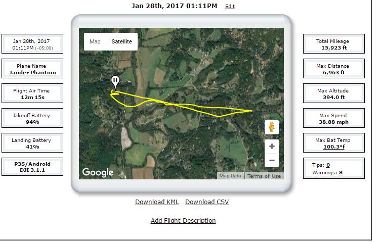

awesome. I went up to the mountains this weekend and I got 6,900 feet this weekend. My video feed was solid the whole way, but it was my 5.8 transmitter signal that was making RTH. I kept fighting it, but the AC kept turning around to come home. I have ARGtek mod and was using the three flat directional panels. I am really impressed with the video feed, it was clear the whole time turing the RTH.
Where do you get that image from? How are you tracking that information? I am just starting out in this and have the Alfa mod on its way to me. This dipole mod looks like something else that I may have to look into.
