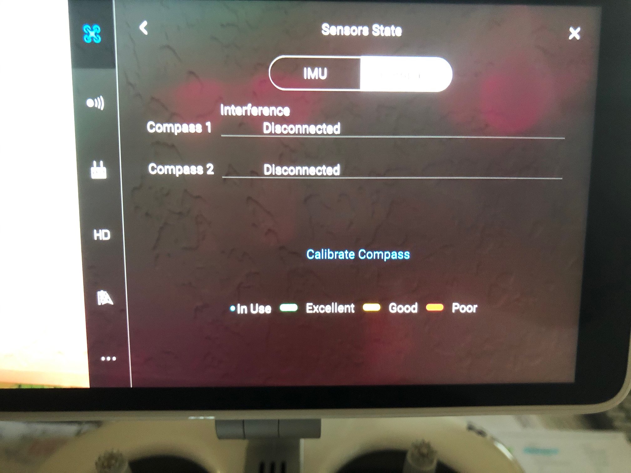

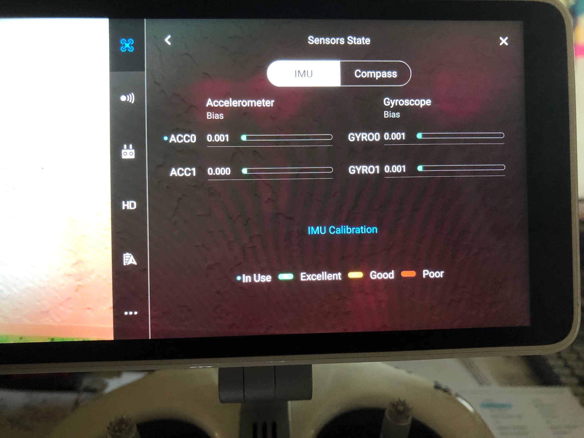

1. When checking settings, Sensors, IMU calibration is good, although I went through that step as well, moving the a/c around as the calibration directions called for. When I selected the COMPASS tab, it says: COMPASS DISCONNECTED. So, I selected the Calibrate Compass tab, and it just goes back to the Go Fly desktop, with the same error message: Compass needs to be calibrated...
If the compass is disconnected, it will always have the message suggesting recalibration is needed.
Recalibration will not fix the problem.

2. I've tried it in an open field around my location, I'm real rural, closest airport about 30 miles, I am in mountains, about 6k feet altitude. When i tried the IMU calibration first time, before the step was completed, I could select compass and it showed to have some green bars, but will only allow the IMU green bars, showing acceptable level of interference most of the time.
This is confusing
Where did you attempt IMU calibration?
It should be done on a perfectly flat surface and indoors is just fine.
The IMU is completely separate from the compass.

If the app settings show disconnected, one of the compass sensors is disconnected.
You won't see it by pulling off one of the tab.

Can the Highdesert post a photo of his sensor status page in DJI Go4.
This is the same page that Meta 4 included in post no.2 , we need to see the error messages and to see which compass is disconnected (1 or 2)

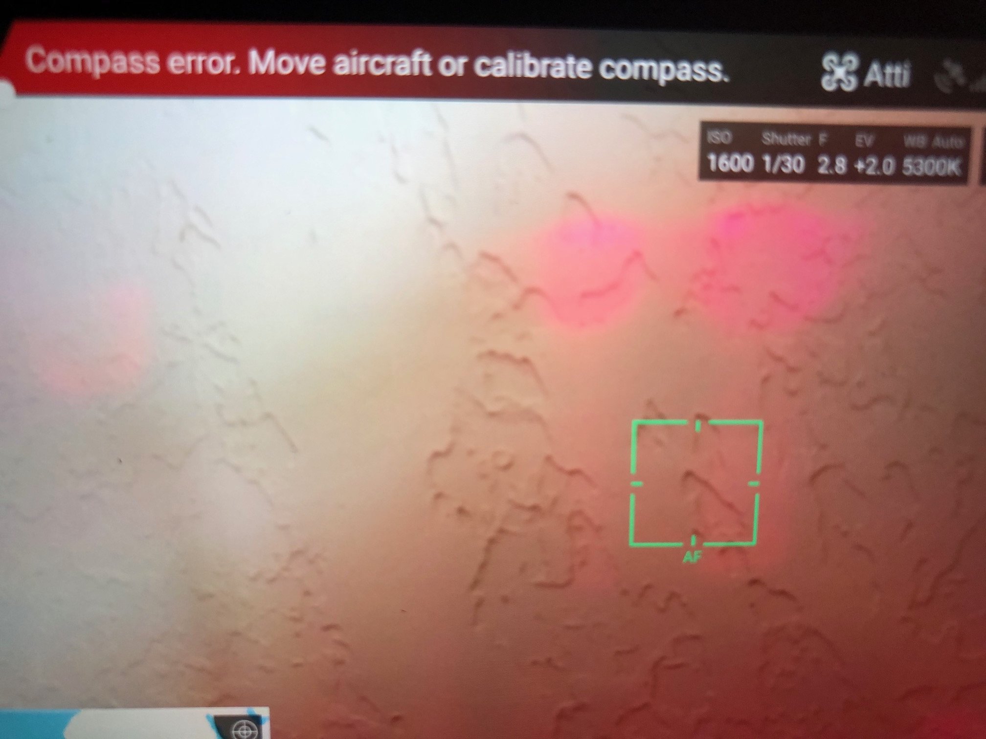

Sorry for all the info. Please see pics that shows BOTH compasses Disconnected...also see error message. THANKS!
Yes, we believe you. As being said the compass needs to be repaired as it is obviously a mechanical problem here.
