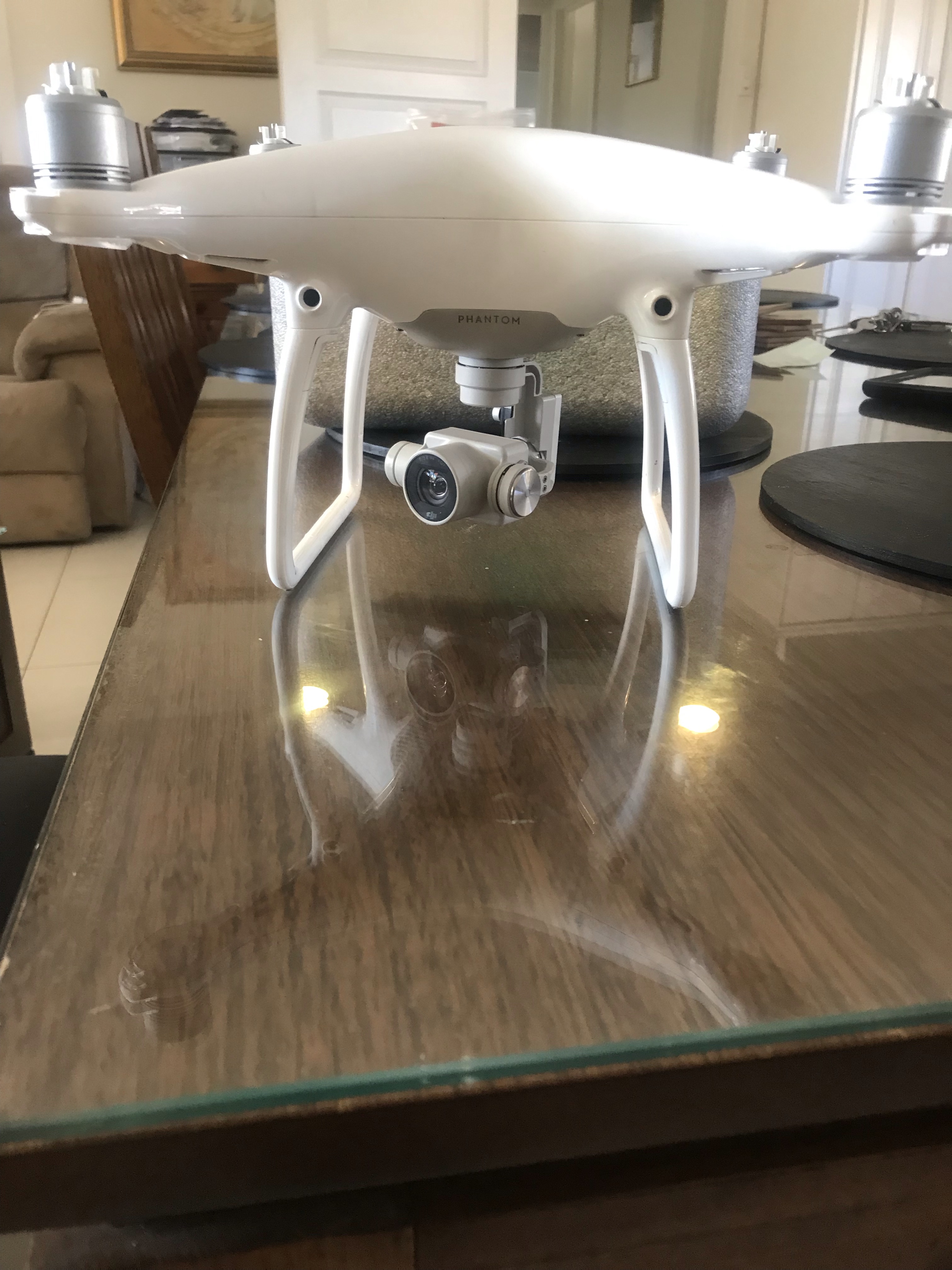

I had problem with the yaw motor it was shaking and overloading so i replaced it with a new one from eBay
Now everything is fixed except the camera is not in the middle its pointing to the right when you calibrate it and you can see the right leg when you flying
Anyone knows how to bring it back to the centre calibrating or doing something

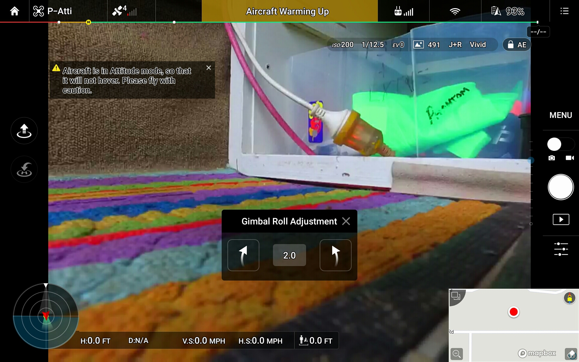

Have you tryed gimble roll trimming,,left or right,,does that work and save,,,my p4 on ice so can't screen shot info,,,,,,,this picture from p3 but p4 should have same or similar
Also through litchi you can adjust it left right but I think it'll go back to original after AC is powered off

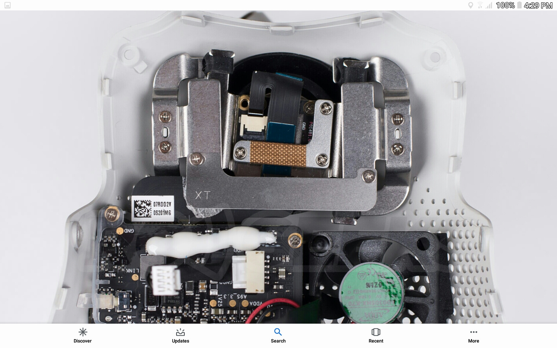

I was told to keep the motor cap in the back but the magnet was broken
Not sure if you are saying you this magnet was broken, but this guy's method WORKS:
I''ve done this repair 3 times and it's worked each time.
Alternatively, this also worked when the damaged gimbal was FUBAR:
HTH!
