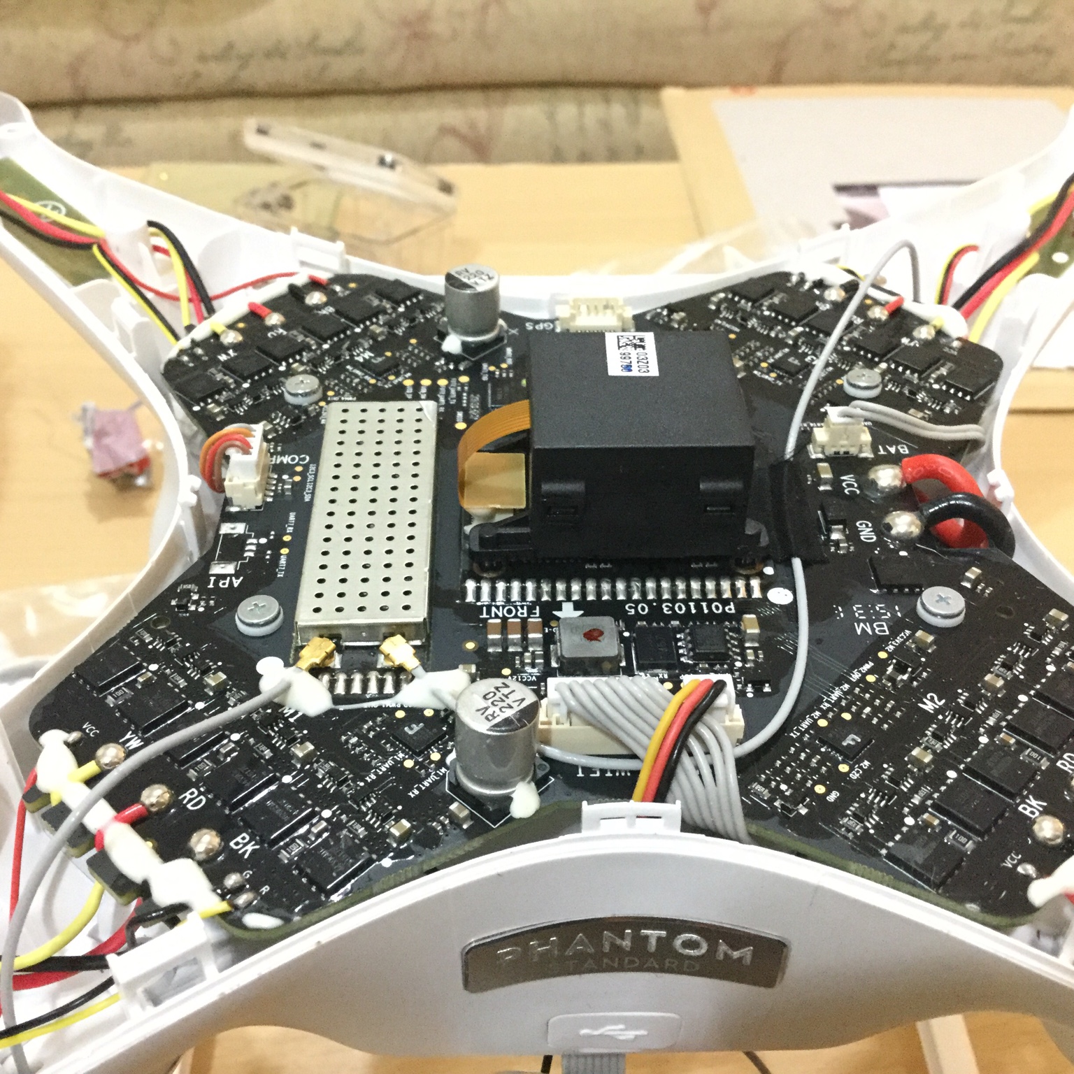

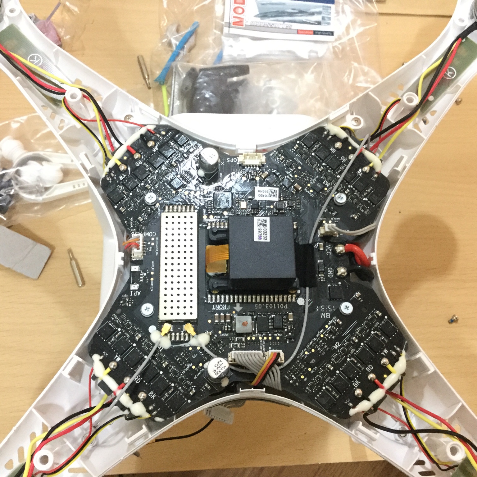

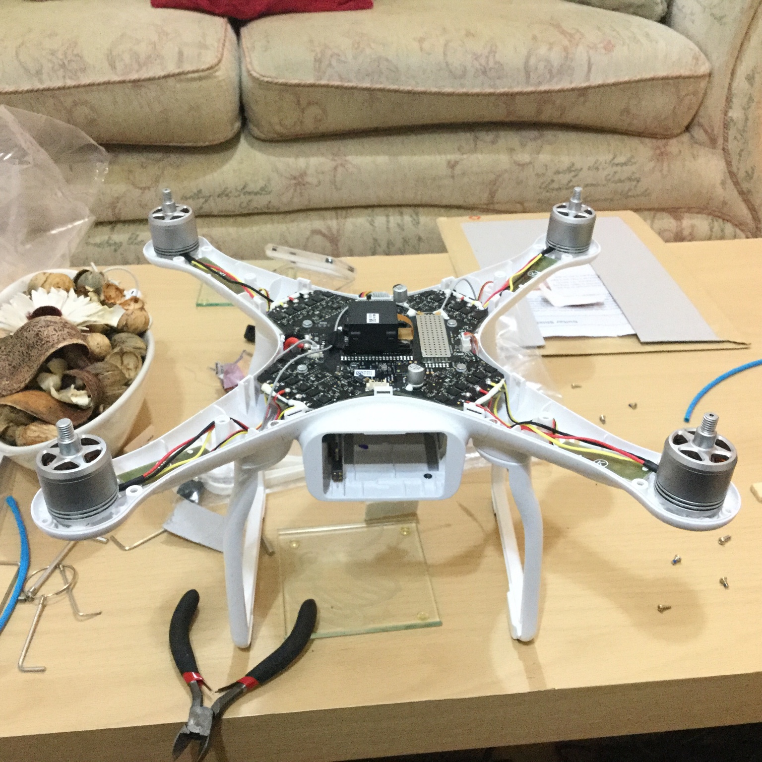

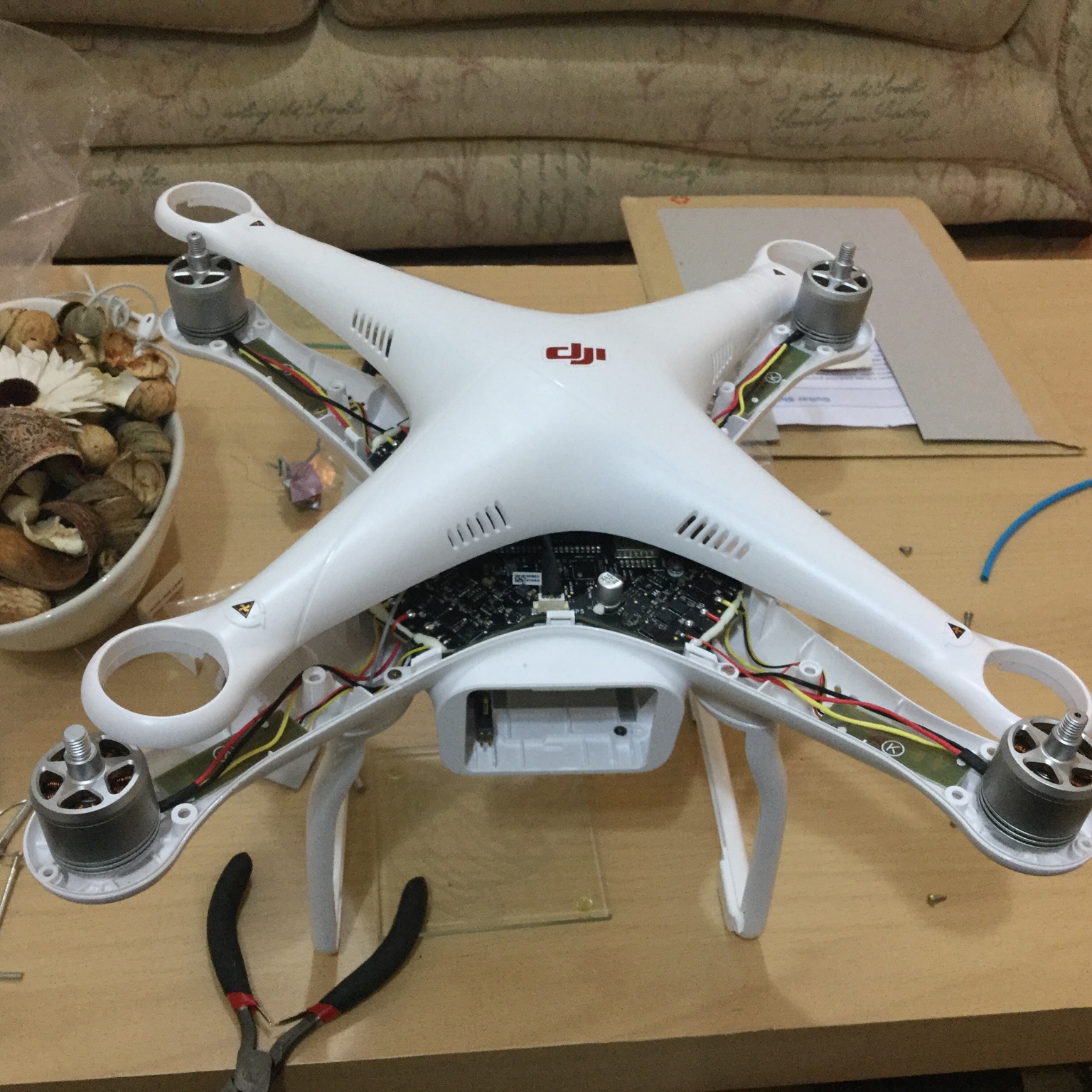

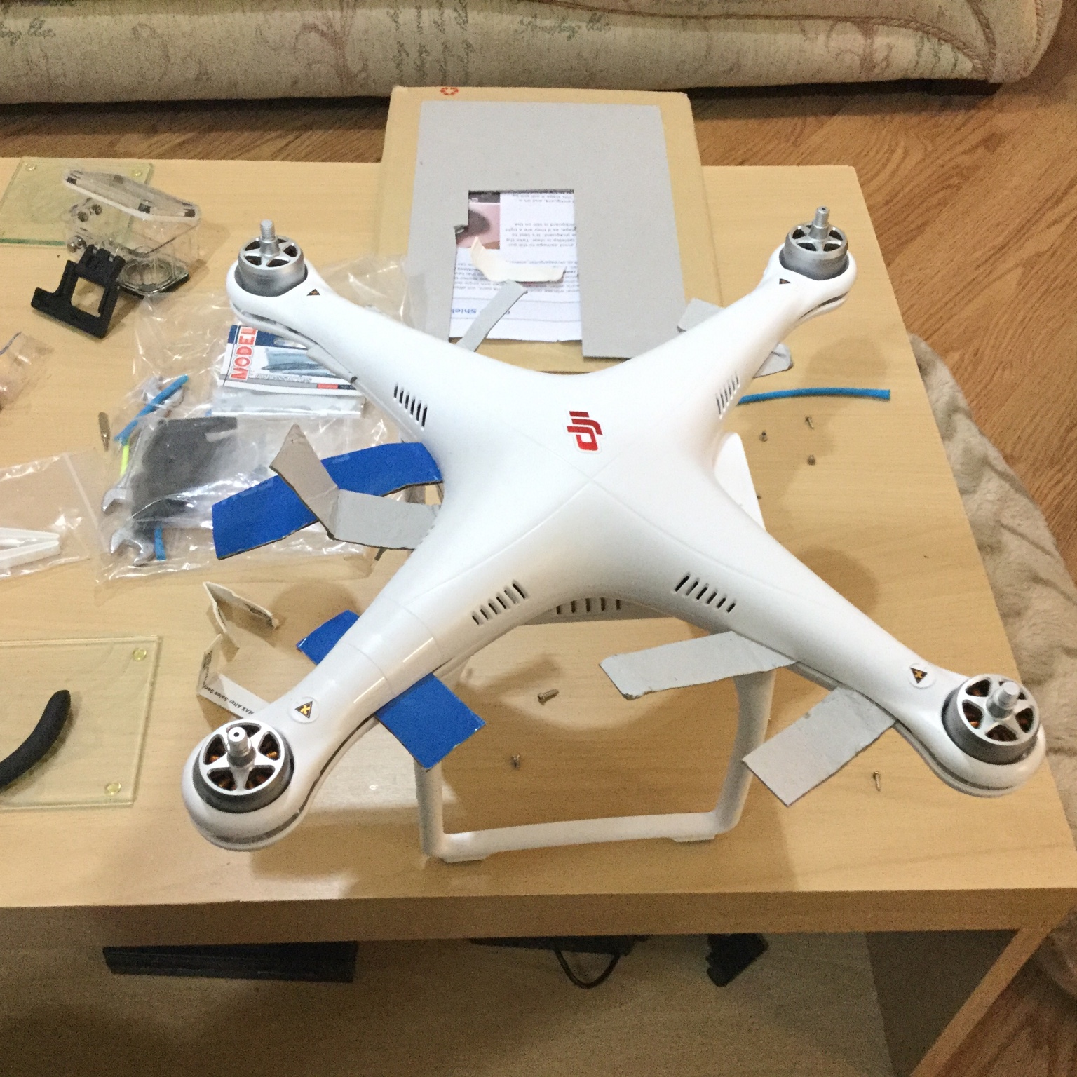

Decided to replace the shell... Progress so far (taking off the old shell)
More follows...

Decided to replace the shell... Progress so far (taking off the old shell) View attachment 45593 View attachment 45594View attachment 45596View attachment 45597 View attachment 45598
More follows...
