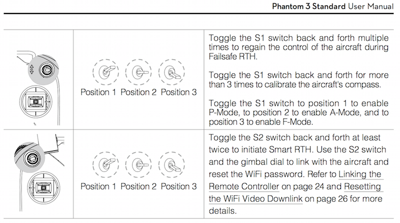

    okay so I just received my phantom 3 standard what are the S1 and S2 switch I did so much research before I bought this and I have no idea what they are for!!! Someone help I don't wanna blow up the whole drone by flipping one of these switches up or down!

    It is a pleasure to welcome you to the Phantom Pilots forum. I hope that you will take advantage of the benefits that come with membership and that you will be able to use the forum for the exchange of innovative ideas and as a resource for current developments in Phantom quadcopter’s.
    I would suggest you download the online full manual and familiarize yourself with it before flying. It contains lots of pertinent information. - https://dl.djicdn.com/downloads/phantom_3_standard/en/Phantom_3_Standard_User_Manual__V1.4.pdf
    To answer your question...

    Think the S1 switch needs to be in the position 1 most of the time for beginners...

    Don't guess. Read the manual.

    Wise words indeed sir....however the manual I have does not mention when to flick the switch....

    This explains so much! Thank you
