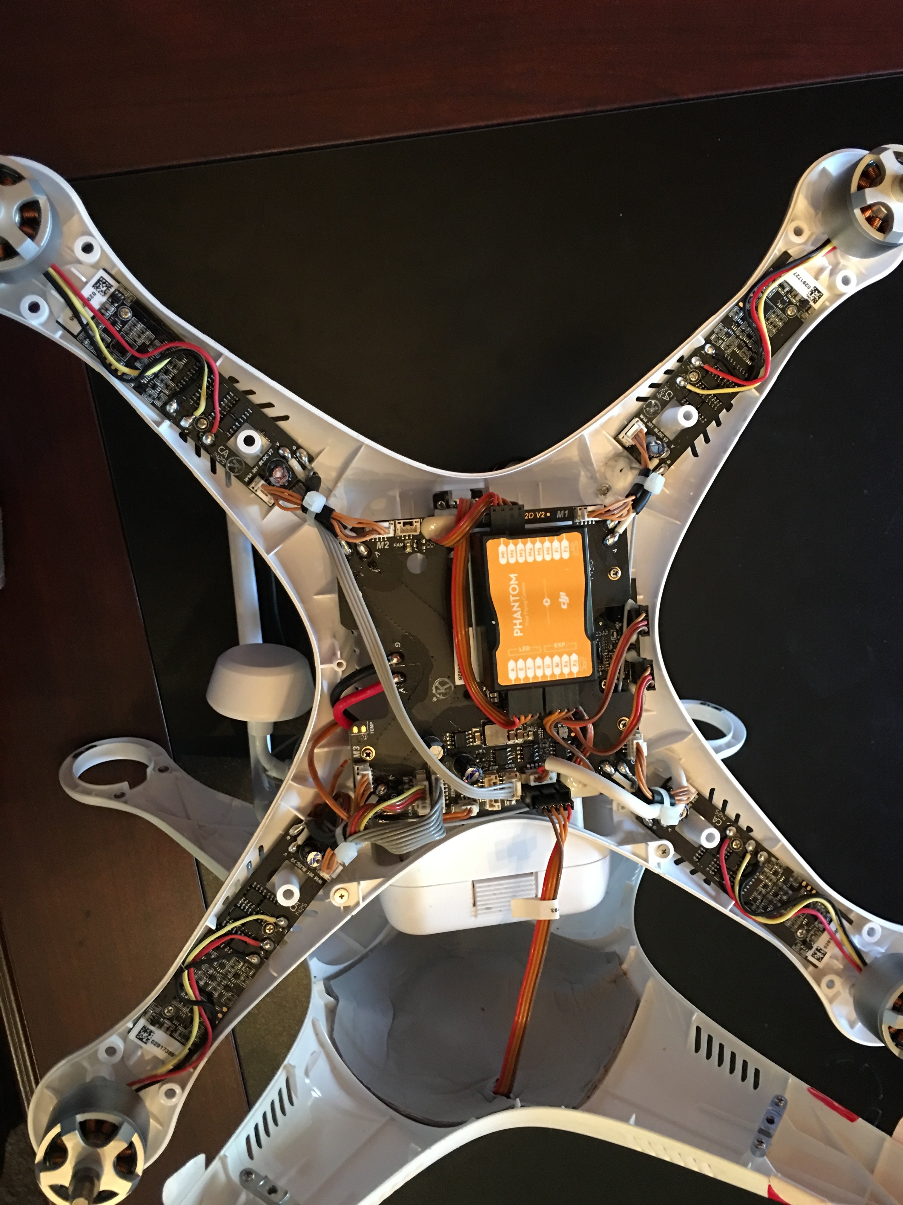

Are all the components on the outside of the P2 or some inside the shell? The best way to help is for you to help us take photos and post them so we can see what's wrong and fix it .

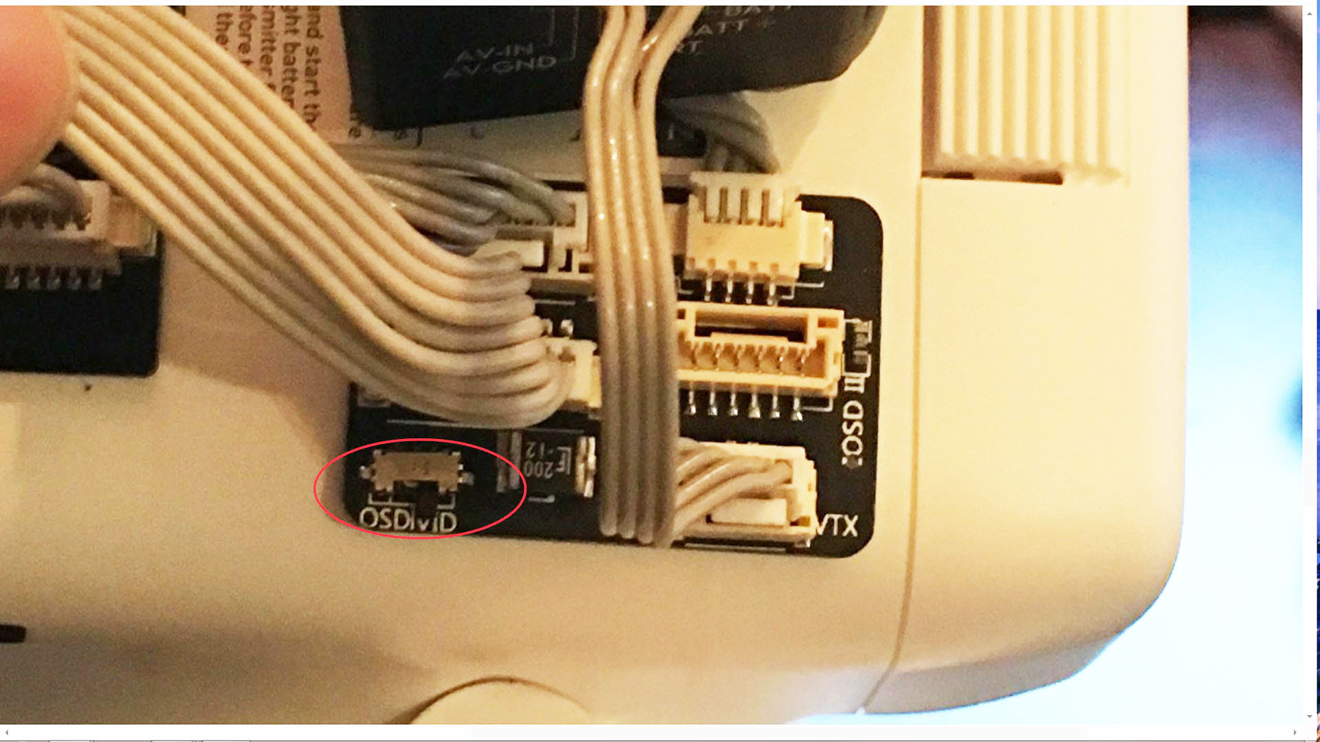

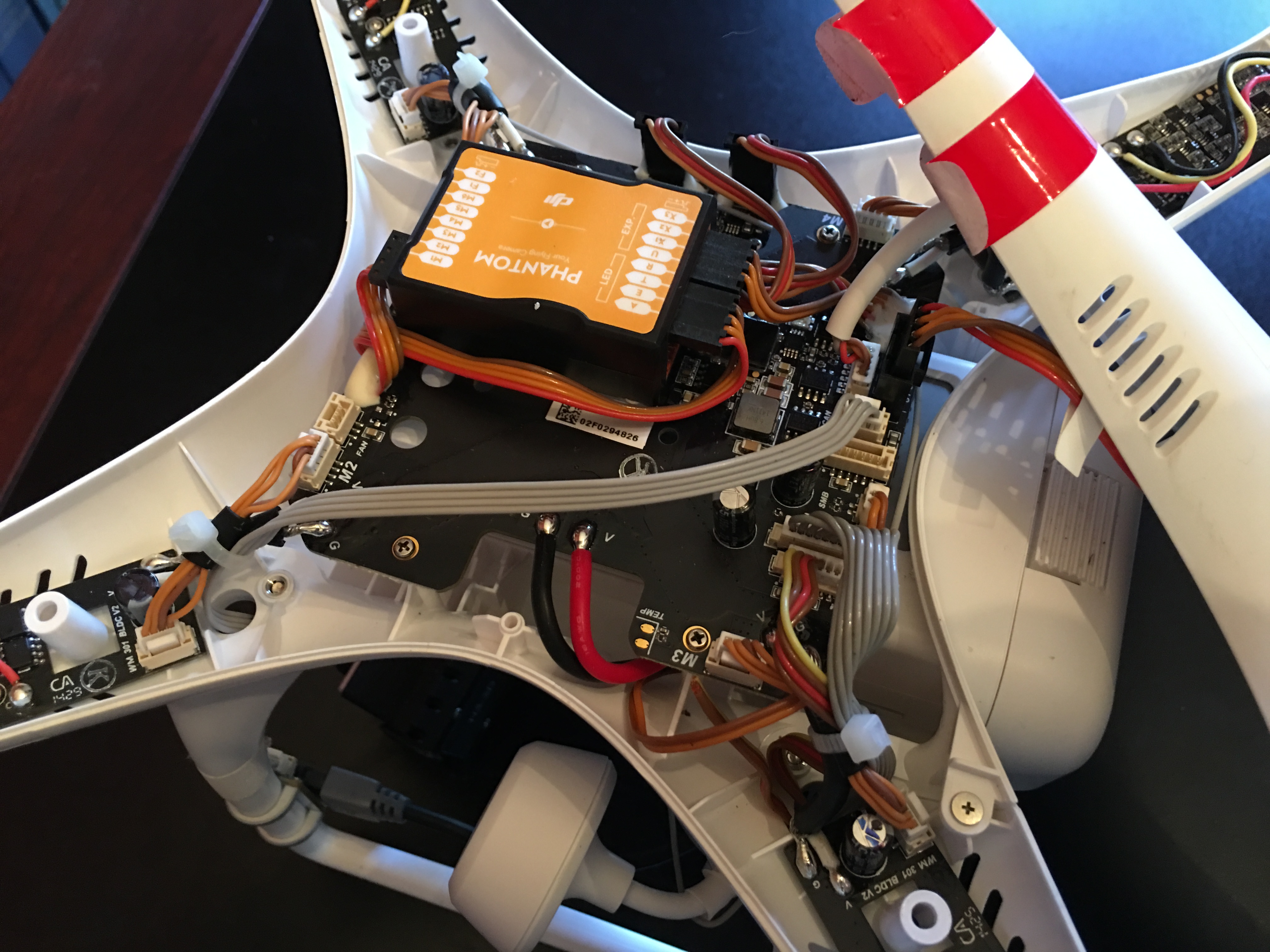

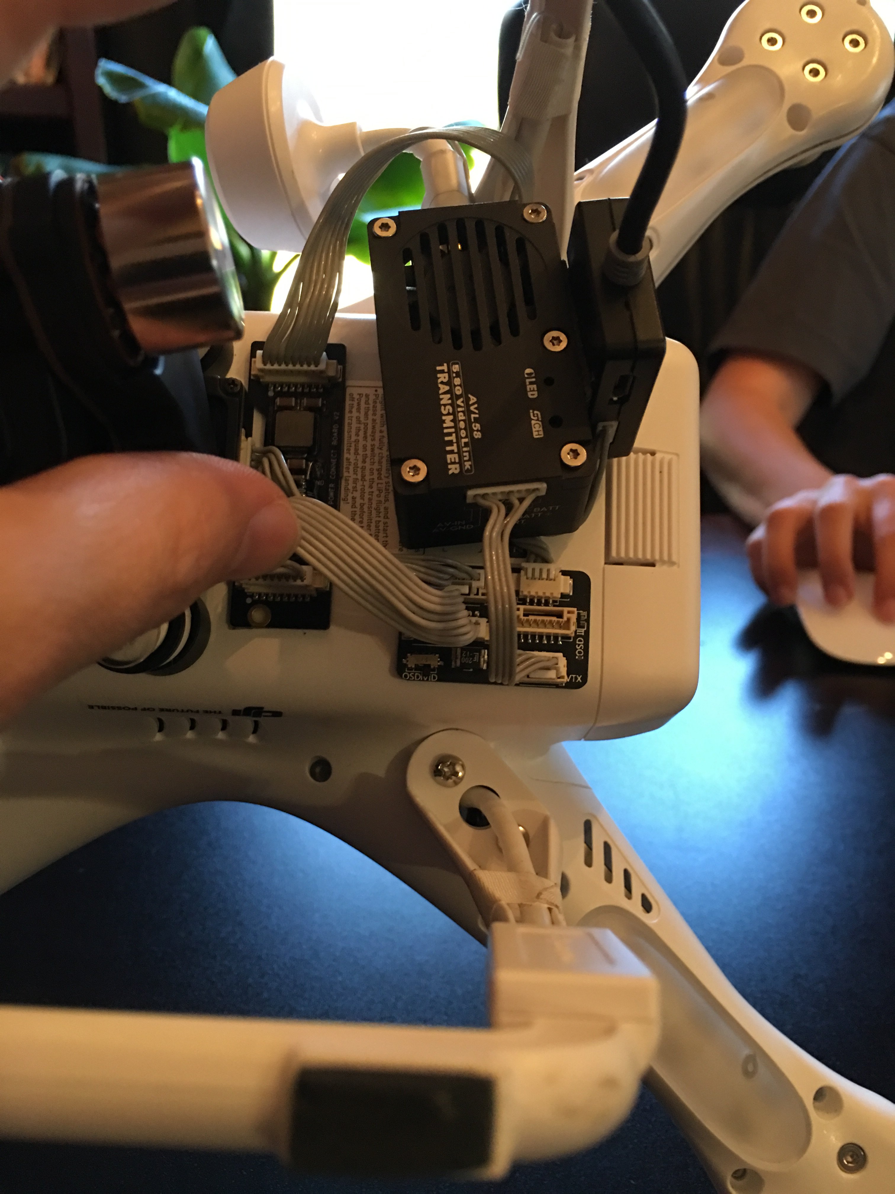

Here are some pictures of my setup.

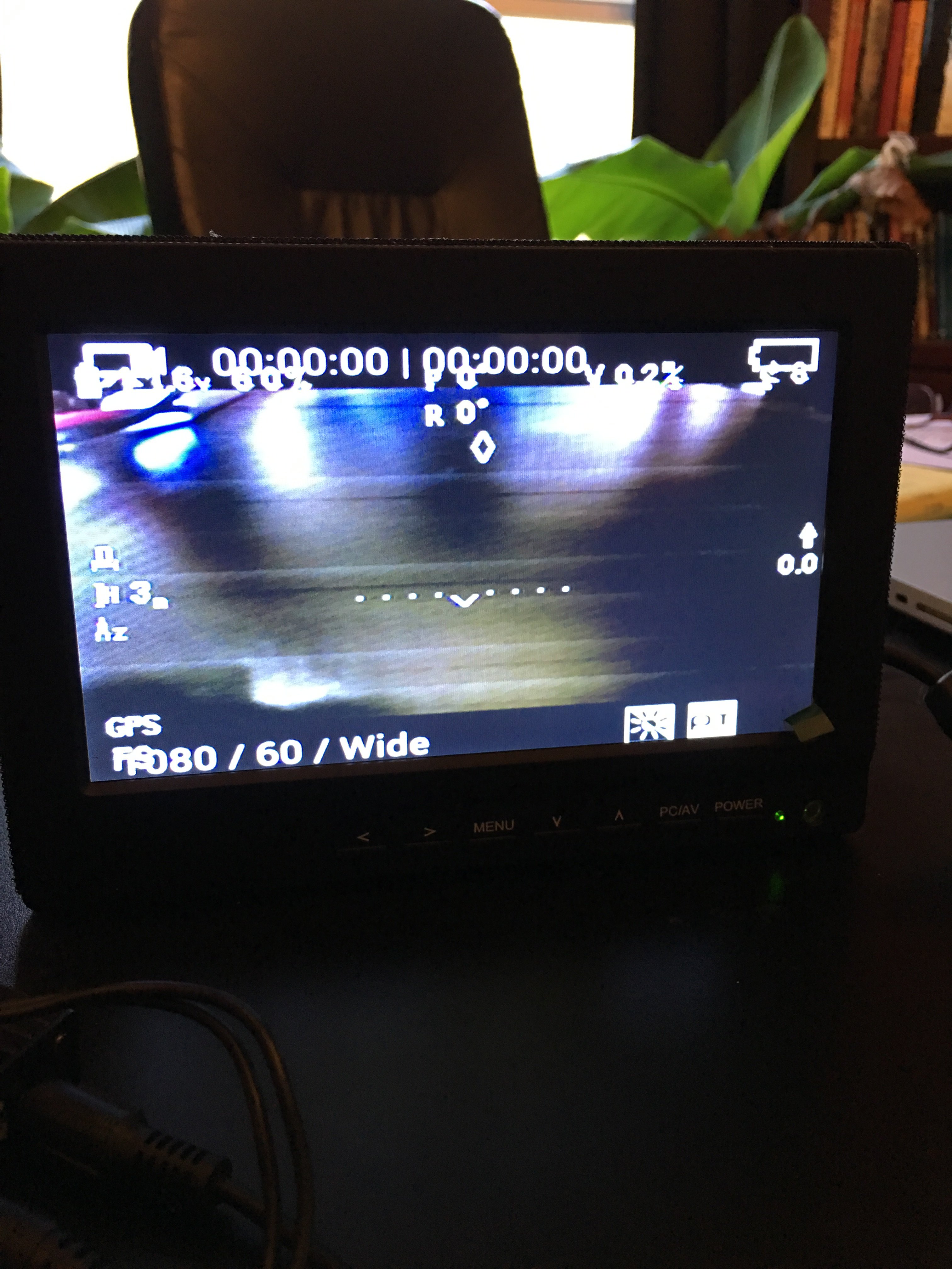

Wow. Can't believe it was that easy. LoL. I guess why I have you, I would ask another question. Is there something I can do to make the image on the screen more clear? It's really low def and often skips/flashes.
There's a lot that can be to cleanup the underside of your P2 and cut down on weight.

Yes I removed the AVL58 and replaced it immersion TX as the AVL58 was heavier and used more power to run the fan Plus I used plug n play cables instead of the DJI HUB.
