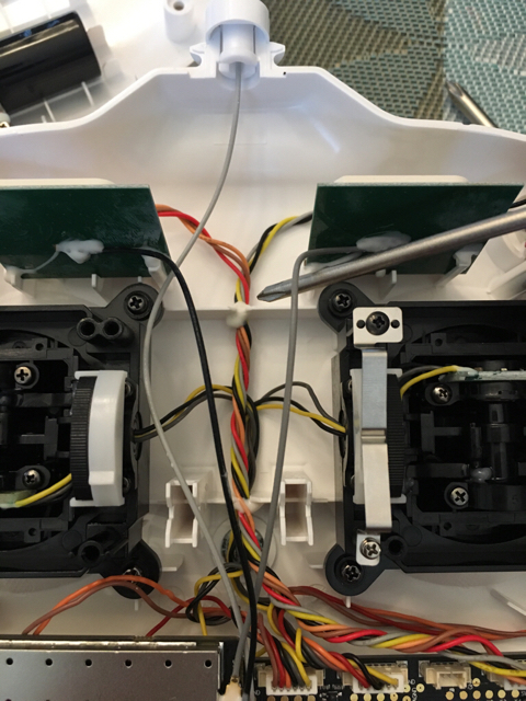

    Had a question to those of you that have done the Inspire mount mod. I've taken my controller apart and it seems there's a bundle of wires and also a plastic ridge right where I want to drill. Obviously, I want to move the wires before I drill, but what about the plastic ridge? Do I just cut it away? Will I lose some rigidity in the controller?

    Don't worry. Once you've removed the silicone holding the wires in place you'll see there's already a gap in the ridge. The hole you're going to drill will be right in that gap, but it's not a bad idea to cut off some plastic from each side of it for better clearance. You won't make the controller weaker by doing so.

    Thanks for the responses. Makes me feel better before I butcher my week old controller.
