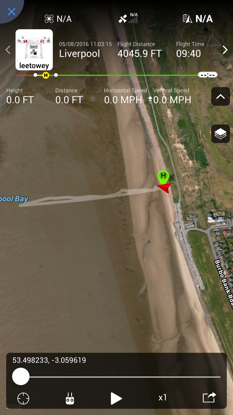

Guys if you would like to see the flyaway footage:
Is this video from the card cause it's NOT normal speed it's slightly in fast forward.
Yeah, I kind of FF toward the end, there was a spot I noticed there was some cars that seemed like there were moving really fast for a neighborhood area. Didn't think much about it, I kind of related it to searching through the vid.

Glad you got it back. Very lucky how it just went down into the person's garden. It was nearly a clean landing.

One month ago similar happend to me. The camera view picture went grey and the 'No connection' status was reported.
I found the drone after couple of days laying upside down in the grass just in the place indicated in the recorded data and with no damage at all, although one of those days was pretty rainy. The reason why didn't I look at the flight record file at the first place, was because I thought that it is of no use, as rhe connection was broken. So I assume that even at lost connection message something is still recorded.
