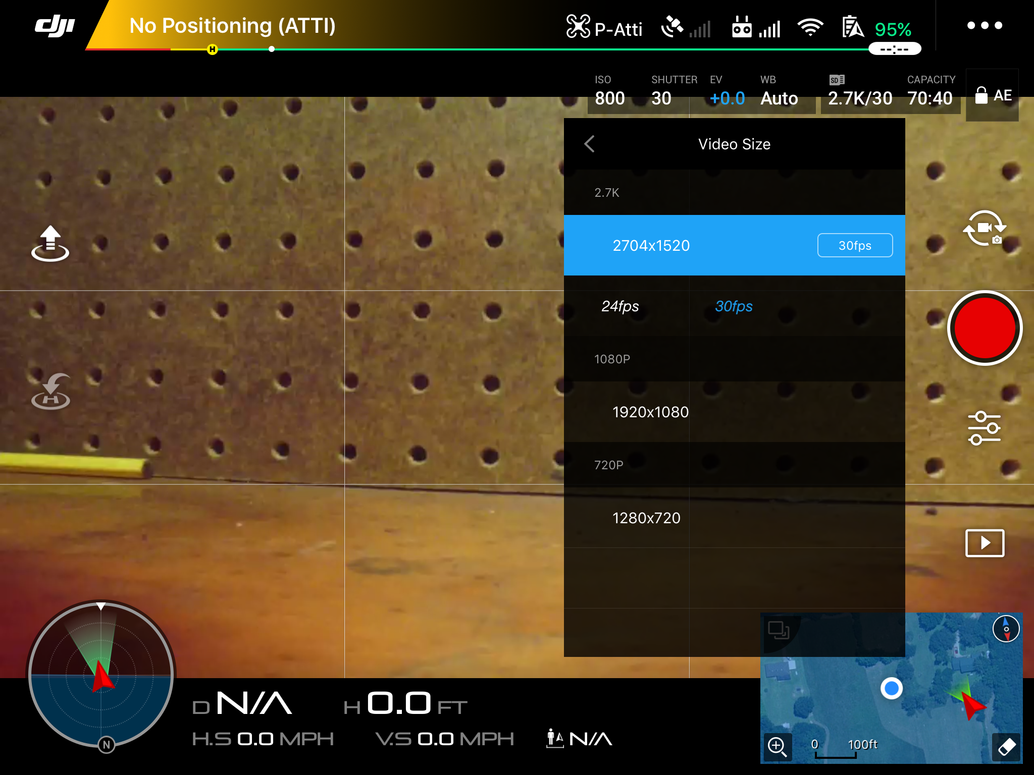

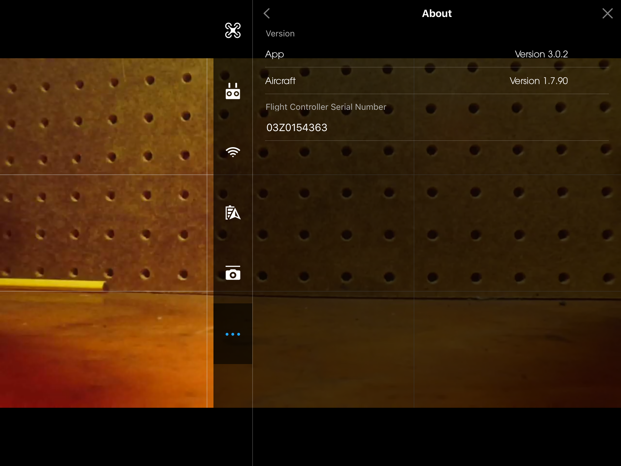

Hi Stevoe . I am on the latest FW which is 1.7.90 and on Go App 3.02 and 30FPS is there .
IMG_6772.PNG IMG_6773.PNG I'm not really sure what to tell you but it is there .

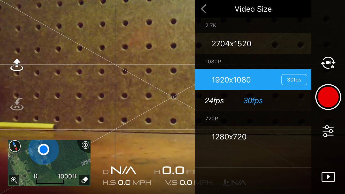

Not sure about those but here's what I have on phone now.
