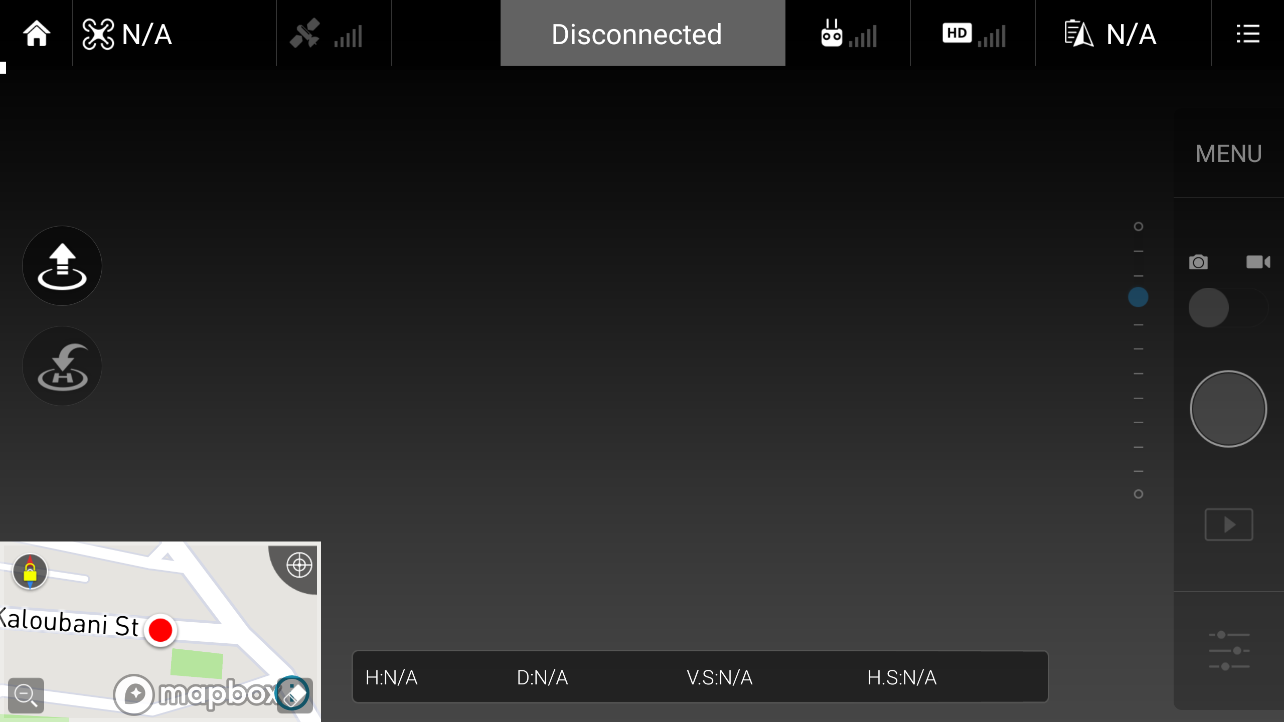

Is the drone linked to the RC? From the pictures you sent me it is not and that has to happen before you'll get anything on your phone!

As I asked, is the drone Lin led to the Remote? The lights on the the back of the drone AND the left hand light on the Remote should be gREEN. Only then can you phone connect to the App.

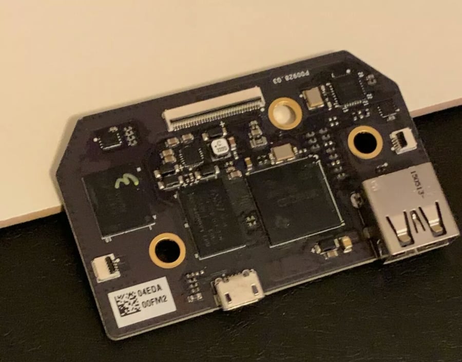

so they know what remote control USB interface board is not suitable for the old version remote control (GL300A GL300B can not be used).

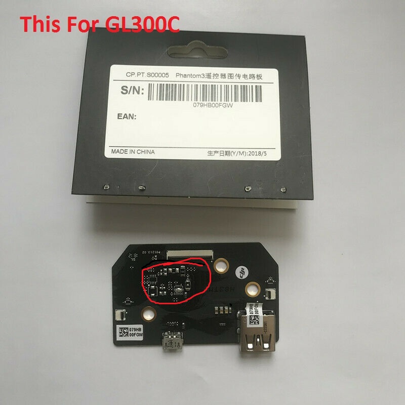

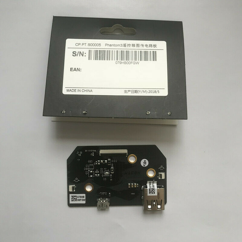

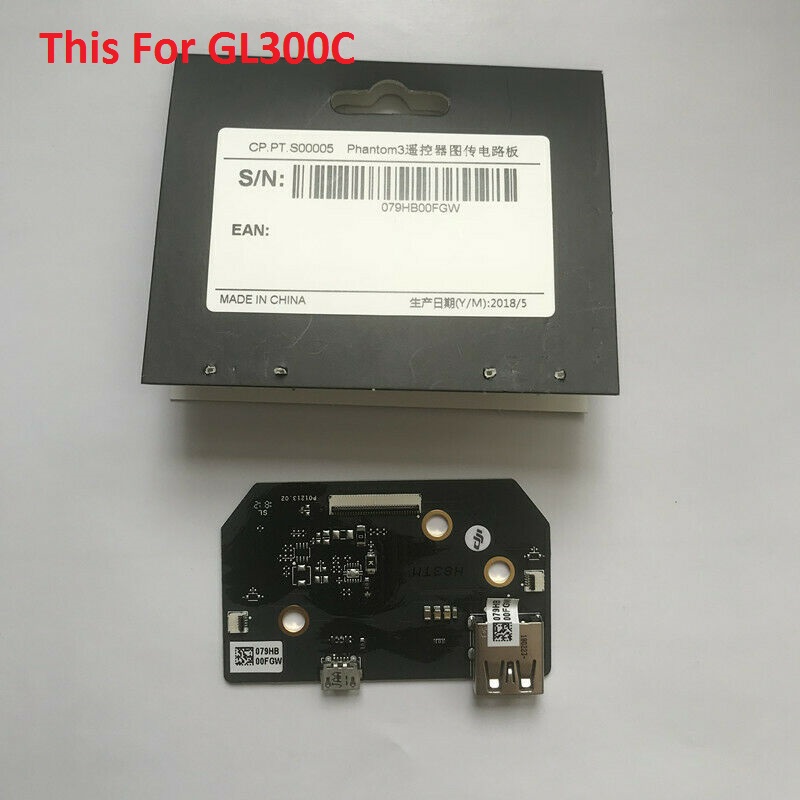

these 2 charges differ from each other! (1pic) for old version RC(a GL300A GL300B) (2pic ) for new (GL300C) no question is answer :p
As was noted by @KachemakDiver , the GL300A USB board is not compatible with the 300B or 300C remote controllers.
