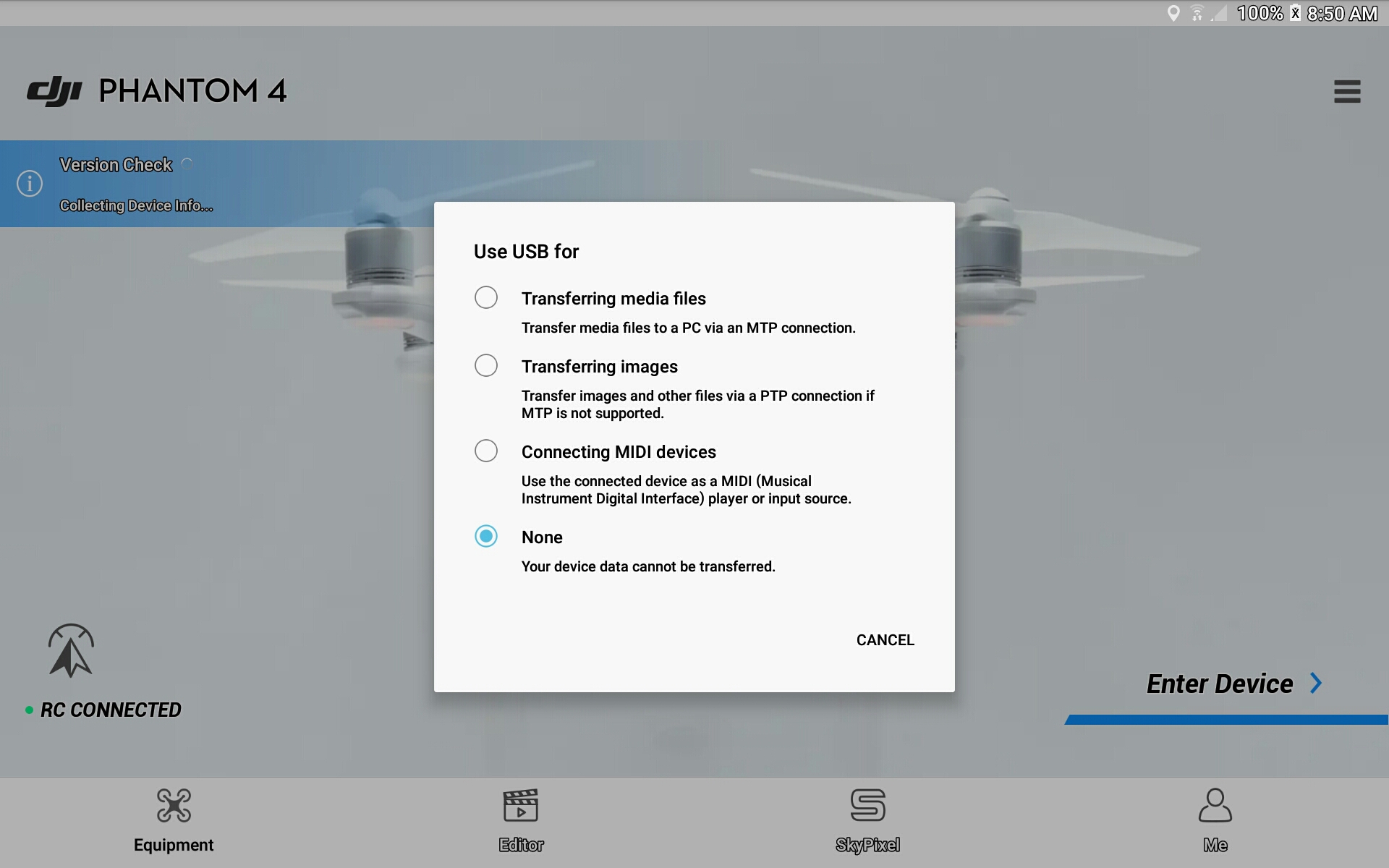

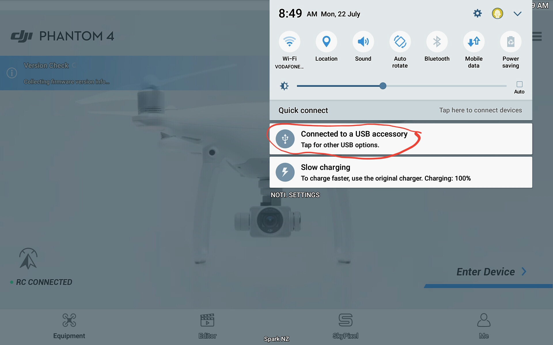

OK which phantom,are we talking p3a,,plug in usb and turn on remote,that should bring up this....this for my p4 but should be similar setting on your device,,
