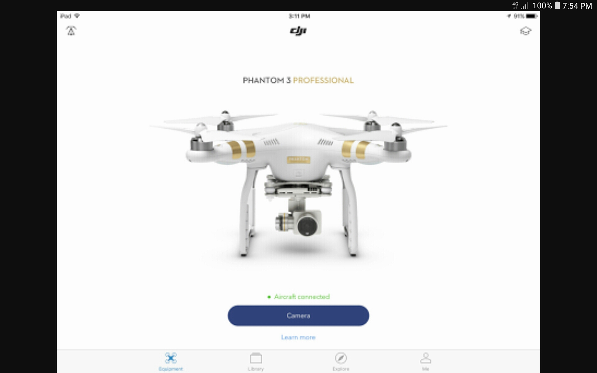

What happens when you click on professional icon when it like that,I'm not sure if wifi needs to be on because I thought p3p conect with usb instead of wifi or someone wood have jumped in and put me right,I not have pro so bit guess work for me,does back of your remote have a password 12341234 or anything about setting wifi up in quick start guide,
Yes I did it but the issue is when I plug the cable from controller to my Iphone and then Dji Go app didn’t show “enter Camera View”

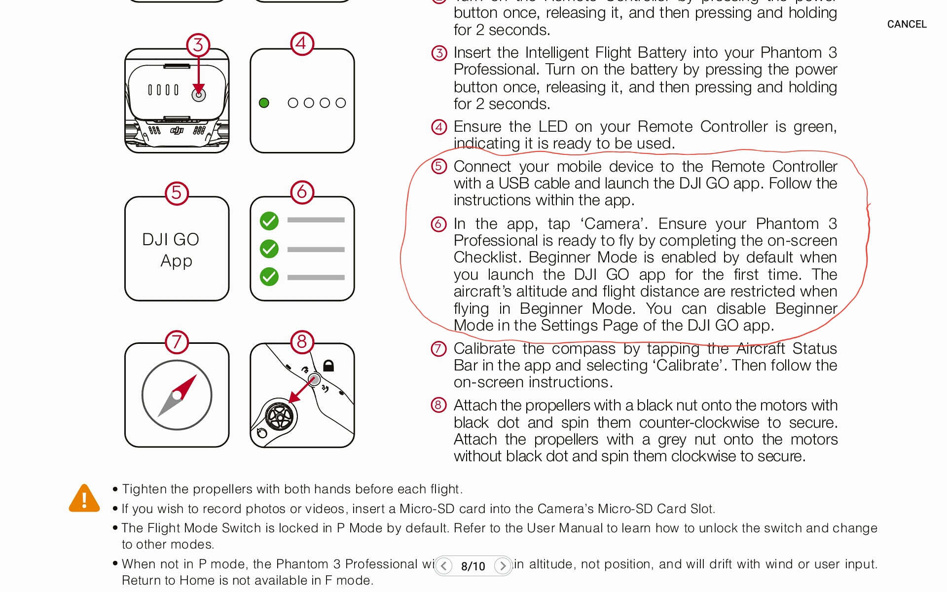

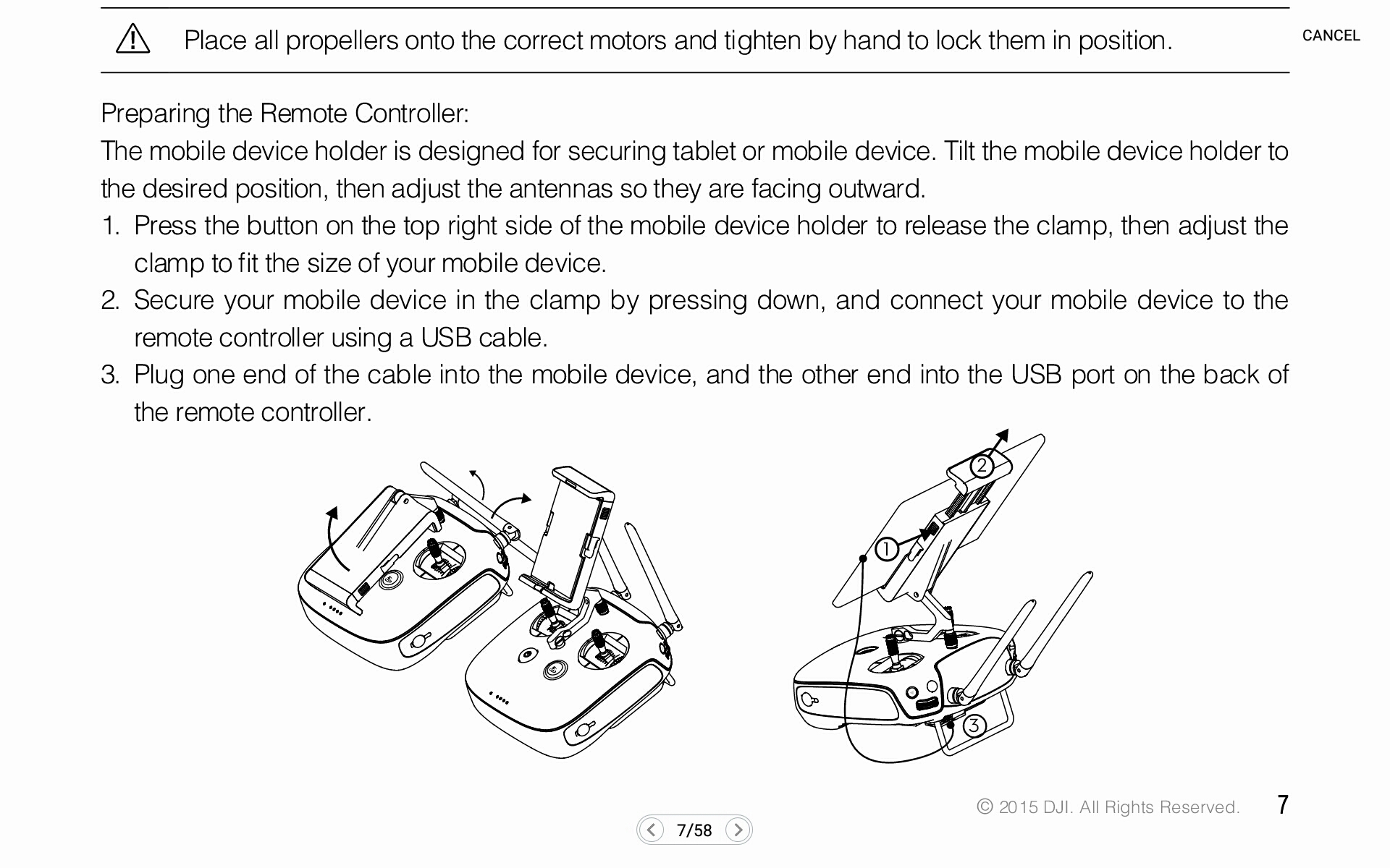

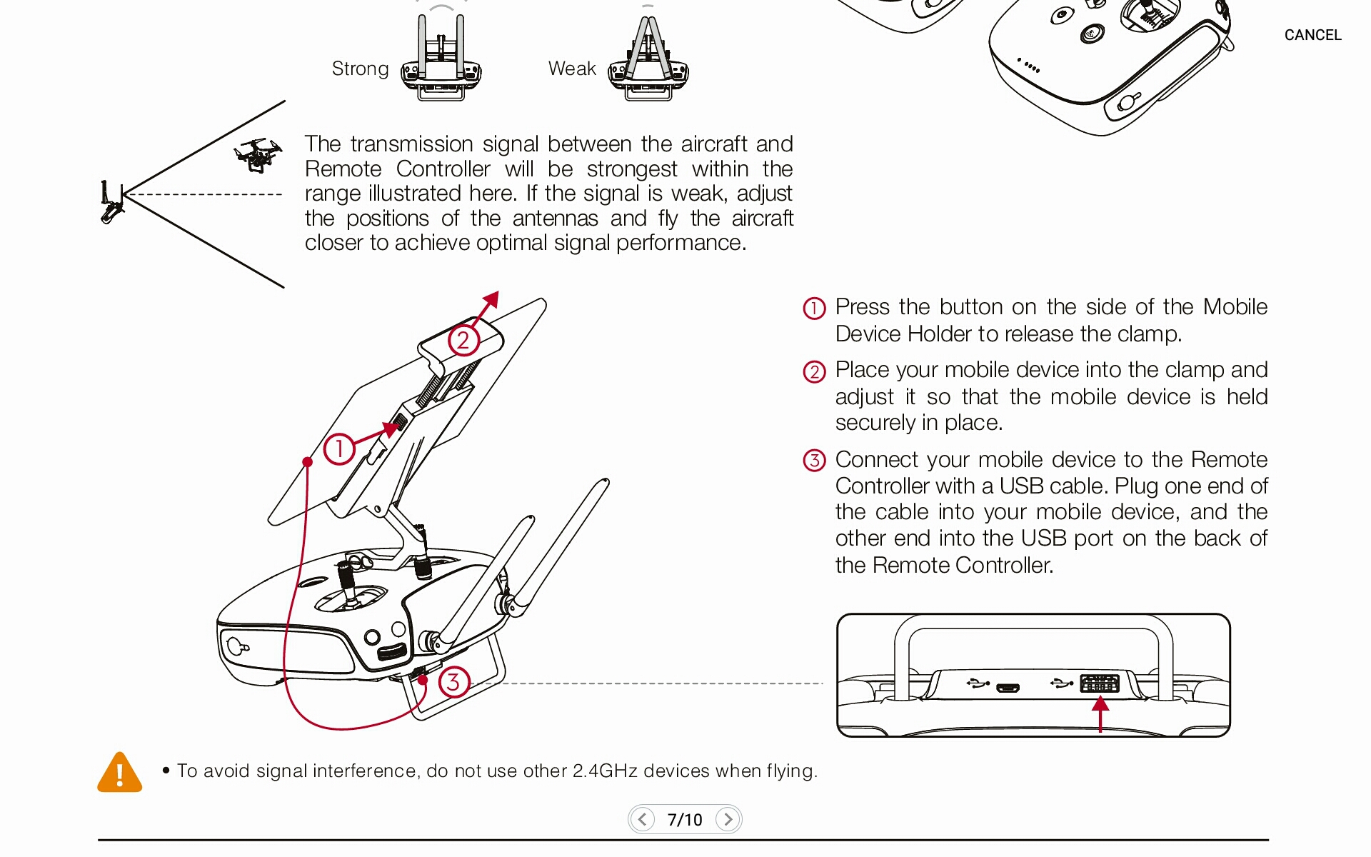

OK was just looking at guide,mayby try delete and reinstall djigo if possible,,I go have a search and see what come up

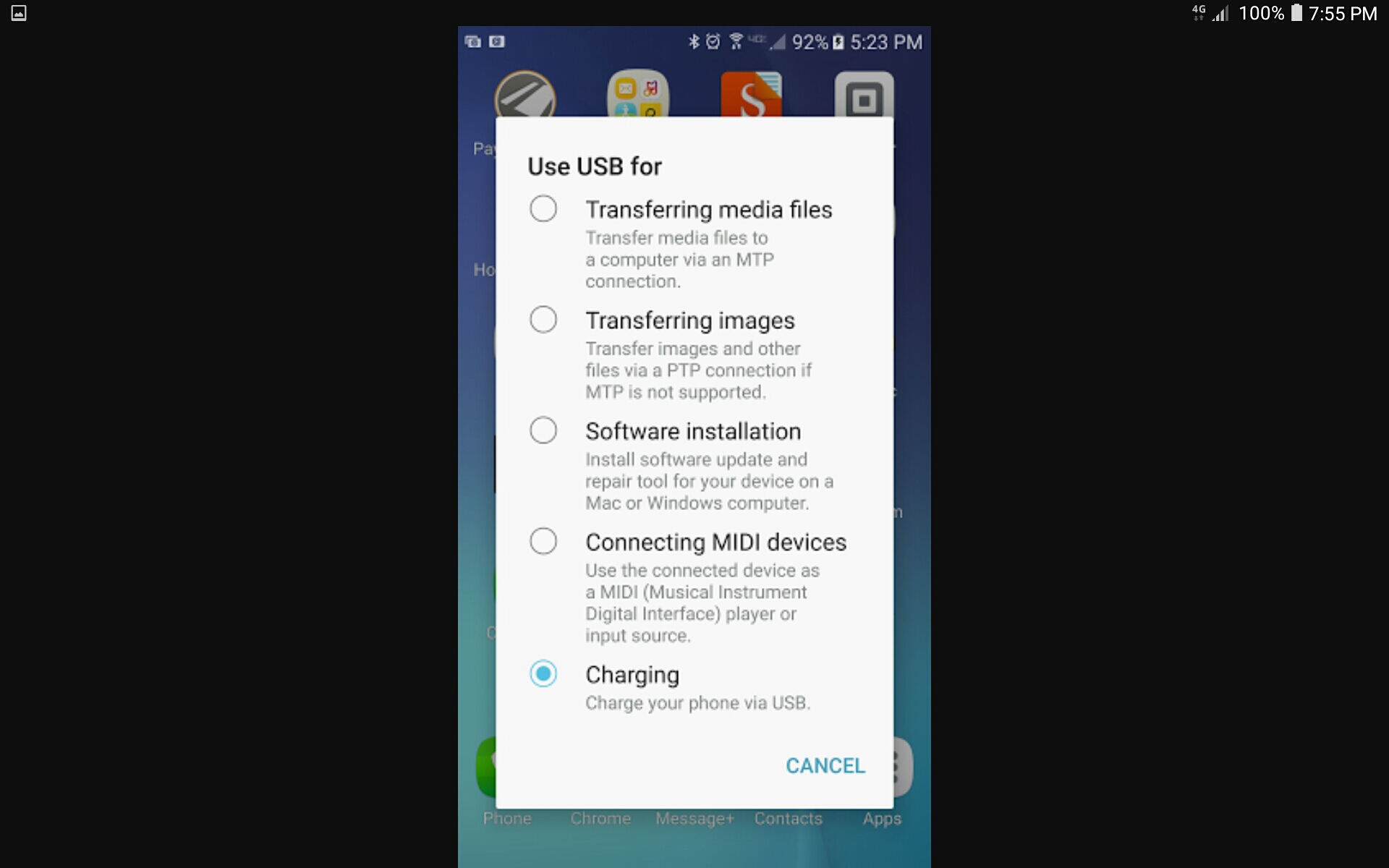

Um yes we look for blue conect colour,have look at your device settings like bottom pic,,these were from some posts I just read with same issue,,still searching

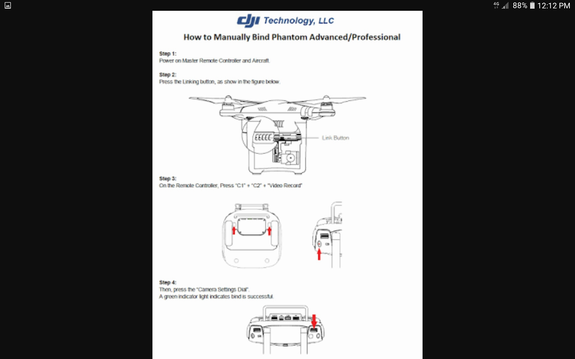

,,what colour remote lights ? Has drone got green light on link button
Hope you can zoom on this a bit ,sorry for bad pic
,drone should star beeping with link light flashing u till pressed with pen or paper clip then light should turn green on remote and drone
Hope you can zoom on this a bit ,sorry for bad picView attachment 93939,drone should star beeping with link light flashing u till pressed with pen or paper clip then light should turn green on remote and drone
Oh yes I did it and my drone has connected with controller but the issue is the controller cannot connect with Dji Go . Actually, the usb from controller is not working as well (it never happened before)

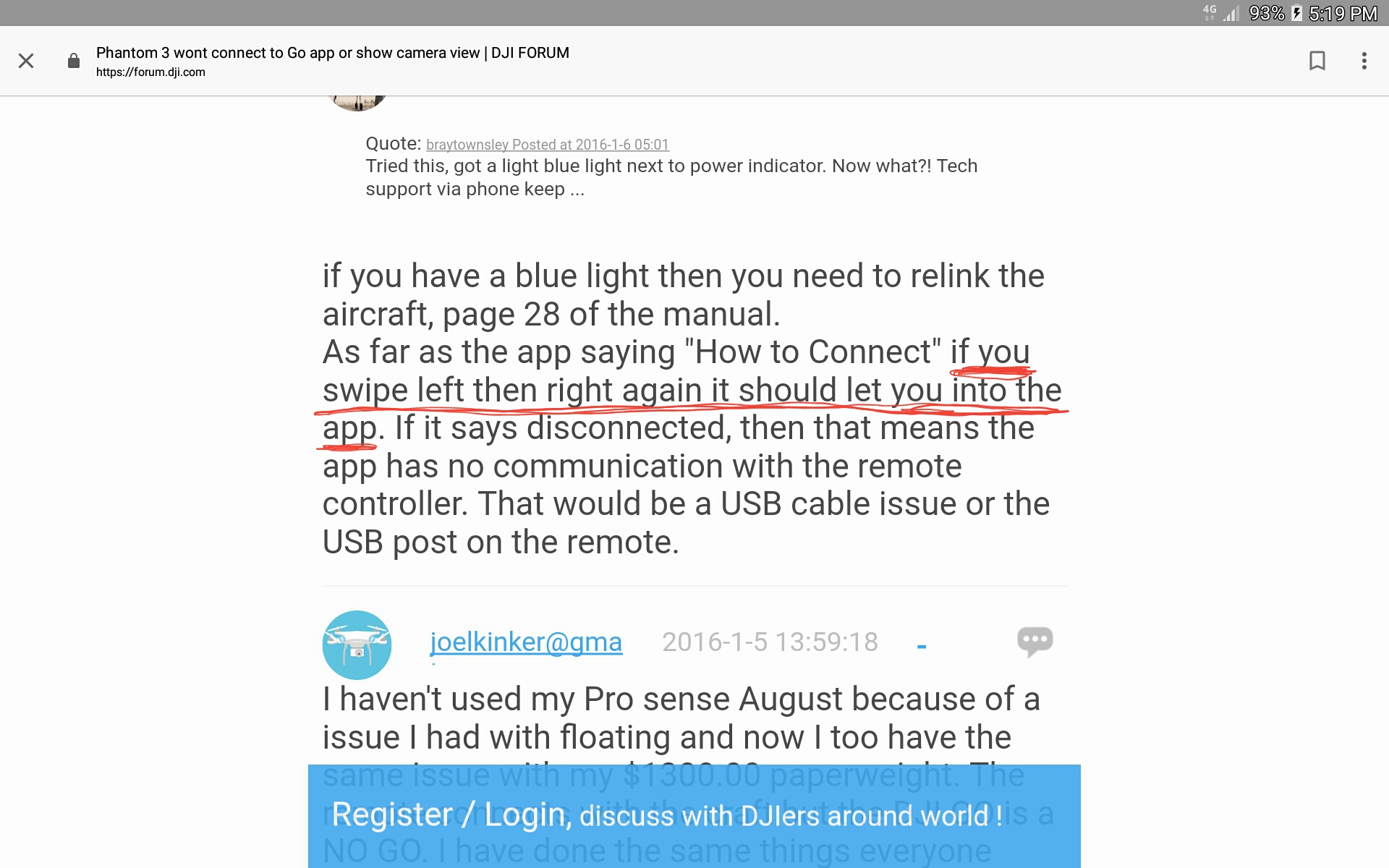

Try this method of camera connection
Try this method of camera connection View attachment 93944

Done all the Developer options and tried all tbe usb connections but still shows
oly connection to p3a controller is 'charging' not connected a a device!
