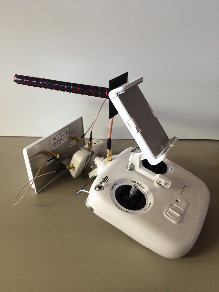

Ok back to this morning flight. made 3 flights nothing great not even close. temperature was 85 f and humidity was 55%. the best I was able to get was 4842 ft out worth than yesterday which the humidity was 40 %. Cut flight time down to 14 minutes, I landed with 6 % left on one flight. very little wind if any.
Why are you losing wi-fi but still having control?
With the small antenna but not with the CCP's.
When are you going to quit fooling around and just do this with your set up?[emoji41]
It's been tested and tried and true, after that you can put boosters on it but you're going to need a battery mod

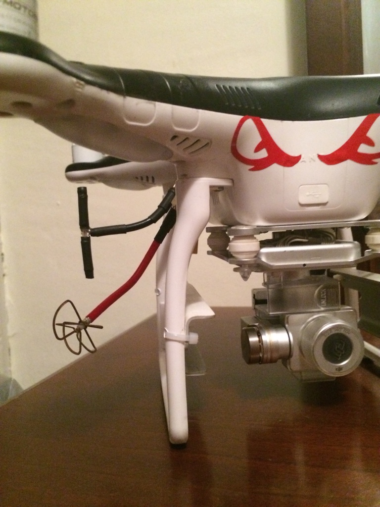

I sent my coil in for a tune up and have some parts coming for the panel's. ;) I also did mod the R/C board on the drone and put a mushroom on it. The dipole you got from Tony if I remember correctly. I may need a friend do a flame paint job on the case.:cool:

Yeah Mark pics!!! Very interested in seeing this!
