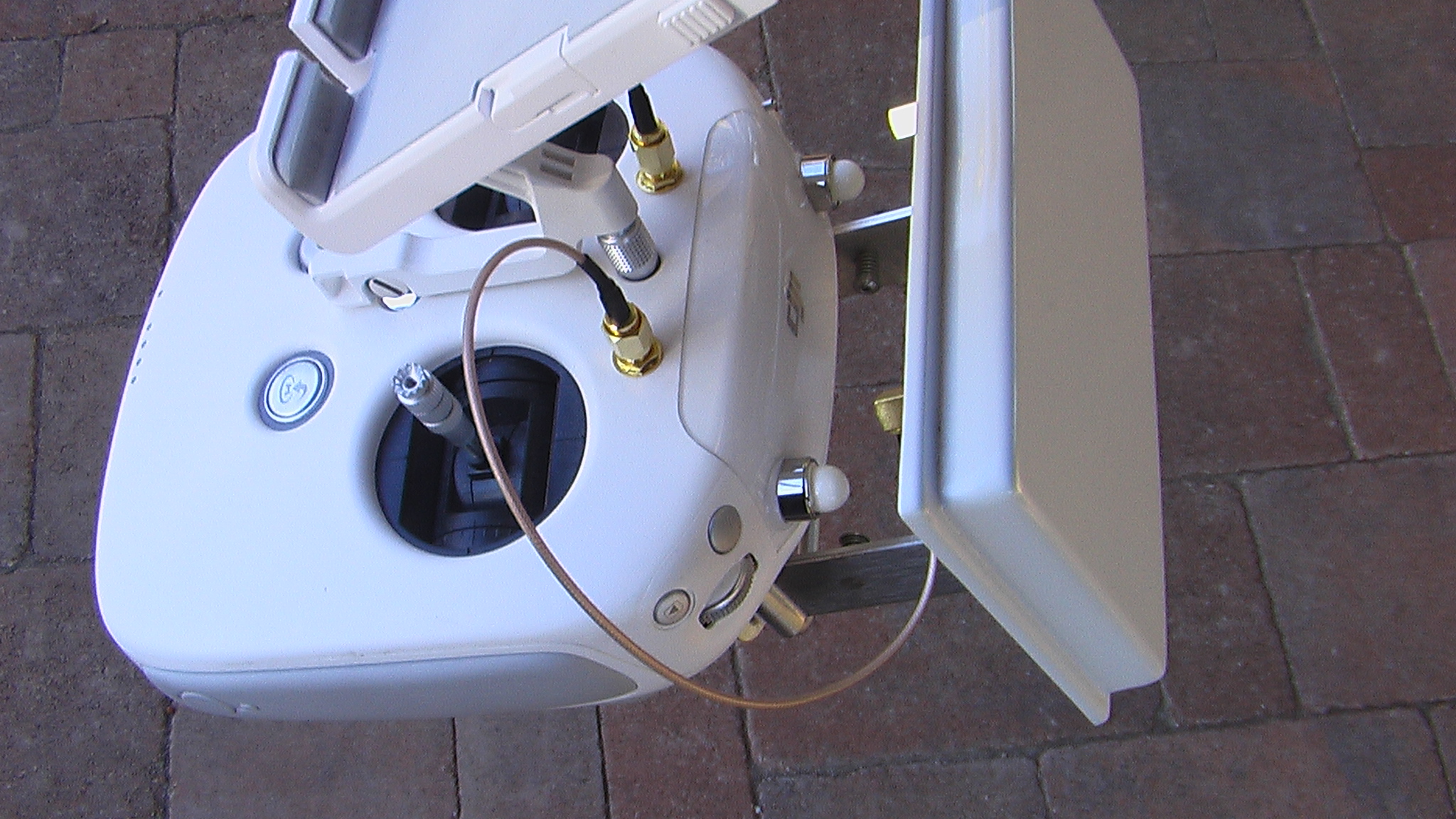

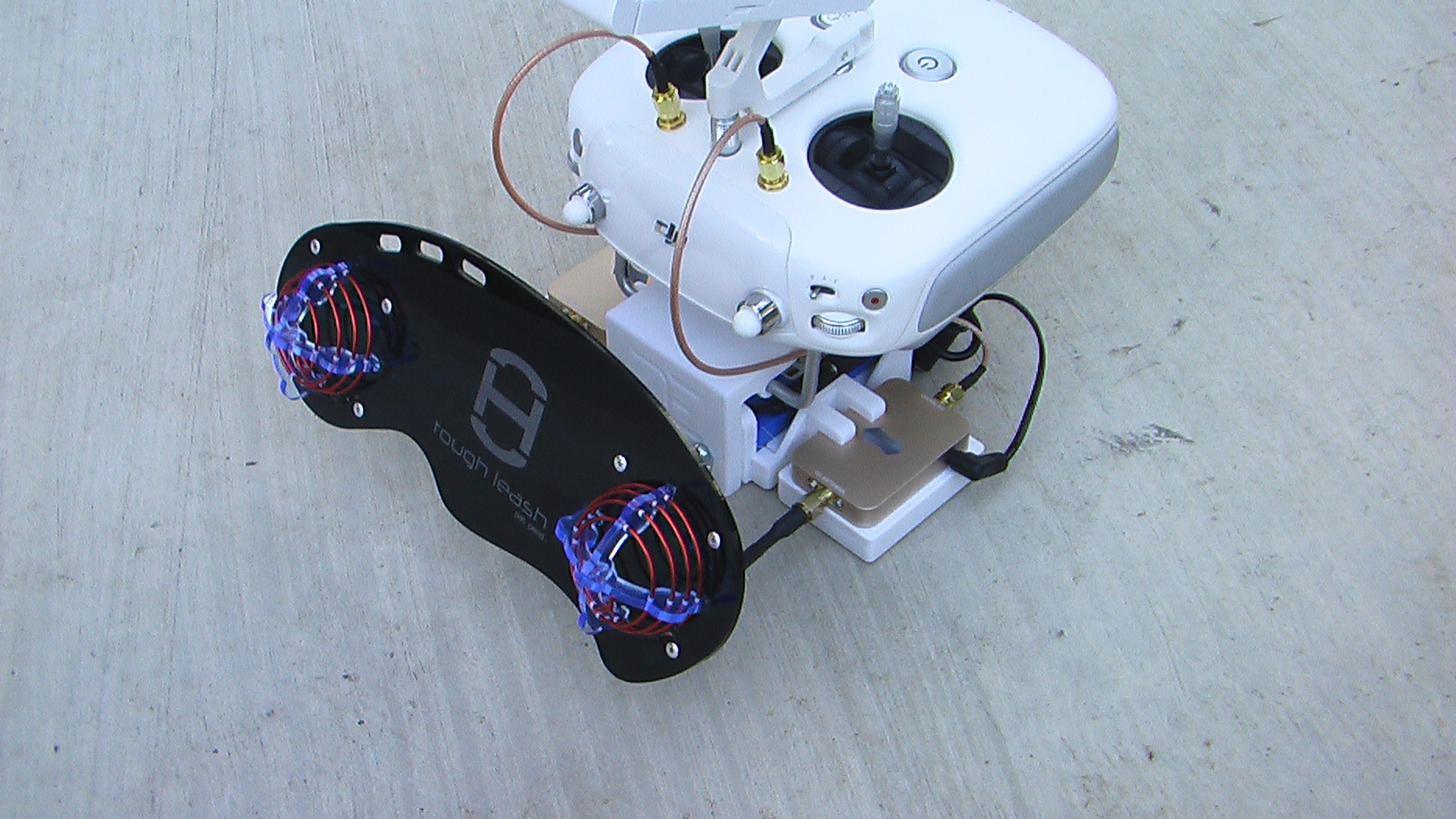

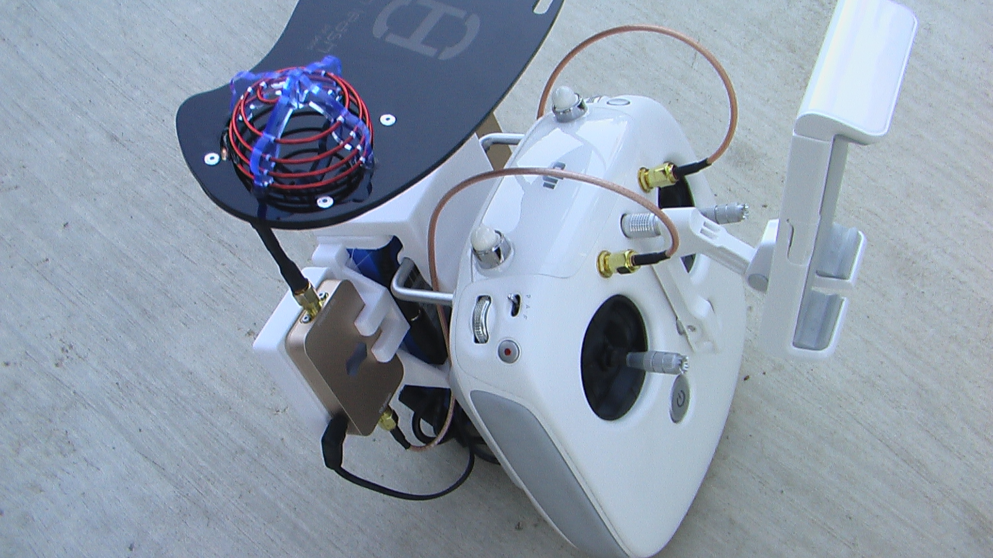

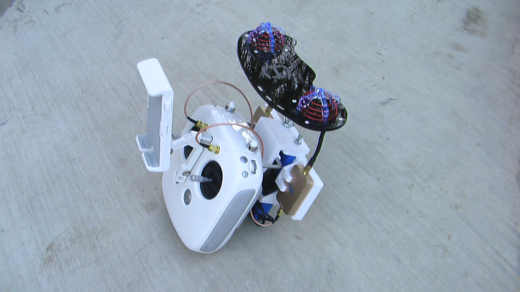

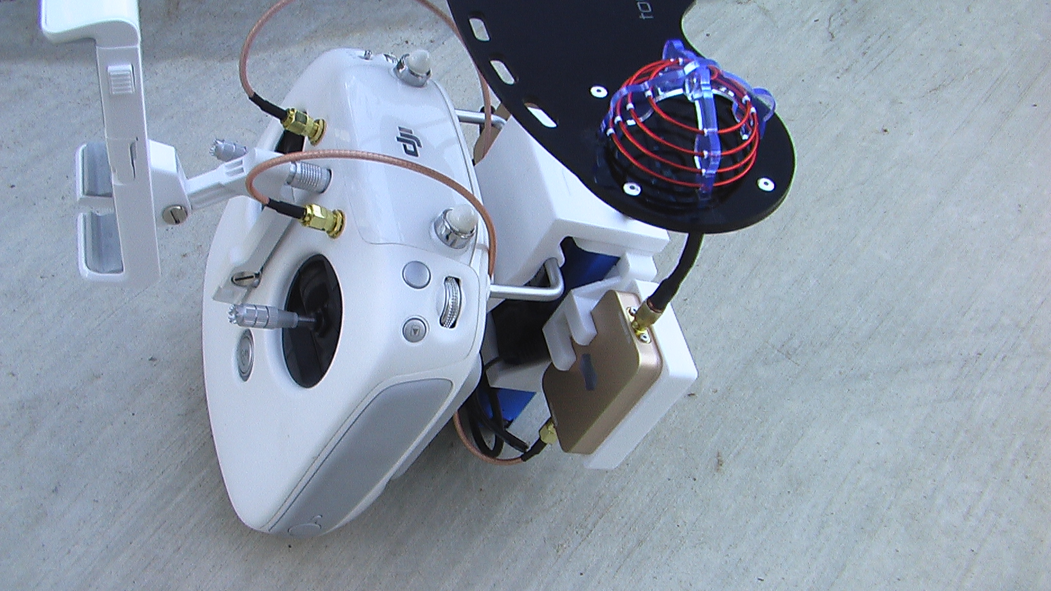

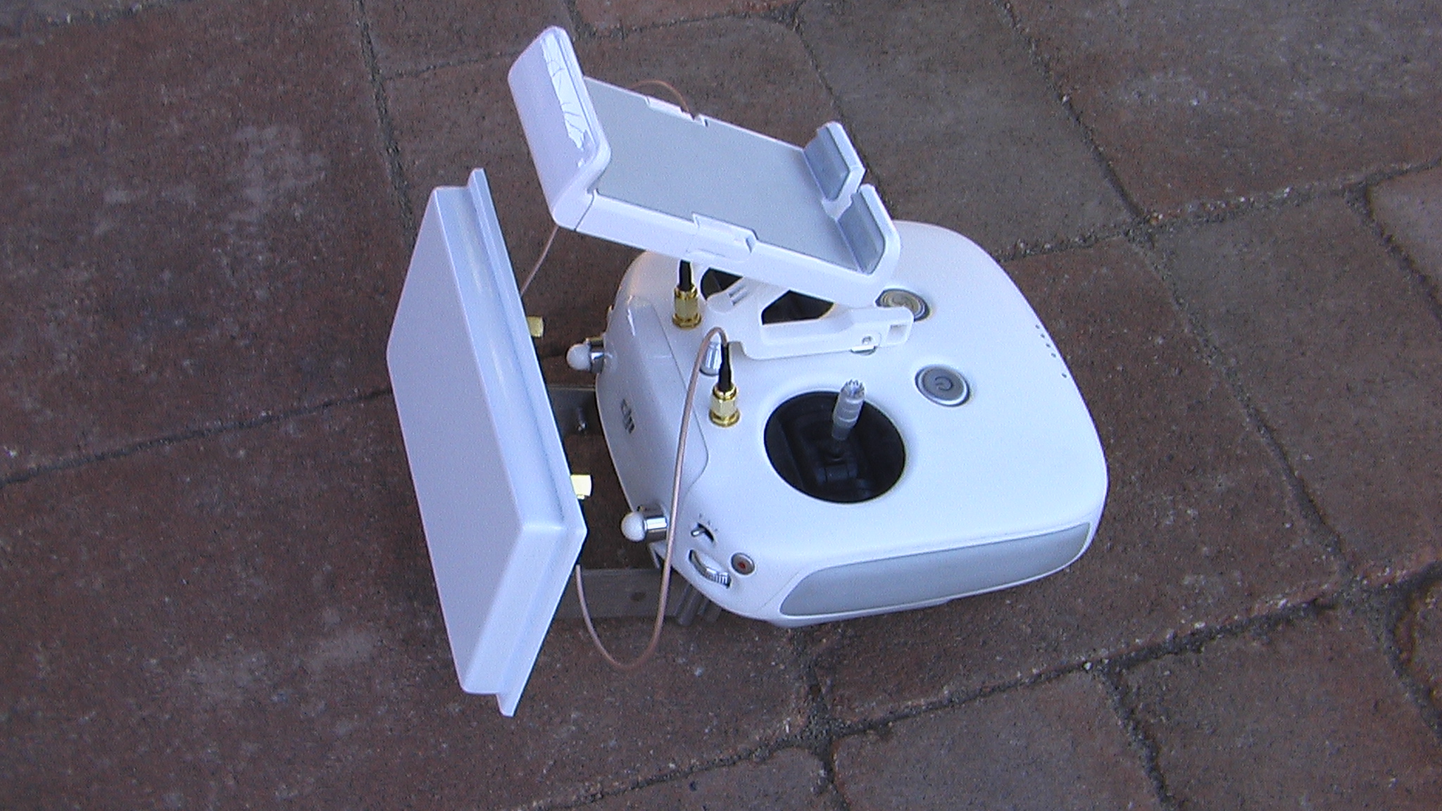

I received my RexUav boosted setup today. Only took a few minutes to assembly and it popped right onto my TX without any problems. Here's some pics of it with the DBS antenna non-boosted then a few pics with the Rex antenna & boosters. Also one thing that cool is when you want to run your DBS antenna with the boosters the DBS mount clears the RexUav booster holder no problem. Will take a pic of that so you guys can see it if you want to run boosters with the DBS antenna. Now I just need some time to test out both antennas with and without boosters to see which works best for my area.

Thank you for confirming the DBS antenna and mount system will work with the Rex bracket. I have both coming and thought this was a nice clean setup but I don't have the parts yet so I was not sure both brackets would fit at the same time.
I finally got some more pics of the DBS antenna mounted with the Rex booster mount tray . Fits perfectly with it. Overall this is very nice setup for the money. Will be testing over the weekend.
