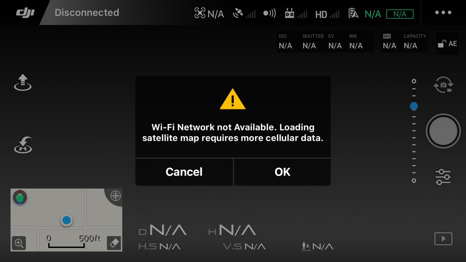

I have an iPhone 7 Plus, and for some reason I can’t get the DJI go software to connect with my phantom. I used to be able to troubleshoot, as I worked in a technical capacity in broadcast television my entire adult life. Three traumatic brain injuries have left me less able to troubleshoot.
Can anyone please tell me the best route to take to take to troubleshoot the connection issue with my phone? I have Verizon, and twice now I’ve been in locations that should’ve allowed a strong GPS signal, but the error message I received stated there’s not a strong enough gps signal to connect.

The app opens up just fine, and I’m able to play around with various settings. I’ve had this same message with my iPhone at a friend’s house, outside in the wide open air, with plenty of Verizon cell service on the phone, including a strong signal for the gps.
Right now I’m at my home, getting the same error message. I have at least 3 bars LTE, and I’ve previously flown successfully using my iPad Pro (from sitting on my back porch) for several hours.

Haven't had that pop up before, short of deleting and reinstalling the app, do you have GPS turned on to provide your location? If you go into settings, click on Privacy and make sure Location services is enabled.
I fly 99% of the time without any cellular coverage and fly with both the Go app and Litchi with no problems with either maps loading.
Try loading the map area of where you will be flying before leaving the house. Load it while connected to your home WIFI. Pan around all the ground you'll be flying and zoom in to get a clear map picture.
