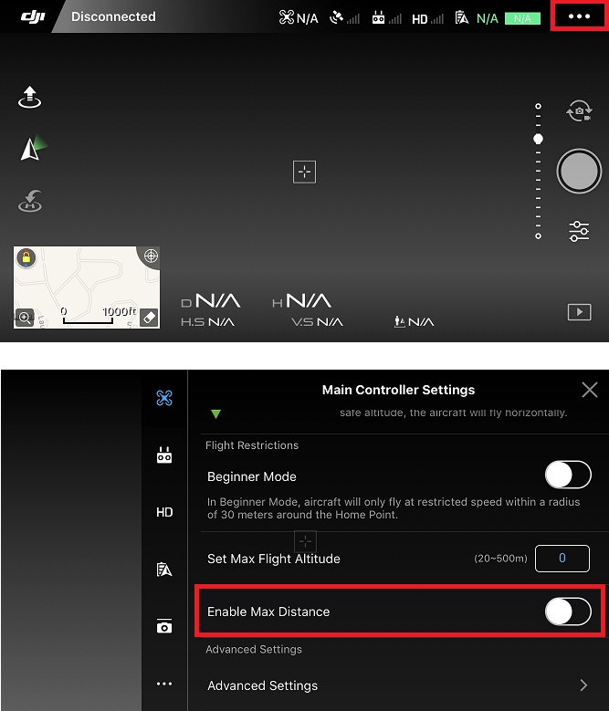

Did you disable the max distance setting here in DJI GO?

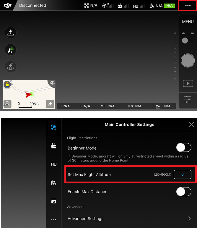

Is your max altitude set about 30 here in DJI GO?
Note: Your P4 needs to be connect to DJI GO when making these changes.

I had the "you’ve reached your maximum altitude” message and made the change noted in last image in thread #9 "Set max flight altitude" I set it 150.
