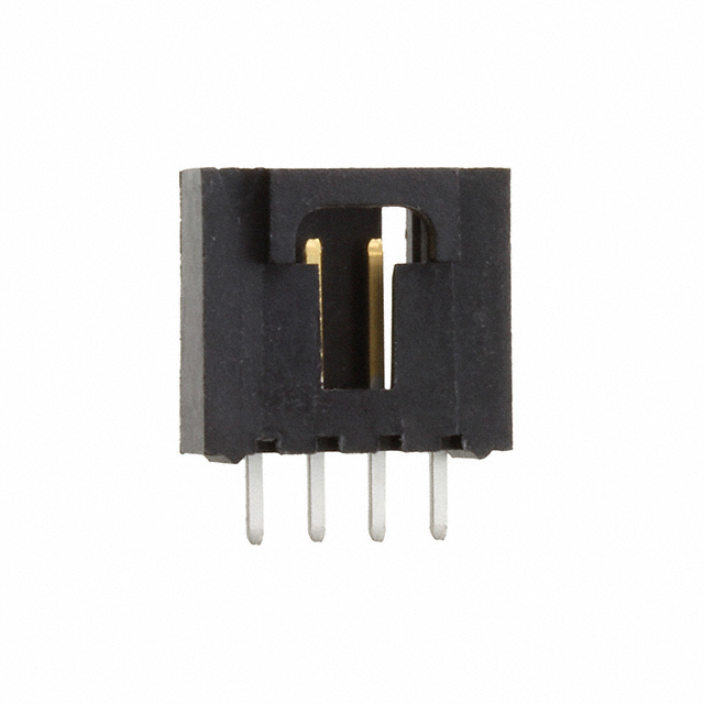

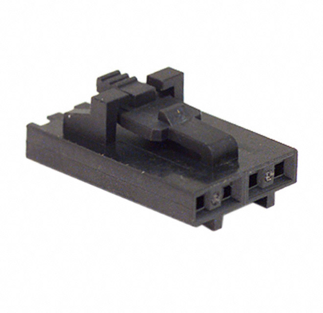

22 pcs 4 pin 2.54 mm Connector Latch Secures Female Housing
MOLEX 4-Pin 2520 2.54mm Female crimp with LOCK Connector View attachment 39659
MOLEX 4-Pin 2520 2.54mm Female crimp with LOCK Connector View attachment 39660
MOLEX 4pin 2.54mm male single row header Connector View attachment 39661
If you can find an old computer, there is a chance that they have an analogue sound cable that plugged into the sound card inside your PC.
To install, just press on the 4 pin tabs and pull the pins out. Just make sure you have them in the right order when you install onto the GPS pins
I did the mod and it fits beautifully. I still don't know why DJI didn't get the proper connectors in the first place.
