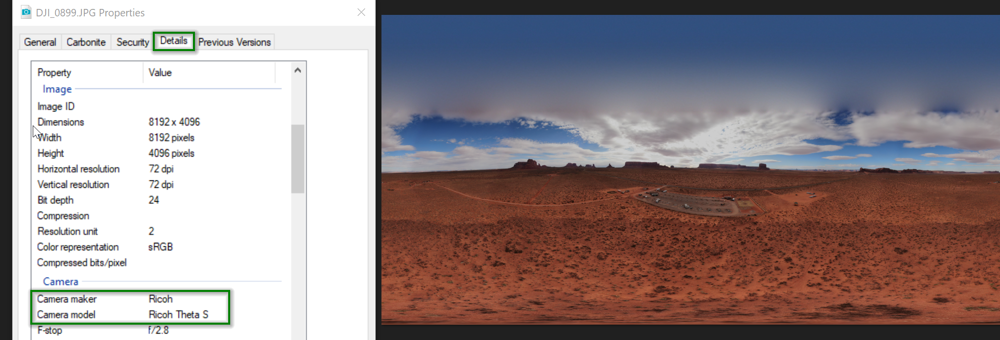

I have made spherical photos with my M2Z many times, and posted them on Kuula.com for free to share with others, using the Kuula viewer in any browser. However, I have to change the photo metadata, camera mfg to Ricoh, and camera model to "Ricoh Theta S", using Windows Explorer to edit this metadata. Just right click the file, click properties at the bottom.
That said, I have unsuccessfully posted any of my spherical photos on Google Maps, even though I tried, and followed their directions. It's really hard to find directions using a PC, I'm not sure they exist. But with android phones I found directions to upload a .jpg file that's a spherical, which resides on the phone. But when I did that by transferring my PC spherical image to my phone, and uploaded it to Google Maps per their instructions, it didn't work. I'm not sure why, even though the same file works with Kuula.com, and it does adhere's to Google's requirement for the photo resolution to be 2:1 ratio, width to height.
Ahh. Thanks. Sort of...
I didn't really want to hear that it was impossible. Kudo's for your effort though! ;)
You saved me the time of trying the same stuff.
I'm speculating that Google only wants original pics from a phone they can trace, using only their phone app. Or something like that.
