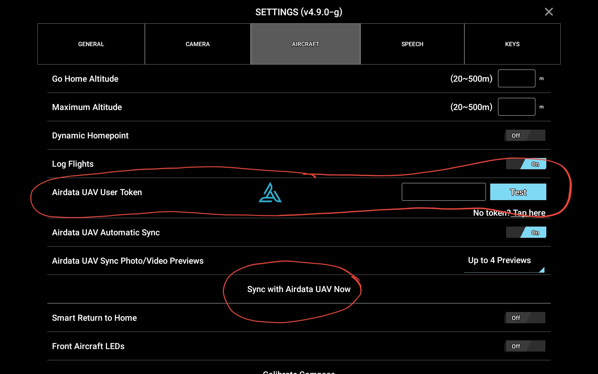

Litchi flights at airdata ,Google it it come up,,might need to create a account but is free ,,might just come up ""log in"" this is all I do when fly litchi app,,no dji don't store cause 3rd party app.....in litchi app that's why they have the token ,it let's your download flights ,,it's another version on syncing flights that's all

Here's screenshot

Those flight data reviews are useless, IMO. If you want to see real data, you must use Airdata or Keep a record of all of your .txt or .csv logs yourself and learn how decode and read them. That is the way to really see what you want.;)
