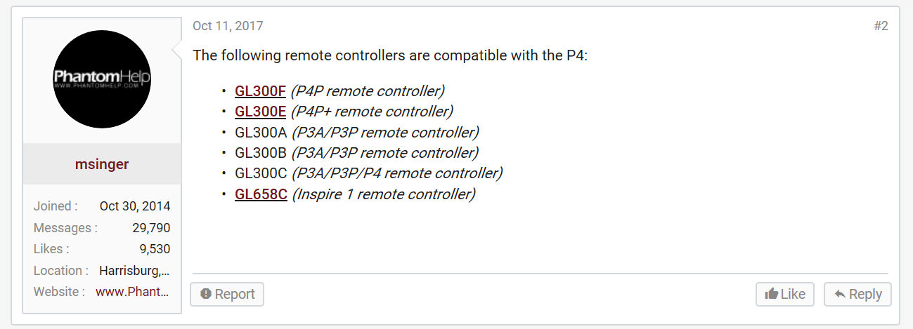

I was afraid of that but did see this post that said it was compatible, and I did try the advanced settings, change to Phantoms 4, the link. Was hoping someone on here was able to do it and would respond.
Yes some post I was just reading got me confused,but yes that how it done in settings so you must be doing it right,,have you tryed clicking on any other craft and tryed relinking,mayby a manual link is needed without the app,
