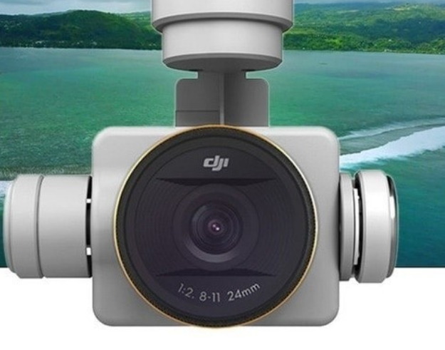

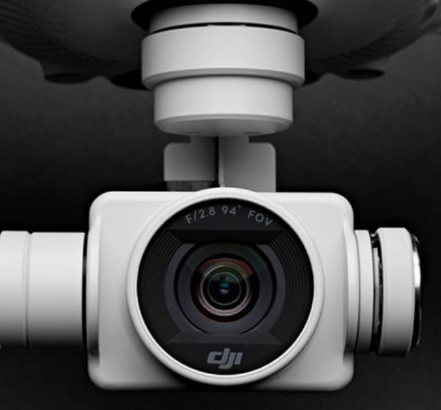

Mar 9, 2020
136
43
70
The top photo is from a P4Pro or advanced. The bottom is a P4 Standard.

But we should mention that the above picture of the P4Pro/Advanced camera has a filter attached which makes it look that much bigger.

The important part is the writing. DJI on bottom is P4 standard.
DJI on top, with
1: 2.8-11 24mm on bottom is Pro/advanced.
then the Pro has the extra side avoidance sensors that the advanced does not have.
