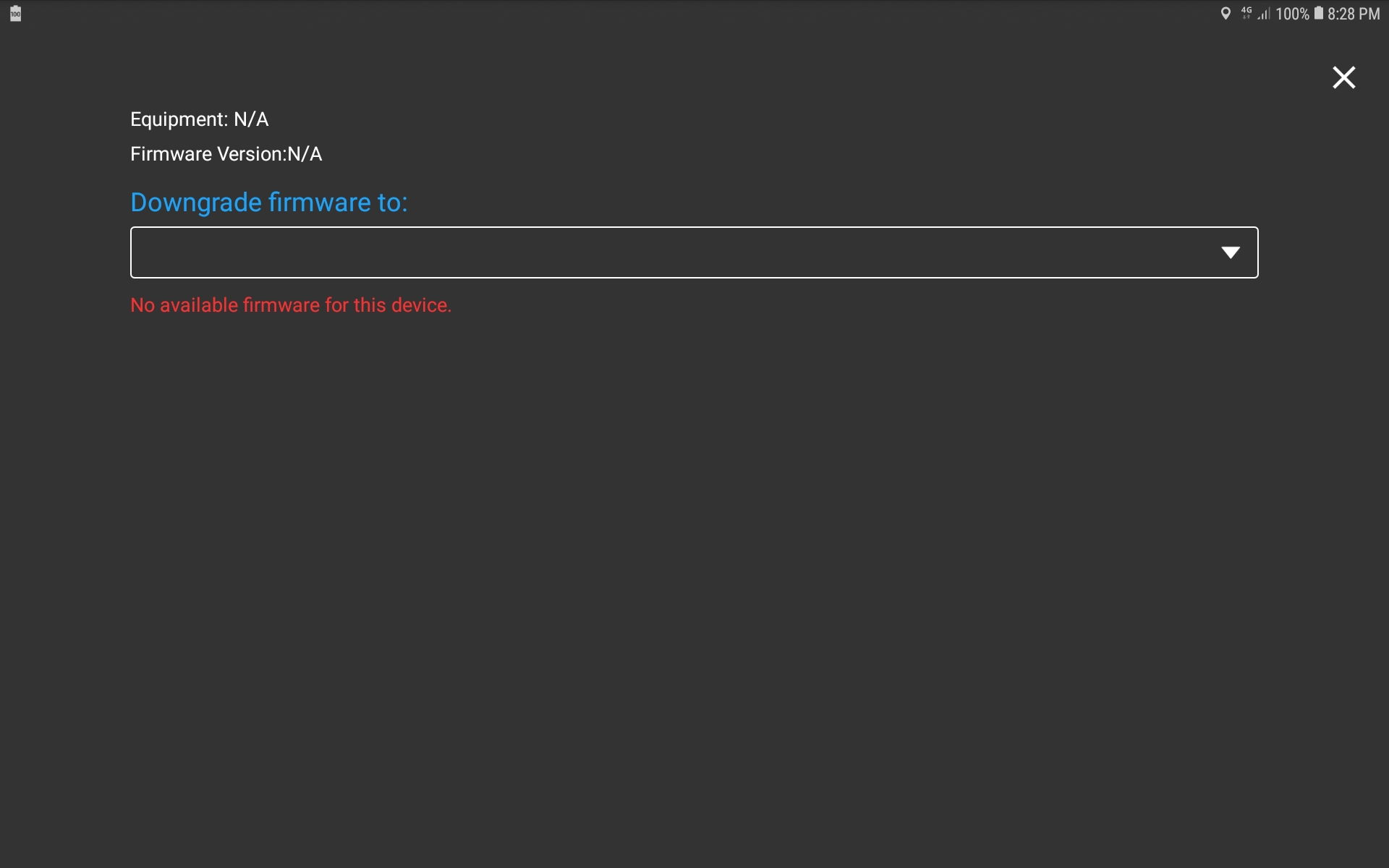

Hi All,
just upgraded to the latest firmware and have lost maps. The map download button does not do anything when pressed. I have wifi. Seems a lot of people have had this issue and appears I need to go back to a later controller version. I believe I need v 1.3.6.0 Would anyone have a .bin file of it, or know where I can download it? I need to install through the sd card hence the .bin file. DJI support is useless.
cheers Steve

Have you checked on home page 3 black lines ,top right,,press and hold,,sometimes it will give a version
I just fixed that issue, I have the plus as well and it's a pain. It's not firmware it's the dji go app. Let me know if you still have the issue and I'll help you out
I just looked at a plus screen that I have. The screen is not at all the same as the regular go4app screen. The plus screen model of course is an Android animal and therefore not something that I enjoy. This map issue is not firmware related and downgrading isn’t going to help.

Thanks for your offer to help, this is driving me nuts to get sorted. The Go4 app version is 4.2.6. let me know what you did
steve
Roblo,
The controller version is 01.04.03.00. its after updating to this latest version that the maps don’t work.

Your app version is older than the one in my controller.
Do you see in the map box in the lower left a cream colored screen with a red or blue dot?
Starz , my app version is the latest version for the plus screen it’s v 4.2.6.
Yes the map box is there, but no map. On the main screen, there is a map download button next to the settings button. That button clicks but does nothing beyond clicking.
DJI support are bad news..... but I think everyone knows that. There WILL be a competitor to rival DJI and I’m afraid they will pay the penalty for all of their bad practices. There is more to selling an expensive product and then forgetting about support. Arrrhh!
Sorry, there is no dot in the map box of any colour.
just a side story, I installed litchi on the controller last night and it shows maps. It uses map box as well. So, the problem seems to be in the go4 app Update.
App version on mine shows 4.3.14
I‘m thinking mine is a more recent version than yours. I’m still not convinced this is firmware related.
Main screen, click on enter device.
You should then have a map box in lower left.
No dot? Then click the “dji” letters in the upper left. Should go back to main screen.
Click on enter device again. Still no dot? Do this a few times and see if a dot shows up.
