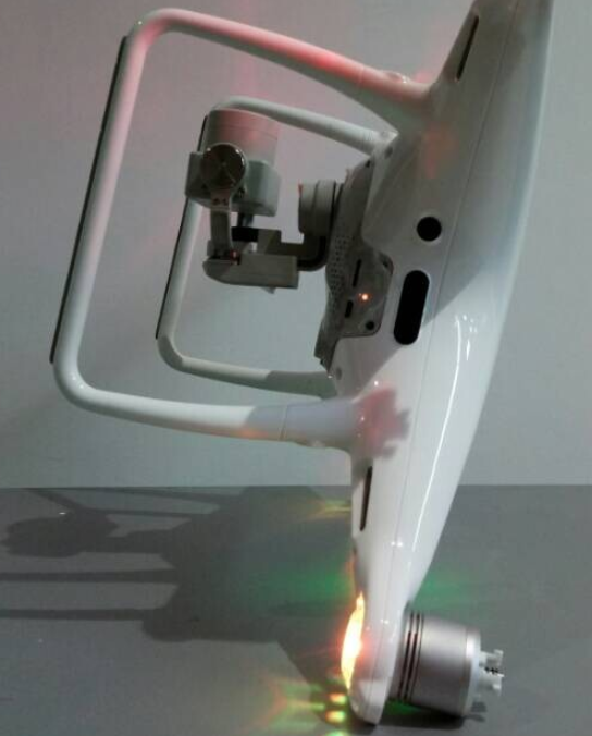

Have you tried a gimbal calibration with the AC in this position
Tried calibrating standing on the back part of the landing gear and back 2 rotors similar to this but not as far back as this one. Here it seems you are holding it in place. Will give this a try and let you know thanks a lot!

A DJI moderator on the DJI forum recommended giving the gimbal turret (where it connects to the body of the AC) a bit of a twist in the opposite direction while the AC is on, that is turning the turret slowly until you feel resistance then turning it a tiny bit further. You may have to do this a few times to make the correction

Thanks a lot I actually did this while it was off and it would help a little. Scared doing it whilst on to not to damage the motors but it works a little for me whilst turned off but have to do it every 2nd or 3rd power cycle. Managed to do my shoot today but was a little challenging. Not a permanent fix of course but a decent workaround considering I didn’t even have picture before sending in my gimbal for refurbishment (not by dji of course)
tried this helped a little but not 100% afterwards. I found twisting the gimbal a little more than its sort of limit helped for a couple power cycles but it was never straight just a little more centered. Seems to me like a few screws loose somewhere (literally)
