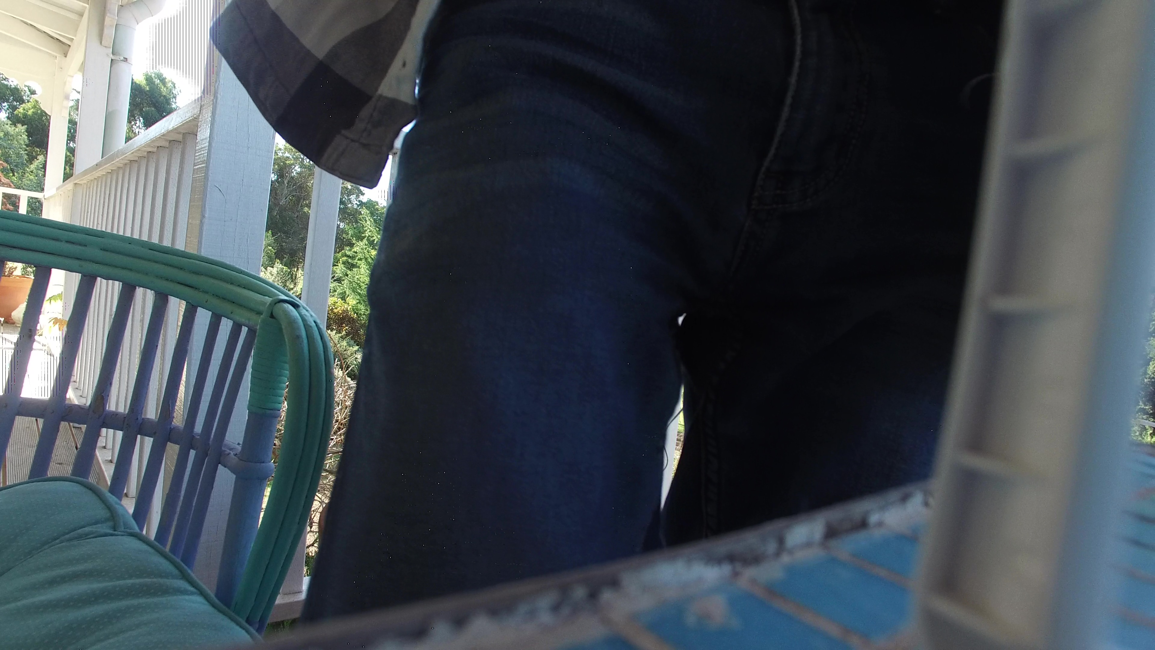

I have been trying to get rid of speckly video images on my recored video. You can see white specks on the blue background in the frame grab. It looks like snow in the video. FPV to screen is not affected. The video recording sometimes stops after a minute or so
I swapped the camera gimbal for another P3P and the fault followed the cmera/ gimbal
Next I bought a replacement gimbal PCB on ebay ex China. Although it was listed as new I could see by the cut fan wires, it had beed harvested from a donor gimbal.
The replacement gimbal showed the same speckled video, but introduced even more faults such as no video link, and the gimbal positioning would not calibrate
I have now installed the original board, a requested a refund on the replacement board. Now Im back to the original faults plus I noticed the fan has failed. I did carefully sesolder the wires.
Any suggestions on how to solve this
I'm assuming by "gimbal pcb" you mean Gimbal Top Board. The issue you have is with either Camera Sensor Board or Flat Film Cable.
