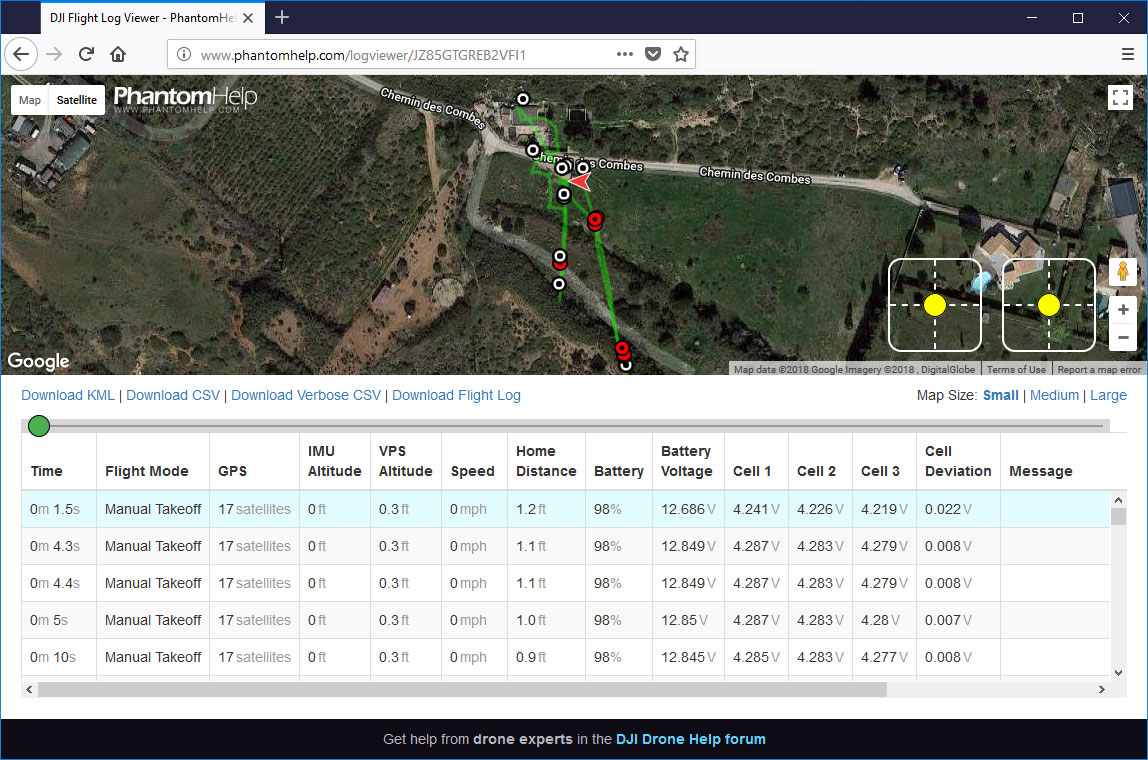

My free online flight log viewer can be used to process and view flight log data from DJI TXT flight logs from any version of DJI Fly. These flight logs are automatically created on your mobile device when flying. After retrieving the TXT flight log from your mobile device and uploading it here, the data will be displayed in a format like this:
Here are some things you’ll be able to do after uploading your flight log:
  • View the flight path of your drone on a Google map
  • View important flight details in the table below the map
  • Drag the slider at the top of the table to replay your flight
  • See the location of the remote controller sticks at the bottom, right corner of the map
  • Download a KML file to view your flight path in Google Earth
  • Download CSV files that contain more columns of flight data
  • Share your flight log with other people

I'm working on building a free log viewer to view data from Phantom 3 TXT flight logs. My idea is to build a tool that will summarize the flight log and allow all data to be downloaded in CSV format for those who want to do detailed research and/or import the data into another application.
Here's an example of what I have so far:
www.PhantomHelp.com/LogViewer
What do you think of this format? Would what you change and/or add?

For one-off data (e.g. the battery serial), I plan to show it in an area that gives a summary of the run. Some other things you'll see there are flight time, battery % start/end, lowest battery voltage, top speed, etc.

For example if one sees how cell voltages are varying with time on a chart, one can easily visualize. Reading numbers from a tabular data is ok but it doesn't give immediate impact.
I do quite a bit of long range flying and thus would appreciate RC signal strength and distance from Home point.
I'm going to add the distance to the table. I don't think the TXT flight log contains the RC signal strength (unless I missed it).
How about coloring the deviations red if > 0.1V like at 8:08 etc?
The data in the table will be color coded. I also plan to color code the lines in the Google Earth map to show areas of low battery voltage (and perhaps other scenarios).
