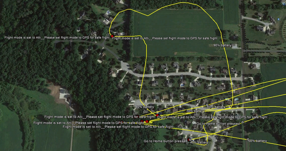

c) Current google map displays each message point(shown above). Can these be set to disable each one, or by type?
As you can see on the file I uploaded, one of my messages has a lot of text length in it. It might be a good idea to only display icon's that are color referenced to text data below, to help stay clear of cluttering?

One way to deal with Frank's issue is to have a list of overlays with check boxes ala Google Earth it'selt - check the data elements you want to display, leave unchecked the ones' you don't. It's been a long time since I looked at the API but I think it allows for that functionality.
