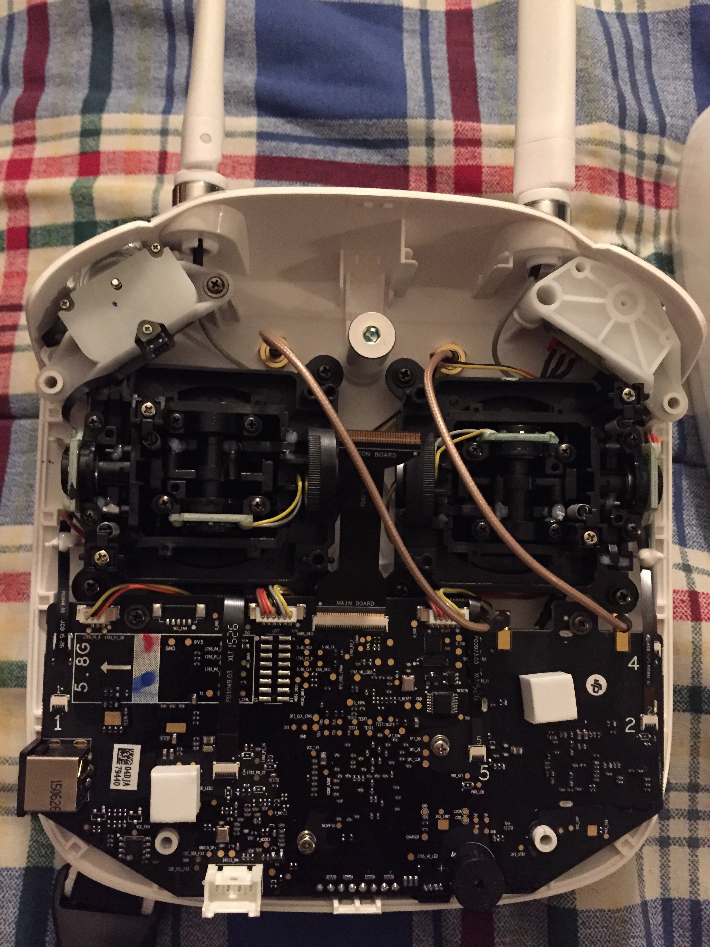

I decided to take it apart tonight. Connections looked solid.View attachment 29655
It's best to run the cables underneath the controls . With them on top they could cause some issues. Make sure ribbon cable is seated properly . Unless there's an issue with the cables themselves. Hopefully it's something simple . Have you tested it in an open area with no interferences.

I removed the old antenna's and verified all connections. I haven't done a test in an open area with the original antenna's, but will see how this now works.
