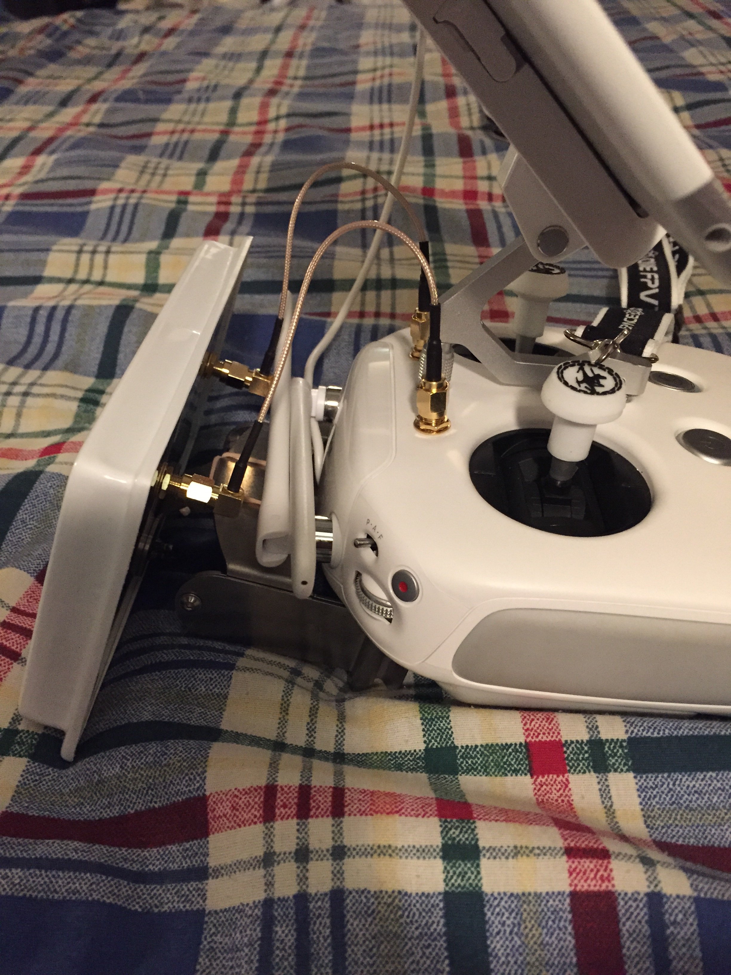

I just received my DBS today and have taken 2 flights with disappointing results. I fly a route that has trees eventually blocking my line of sight. I have reached close to a mile with the stock controller. The DBS only added a few hundred feet to that distance. I just took a night run in the opposite direction and typically get about 4000 feet on that route. I lost signal at about the same place. I have no doubt this works great in an open area with line of sight, but I'm not seeing any gains where there is blockage. is this normal or is something not right? I expected to at least double my current range under the same conditions.
I would double check all the cables and make sure everything is seated properly. Post some pics of everything I'm sure some of the experience guys can tell you what is wrong. Good luck!!
Here are the exterior connections. I left the old antennas on and just moved the cables out of the way. I'd have to take it apart to show the interior.
@DBS - sent you an email on your website last weekend - no reply - I heard others here having the same issue. Are you uber busy, not getting them, or?
I would take it apart and double check everything. Or actually before doing that take it out to an open area and do a range test. If it doesn't improve by at least double I would then take it apart and check all the connections. If something is wrong you run the risk of frying your controller. Get some other opinions maybe first but I think there's something wrong.
I'll take it apart tomorrow and check all the connections to make sure nothing came loose when putting together. It's obviously doing something or I wouldn't be getting a signal out as far as I am
I decided to take it apart tonight. Connections looked solid.
