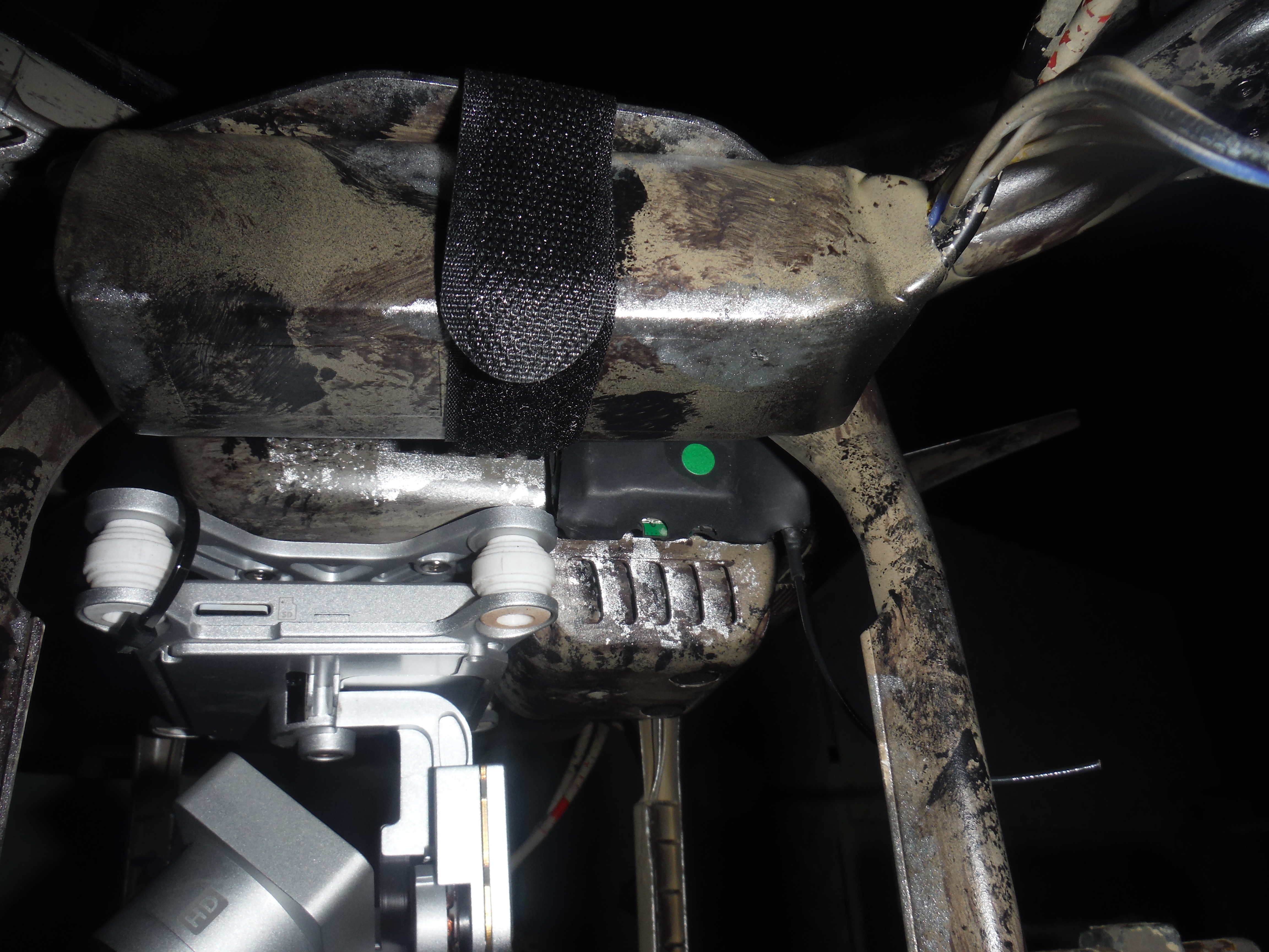

That's why I have a "Marco Polo" Velcro'd on the side. Good for 2 miles and 30 day on time. The best $200 you'll ever spend and doesn't need a cell connection which isn't available a lot of places I fly. Have used it twice on the Phantom 2 and once already on the Phantom 3! I move it to whatever bird I'm flying. I friend in Flagstaff AZ lost his P3pro in a wooded canyon and said there is no way he would have found it without the "Marco Polo".

So those batteries have replaced your single stock battery then? Is the handling different? The bird is used to one heavy battery in the middle and now has 1 on each side.

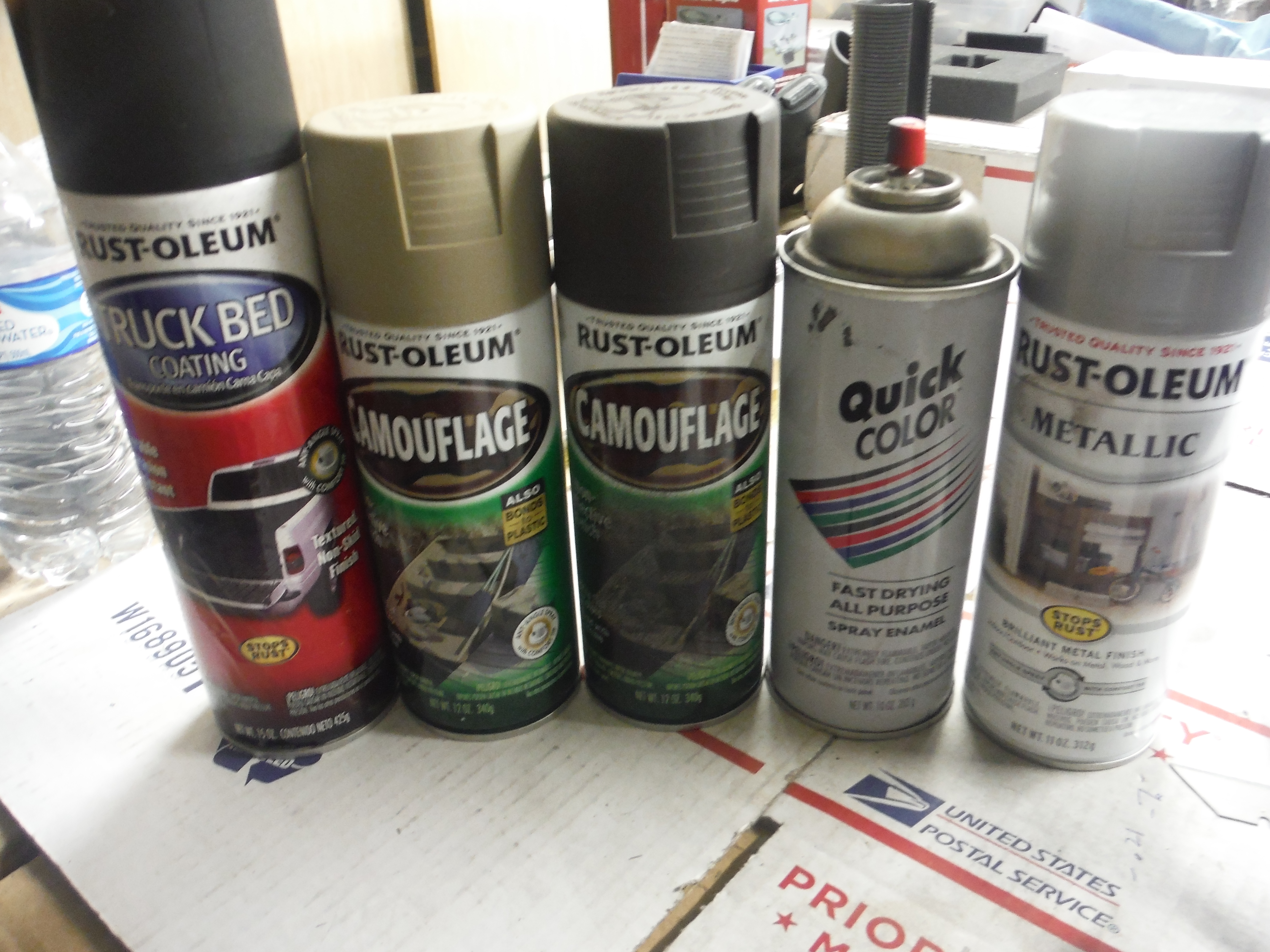

Disassembled down to shell, no parts in it. The top is spray bed liner from HD, bottom is Klylon FDE Camo then a smattering with artist brush and sponge of Klylon dark brown Camo, black and some metallic paint. Start to finish was a Saturday afternoon project. Plus I had to yank the bird side crap out and reinstall the leg antenna's.

Disassembled down to shell, no parts in it. The top is spray bed liner from HD, bottom is Klylon FDE Camo then a smattering with artist brush and sponge of Klylon dark brown Camo, black and some metallic paint. Start to finish was a Saturday afternoon project. Plus I had to yank the bird side crap out and reinstall the leg antenna's.View attachment 44994
