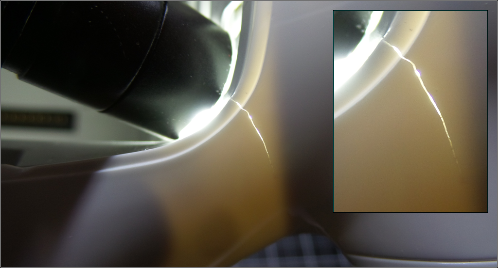

Found Another Crack @115.5hrs..
Everytime I see one of these cracks it angers me.

...John, at the risk of sounding.. like.. whatever.. Fatigue or Stress Crack Nucleation typically starts at the point of Maximum Stress & Minimum Strength (that is barring other defects i.e. Cut, Crack, Nick or HOLE).. while several other users here have suggested drilling a hole to halt the crack propagation, I again don't think its a good idea, with this material, in this area of the craft.. I realize that it is a 'Technique' used, in this case I believe it to be not applicable (BTW none of the suggestion volunteers offered a Dimension of that hole haha).. filing a claim with DJi, in this case I believe will be honored, but what will more than likely happen is you'll have to send your drone in to them at which point it'll be swapped out with a 'ReFurbished' drone.. again some don't mind that, I do... I've taken great care of my craft, I would say i've treated it like an infant, but i wouldn't send an infant 400' AGL haha.. and I don't ride the Firmware UpDate Tinkeristis Bandwagon.. I'm running the original firmware installed upon receipt and aside from this structural defect, problem free.. I made a tool of sorts out of copper wire so as to apply a malleable (vs Brittle) epoxy to the inside, to strengthen that area.. it worked on the left side, rather than further crack propagation there, it cracked on the right side.. good luck...

...John, at the risk of sounding.. like.. whatever.. Fatigue or Stress Crack Nucleation typically starts at the point of Maximum Stress & Minimum Strength.. while several other users here have suggested drilling a hole to halt the crack propagation, I again don't think its a good idea, with this material, in this area of the craft.. I realize that it is a 'Technique' used, in this case I believe it to be not applicable (BTW none of the suggestion volunteers offered a Dimension of that hole haha).. filing a claim with DJi, in this case I believe will honored, but what will more than likely happen is you'll have to send your drone in to them at which point it'll be swapped out with a 'ReFurbished' drone.. again some don't mind that, I do... I've taken great care of my craft, I would say i've treated it like an infant, but i wouldn't send an infant 400' AGL haha.. and I don't ride the Firmware UpDate Tinkeristis Bandwagon.. I'm running the original firmware installed upon receipt and aside from this structural defect, problem free.. I made a tool of sorts out of copper wire so as to apply a malleable (vs Brittle) epoxy to the inside, to strengthen that area.. it worked on the left side, rather than further crack propagation there, it cracked on the right side.. good luck...

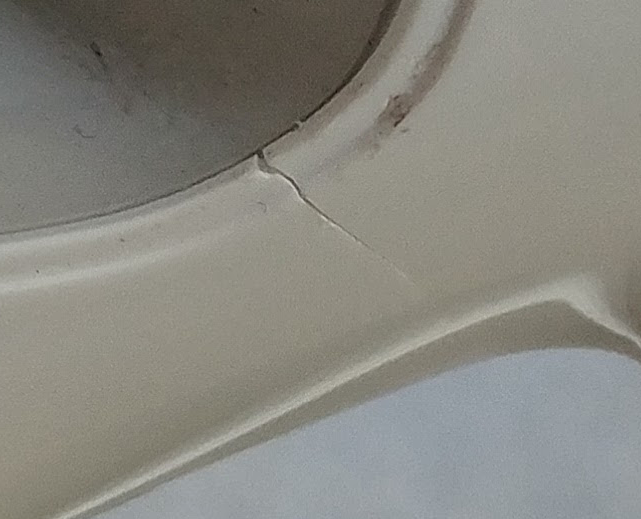

I thought I was all good and after reading this post I took a real close look, dang I found the start of one, about 1 mm is barely visible another 4 mm is almost invisible but with a little pressure it opens up. I used locktite 420 (good for plastics), it's only 5 cp in viscosity and designed for capilliary action. I put a bit on a tooth pick and touched the crack and it got sucked in, I hope it helps to limit further damage.
I suspect there are numerous Phantom owners with cracks and don't know because they don't inspect. I check mine after every day of flying in a dark room and a flashlight. I inspect the shell around the motors. Now I will also be looking at the battery bay. Sucks having to look for the flaws but, I feel like I have too because the flaws are historic. Of course, after caring for it in a similar fashion as lllDaemon I found a crack in January, sent it in and receive a refurbished replacement.

stop drilling a small hole at the very end of the crack prevents it from cracking further. it is the preferred method, even on large aircraft this is the norm !
A crack will propagate from a phenomenon called "stress concentration." Drilling a hole at the end of the crack spreads the stress along the circular area so it prevents the crack from spreading.
This is a tried and true practice. Same procedure is used in the aviation industry in aluminum. At least, until the affected area can be replaced.

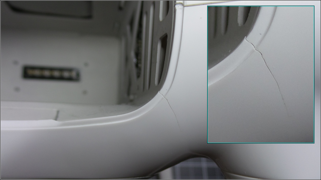

...Found Another Crack @115.5hrs.., emanating from battery bay, right-side, almost the exact same spot as
left side, I now believe this to be a weakness in the structural design rather than a defect in the plastic...

Thanks for posting this Deamon, I do inspections every flight and I never saw anything before this post showed me were to look. My P4 cracks is exactly on the opposite side of Daemons', it is so fine that it was almost invisible as the crack had not opened up at all, about 1/4 inch long and only when I applied pressure could I see how far this crack was going. In my last post I said that I was going to try locktite 420. I did, I let sit over night and took it out just now for 2 batteries, total of 72,000 feet in about 38 minutes of flight. The fuselage as remained bonded thus so far so good. The type of locktite I used was designed for this type of crack that is not separated as the 420 is for penetrating due to capillary action. This will not work if the crack is open. Not knowing the type of plastic of P4 this was just an educated guess that this type of bonding could work. Like many of you my craft has been well taken care of and I don't what to send it in in case I would get a refurbished unit as this bird has been real good so far. I expect that this crack will resurface and then there is the other side that may start. Maybe next time a small hole may help, just make sure that when you drill you are just after the crack ends, a small bit hand held should work, I have a kit for cleaning welding tips that has various brill bits that you chuck in a pen like tool, I would not use a power tool.
