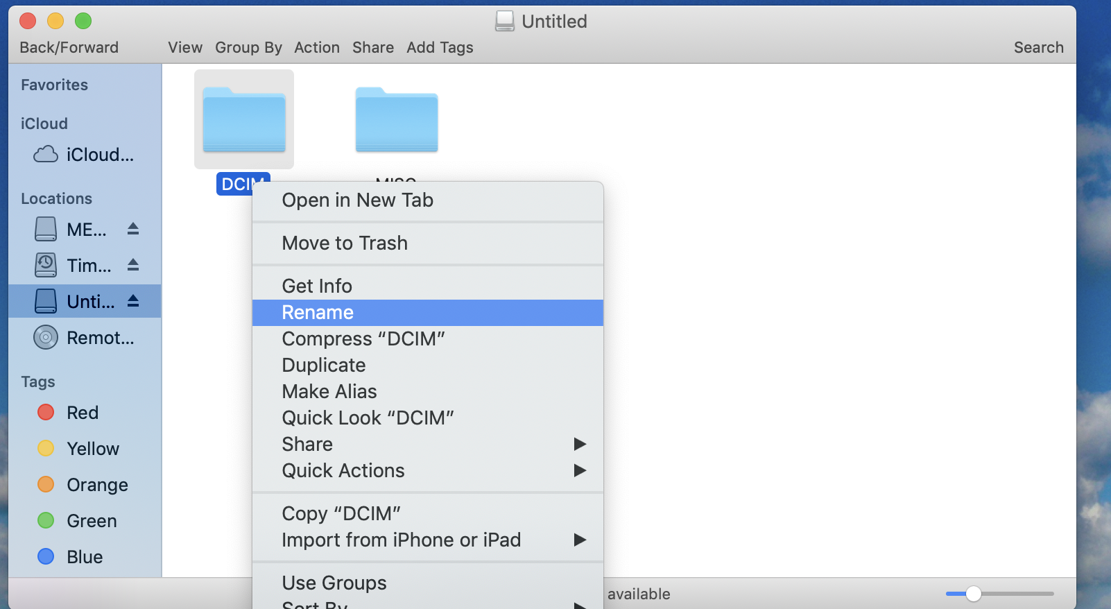

I always have took the DCIM folder to my desk top then reformat the card in the go app.
On my iMac when I read the card I just rename it then pull
it on to my screen ,let it transfer then eject it.
before I fly again I always just reformat the card then.

dirkclod, Pardon me let’s see if I am following you.
You rename the card? or the DCIM file? or the video files?
Then you drag it to your desktop (screen) and after it transfers to the screen you eject the card and reformat the card in the go app.
Is this correct?.
Is this correct?.
I just rename or date the DCIM file.
Thats just the way I keep my stuff organized
And yes I reformat the card every time I start to go out again and power up.
