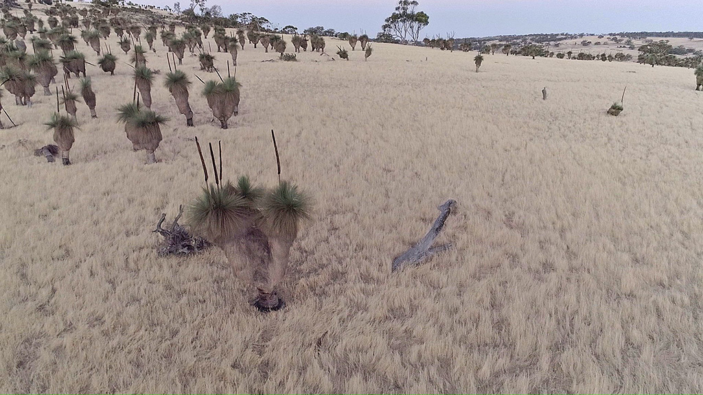

Hi.
Im pretty new to Litchi and am getting a handle on it.
Something I really want to do is film half way up a group of trees - they are in Australia and are called Grasstrees, Balga trees and the old term was Blackboy's - it was said they looked like an aboriginal hunter with a spear pointing upwards.
Have look at the pic attached.
I want to glide through a group of these trees using waypoints - Im not skilled enought to do it manually. Ive tried - the camera yaws to much (due to my low rent skills) and i have to continually rasie the elevation of the camera due to upward sloping terrain. So I figure waypoint is the way to go.
But...in Litchi Mission Planner I have an Google aerial perspective of the area and while this can point me in the right direction (using the P4P) it doesnt take into account the rising terrain on the upper left to the shot, nor allow me to mission plan the pinpoint accuracy I need to navigate through a tight path. It's tight squeeze but thats whats the shot requres - to be in and amongst them.
Any idea how I can complie this mission with the accuracy needed?
Thx

#2 Your path you want to take closest distance between the trees.
#3 Have looked at Virtual Litchi Mission, Virtual Litchi Mission
#4 I have tired some things similar on my own property, decided the GPS wasn't accurate enough.

When you have time . Using Litchi fly to the various waypoints and adjust them while you are there so that you have the right spots ( about 7 m above the points , so you are not terrified ) , then later adjust the heights of the waypoints . This has worked for me and in alot closer vegetation than you have with the blackboys . Should look very nice when you are finished . Don't forget to keep adjusting the height up as you go up the slope . Height is from where you take off . Fly it a couple of times at the 7m before you start adjusting , so you are confident of everything before you adjust the height . You can also adjust your speed . All the best and take it slow . There is no hurry . The old bloke said " The hurrier I go, the behinder I get "

I plan the mission in Litchi then fly it in VLM app (Virtual Litchi Mission) you can get it quite accurate using this. The next thing is you can interpolate your camera so as to show only the area you want and at the angle you want. The great thing about Litchi is if you can walk the flight path you can add your waypoints and fine-tune them as you go. Good luck.
I 'plan' difficult missions by flying the desired path manually in waypoint mode an place waypoints at strategic positions with the C1-button.
Position, Height, Heading and Gimbal Pitch are all stored at each waypoint.
In general settings Heading Mode must be set to 'Custom(WD)' and Default Gimbal Pitch Mode to 'Interpolate'.
2 things Litchi cannot understand trees from google maps it looks only at height above takeoff. You must manually set Litchi up to actually use height above ground at any given point in the route. It works fine when you do it, but is a little fiddle to set up.
