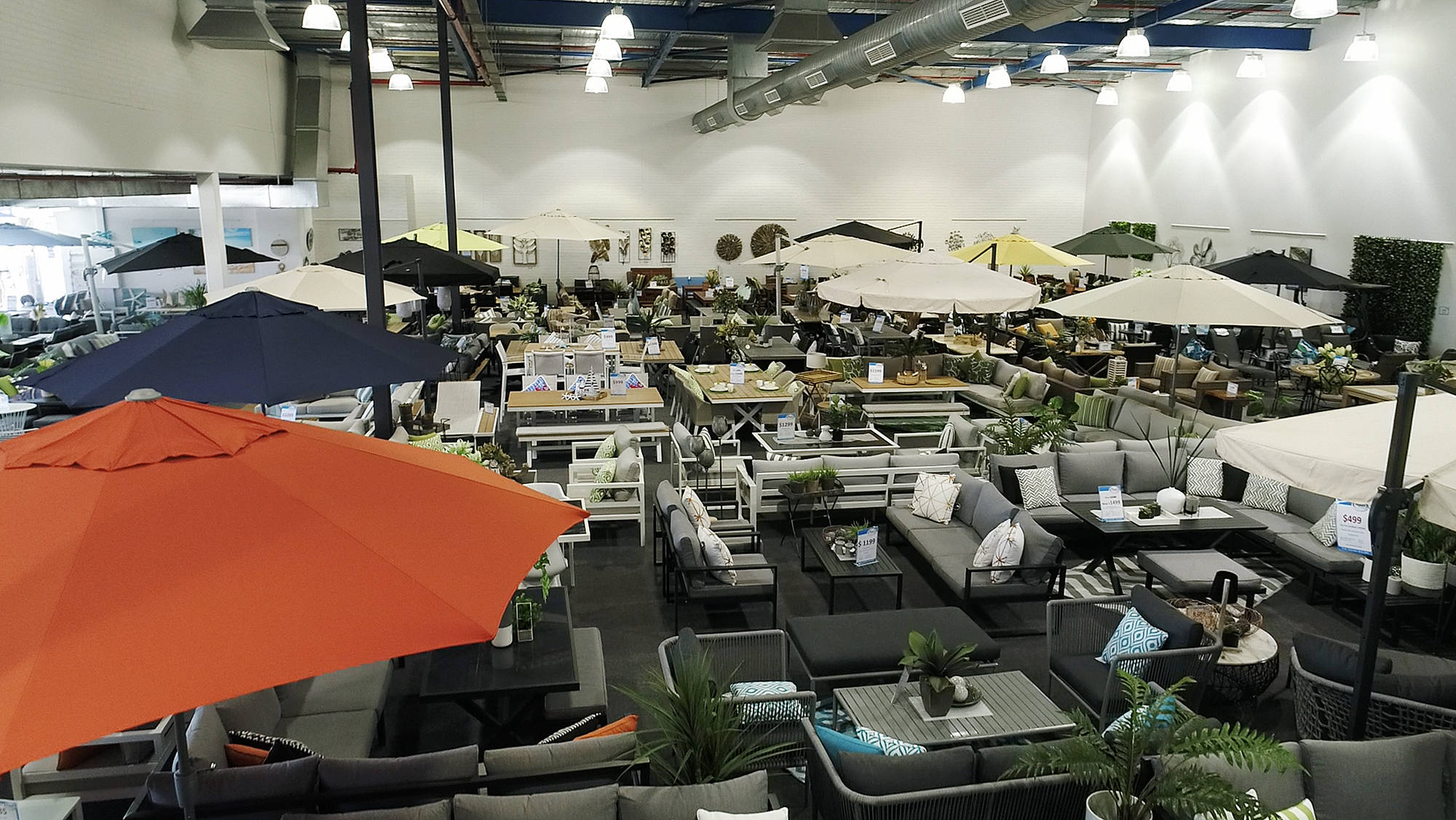

Hey John sorry for being a bit vague, but to answer your questions: I say warehouse but it was a warehouse size store. No GPS lock at all so yes in No Positioning Atti mode. OA was off. Enable Vision Positioning was on. Lose of Signal set to Hover not RTH. Tripod Mode. Here's a still from the video to give you an idea on the space. Of course, no customers were allowed instore during filming.
Really had no problems. If it was going to fail it would be pilot error. :)

That's good to know. I've never flown a job like that and was hoping my expectations were what you described. As long as you don't have to exceed 26' with VPS enabled, the craft should handle like P mode outside, but without GPS or compass. That job you did reminds me of a video Ken Heron did about a month ago in a furniture store. Thanks for the confirmation.
