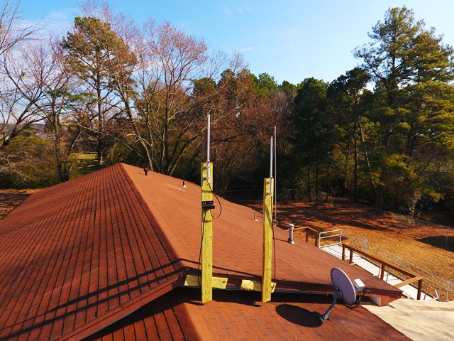

Ok so I want to mount a pole, only one and prefer fiberglass due to lightning. My concern is finding one strong enough and needs tie down spots while staying within a decent money range. I have done my searching and found a few different ones that may work, but would like some outsider advice.
Getting rid of the wood and replacing with a 20' pole mounted were the wood is now. Do not want to go from the ground up because it would use up what slack I have now to move to the edge of my roof to the pole.
I know this is not as technical as you guys have been talking,but still like some help.

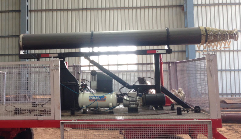

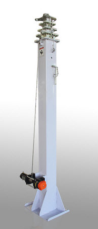

Looks like a good start :) Lightning wise you anyway should use a lightning arrestor in case you want to keep the mast extended permanently. Getting the antennas up will definitley help to get around these trees seen in the picture.
The issue is how much money you want to spend. A comfort solution vs a budget solution. There are retractable masts available that use a small electro-motor to get from small to big or you just use a carbon fibre pole that you ground with a lightning protection. (anyway you should use it even if you use glass fibre due to the antennas mounted on it.) Here some taller versions. There are smaller versions available and of course also these poles with clamps.
Reactions: GrammatonxXXxCleric

Hell I am not even blue collar anymore. More like no collar, paralyzed and disabled. I saw the rohn masts and they're priced about right, but with my luck I should probably avoid a big metal pole on top my house even if I do ground it. IBV I like the looks of those adjustable mast, but hate to see the price tag. My other concern is mounting it to my roof and not letting it get blown away. Gramm I might give that fiberglass pole company a call and see what they think.

Same problem I deal with Bear. Tree's all around my house...
Mounted mine the same way...
Low loss lumber ..Lol
Good luck getting them up in the air. Let us know what you come up with and how it performs.
I'm afraid I would need to go up at least 75ft.
I'll have to settle for the 5 to 8K range circle I play in punching thru the tree's.
