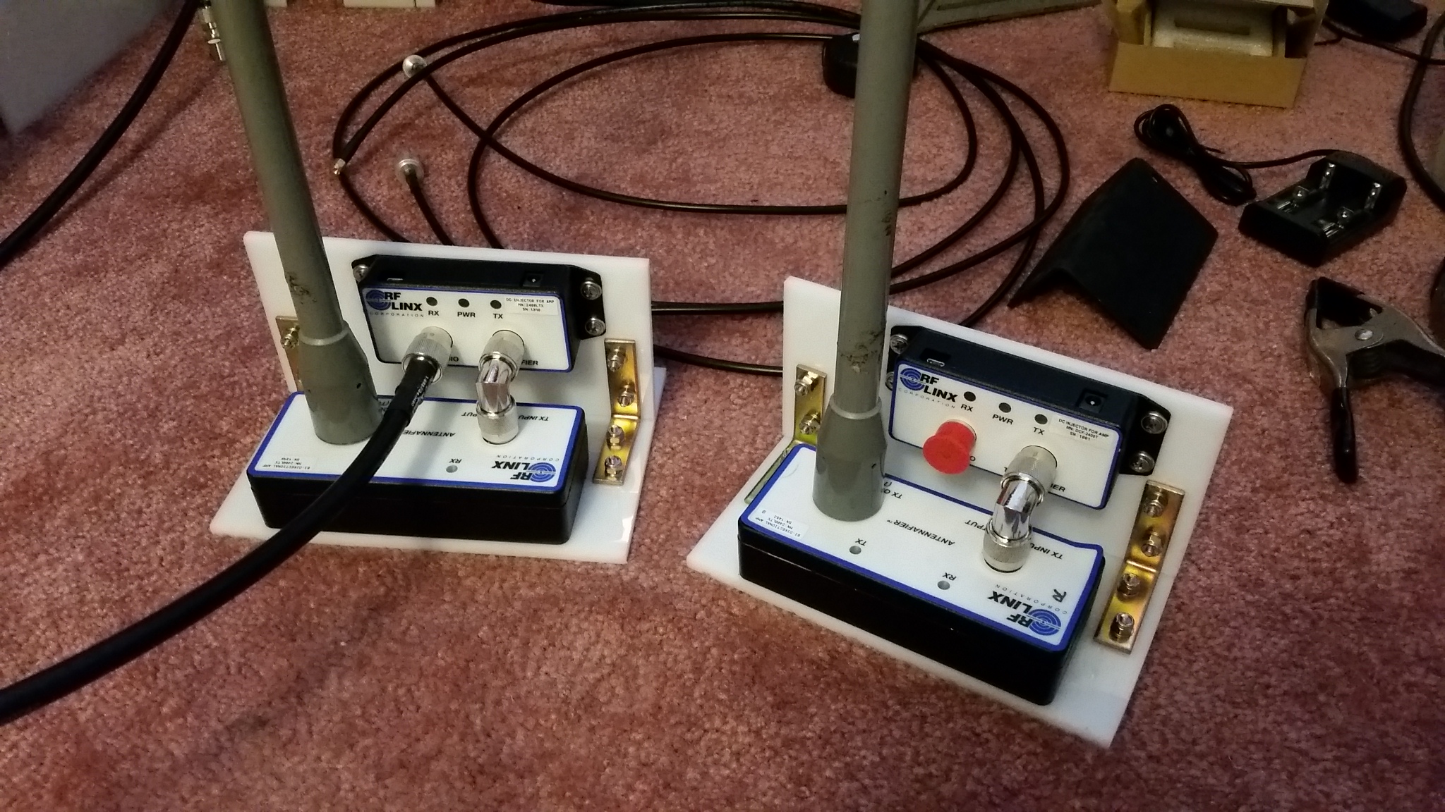

This looks like working great. I got similar setup. What N-male antennas are these? It seems you use the injectores only as power supply directly connected. For tripod setup I use the indoor LTX 4 watt amps without injector. However, curious to hear from your testing runs!
These are L-com 9db mobile ant. 2400LTX connected. Base of these attach to tripods. How do you use these amps without injection? I opened one up and don't see any power connection option. I just bought L-coms 15db antenna, and will be trying them out on these amps. (If it ever stops raining).
Good question...
Indoor: LTC, LTE, DTC, DTE, PTE
Outdoor: LTX, DTX, PTX
