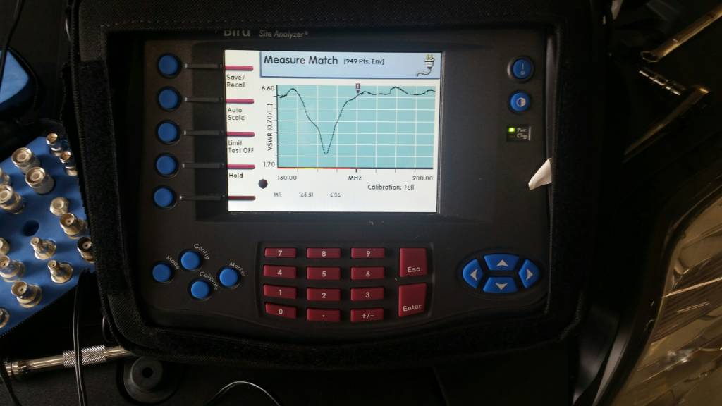

Got the new SMA's installed. Here is the readings. There WAS an improvement. I am hoping my next antenna test will be much better...
Nice to know the immersion isn't as much of a piece of crap people says it is. :) Thanks for the comparison.
It is not substandard. The IT-24 seems to be agreeing. The IT-24 has a better display but the numbers are what's important.

Did a cable length test to see what loss would occur. Surprised at the numbers.

I'm highly encouraged by the results. Replacing the controller output SMA's did the trick I think. No wonder I was having video cutout like I did.

Well, changing the SMA connectors fixed the problems completely!! Only normal video feed loss from multiple trees and buildings. I was able to fly out to over 9,000ft this time. Trees covered that direction so I had to turn back. It also started to rain. I was then able to get low to the ground under 10ft.on the way back in.(Low close to home). So twisted SMA connectors are definatly a NO GO condition. Will post the video shortly. (I'm gonna marry my 15db "Bats")
