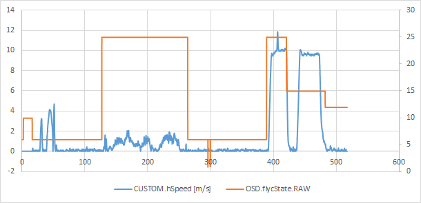

I mentioned a couple of posts back (http://www.phantompilots.com/threads/flyaway-in-follow-me-mode.76638/page-2#post-784421) that there are two types of FollowMe mode flyaways. The posts so far seem to assume that this flyaway was of the type where the tablet didn't have a accurate GPS coordinates. I think that this flyaway was due to the second type of FollowMe mode flyaway; i.e. the tablet has and transmits accurate GPS coordinates but a software glitch on the P3 corrupts those coordinates. A really good example of this type of FollowMe mode flyaway can be seen here. and for the next 20 or 30 posts.
These flyaways always occur at the exact moment that FollowMe mode is initiated. That's what happened in this flight the second time that FollowMe mode was initiated at time 392.2
The orange line going to 25 indicates FollowMe mode. The second time FollowMe mode is inititiated the blue line (speed) shows the P3 going from near zero to 22 M/sec.
Just to be clear type 2 FollowMe mode flyaways are not caused by the tablet having a less than accurate GPS fix. In that regard questions about cell towers causing GPS problems are moot.
@Gpanek If you want to know for sure if this is what happened to this flight you'll need to retrieve and post the .DAT for the flight.
I noticed a couple of post where it was stated that the logs indicated that the tablet had inaccurate GPS info. How was this determined? AFAIK there is only one .txt converter that yields the GPS coordinates of the tablet. And, that converter shows the tablet GPS coordinates being (0.0, 0.0)

I'm on travel and won't be back for a week or so. I'm restricted to my iPad and don't have access to my normal PC. Is the .txt you attached the same one you attached earlier in this thread? That was the .txt I used to produce the plot in my post you replied to. To know more about your incident it's necessary to have the .DAT. Go to datfile.net and select the "Retrieving ..." Tab to see how to do that. That might help if you're pursuing a warranty claim with DJI.
In the FMM incidents that I've looked at it seems that the conclusion is don't use the FMM.
If you can find the thread where @AndersGB had a FMM incident I think you'll find that really interesting.
