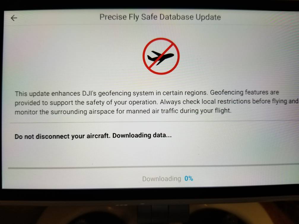

Fly Safe Database Update wont download?
Same problem! Very frustrating.
precise fly safe database update won't download? can anyone help?
It's been widely reported that there's a problem trying to download that Fly Safe update. Unsure if there's a fix coming any time soon. Others here may have something more to add. I just ignore it for now until its fixed.

They recomend having Internet conection,,with your picture you got usb still in remote going to drone,won't work,it won't become disconected from drone,it will still have blue on the go fly logo we click to enter app
I'm not sure I understand. Once I get the prompt, take mini usb out of the controller and leave the mini usb connection in the P4?
So it will update with just the wi-fi between the two?
There is only ONE usb port on the P4. Taking mini usb from remote and connecting to P4 would make updating on wi Fi only?
Is that correct hook up to make it work?
I understand that works with a separate tablet or monitor. I have the P4P+ so unplugging from the back of remote is not an option.
If anybody knows how to update the "presise fly safe database" on a P4P+ I would take anything to get it done. Oh and DJI Assistant "refresh" doesnt include the fly safe issue.

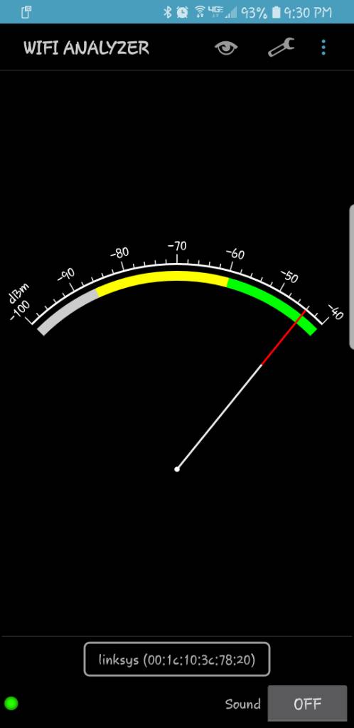

UPDATE 7/6/21: the issue was the direction of the cords. The adapter cord needed to go into the drone, not into the back of the Controller. It seemed to do the trick - and I found that my home WiFi was interfering with the data transmission so I turned off my cell phone and home WiFi networks and the update worked in a few short seconds.
