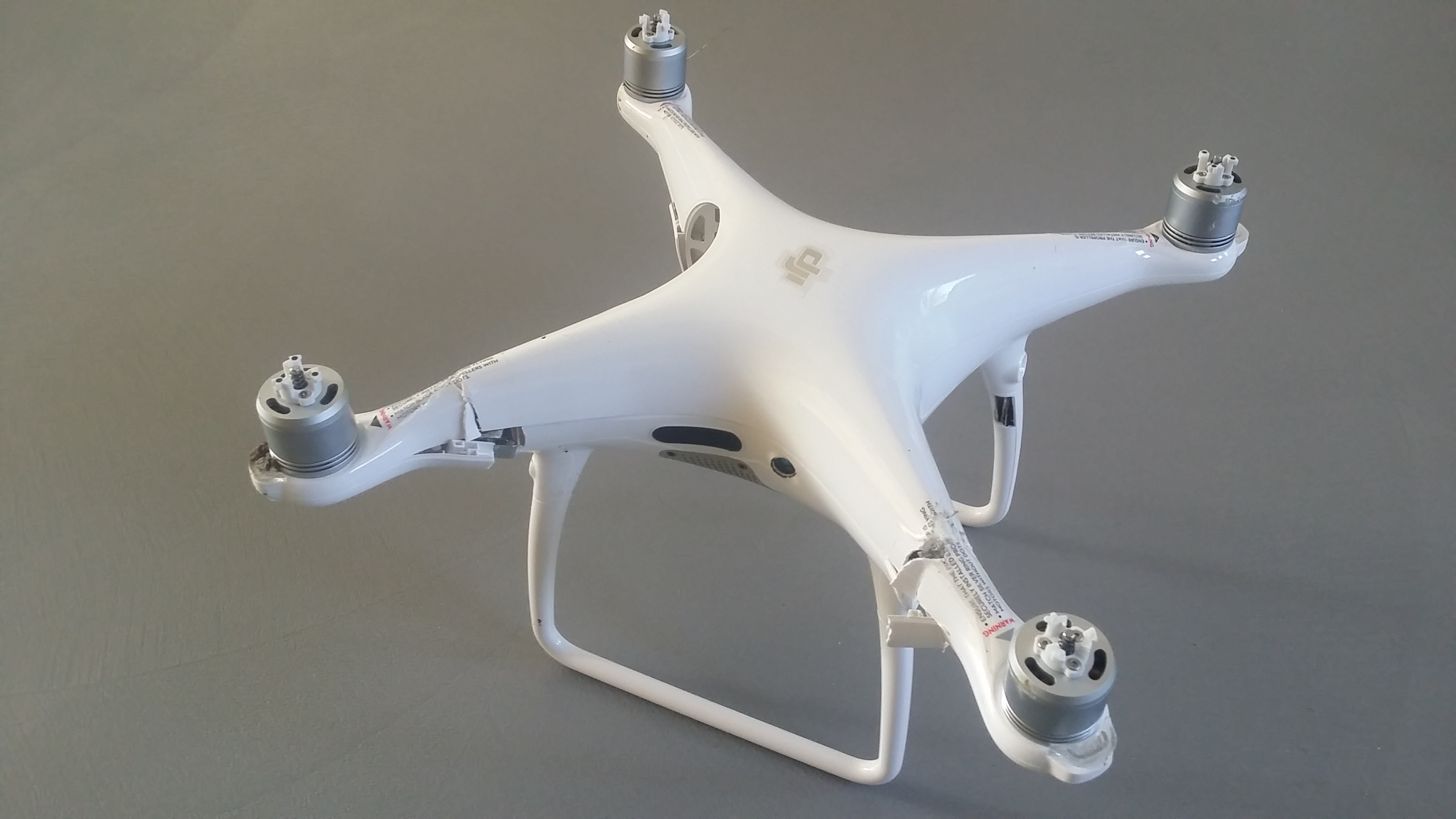

Finally, after sending the drone to DJI on the 17th of august, I had a reply from DJI... yesterday.
So, more than 2 monthes later, here is this answer:
“SN: 07JDE1C00101HC incident date: 09/08/2017 14:42 (GMT+8)
1. Due to the weak GPS signal, the aircraft was working in optical mode after taking off, and finally changed to Atti mode;
2. The aircraft cannot hover and position in Atti mode, and the avoidance system cannot work;
3. At t=13:54,h=38m,The aircraft crashed and caused the attitude imbalanced;
Conclusion: pilot fault, non warranty is suggested.”
tl;dr : In ATTI mode, you're f**ked up.
I'm disappointed by the lack of concern and feedback from DJI about this case. It's now a 1000€ (~1200$) bill to get it replaced through RMA.
This whole experience leaves me with quite a bitter taste...
My personnal conclusion is that there is still a very long way to get those birds as reliable as an eBee, for exemple, which I can still trust after 400+ flights and 5 years of duty.
For professionnal purposes, especially in photogrammetry - i.e. you don't fly where you would like to, you fly where you have to - I think this is not a proper device, except if you consider those as consumables, and if you budget to buy one replacement every 6 or 12 monthes. An if you wear an helmet, just in case...
Anyway, feel free to share your feedback here, I would appreciate to know how you would react in my place...
Thanks!

Yes ... you did miss something. Here's what DJI says:
DJI warrants that each DJI product that you purchase will be free from material and workmanship defects under normal use during the warranty period.
DJI don't say anything at all about using atti and warranty.
The thing is that your incident was not due to material and workmanship defects under normal use.
It will be the same with your car.
The maker will guarantee it against any faults or malfunction, but they won't cover you against driving into a brick wall on an icy road.
If you were flying in atti mode and the Phantom crashed due to a malfunction caused by a DJI problem, they would cover it.
But fly in atti mode (or any other mode) and crash into a rock wall when the Phantom's systems are working perfectly, and DJI will say that's your problem.
Flying in atti mode is quite safe in many situations, but using atti mode close to a cliff edge and at a distance, is very risky and even for an experienced pilot it could be asking for trouble.
DJI didn't knock back your claim because you flew in atti mode.
They rejected it because the crash was not due to anything DJI could have had any control over.

Flying in atti mode is like driving on ice with no brakes.
Your drone can't stop, it can't hold position and drifts with wind and inertia.
It will appear to not respond properly to your controls - that's what happens in atti mode.
Flying in atti mode close to a cliff is like driving on ice with no brakes close to a rock wall.
It's asking for trouble and if you do it at a great distance and with little experience, even more so.

Don't fly close to cliffs without GPS position holding because it's asking for trouble.
Your brakes weren't faulty - in atti there are no brakes. That's a limitation of atti mode and you chose to fly that way.
The last thing I need to hear, is someone telling me: "you deserved that, you where flying near a cliff in ATTI mode". Of course I was, that's what drones should be used for in the professional field...
Sorry but it's the most important thing you need to hear.
You don't drive your car over a cliff because you know that it has no anti-gravity feature.
You need to learn that if you fly in atti mode, your drone has no ability to stop or hold position and can easily be crashed if there are obstacles nearby.
Understand the limitations of your Phantom and work within those limitations. Don't try to make it do things it can't just because you'd like it to.

No .. I'm telling you that in atti mode, a Phantom can't do whatever you want.
I've gone over this already but you don't seem to have taken anything in.
Without GPS, the Phantom can't tell where it is and the obstacle sensors can't operate.
The Phantom can't stop and it can't hold position.
That's just the way it is.
With GPS it will do all you want and more.
Solution: realise the limitations and don't expect it to do things it can't.
The problem is your (mis)understanding of what it can and can't do - not a design fault.
I doubt you'll find a more suitable drone without spending 10 x as much and maybe not even then.

We don't have good data on the aircraft's flight path because it had no GPS, but we can tell from the pitch, roll and yaw data that it was responding appropriately to stick inputs. It appears most likely that you became disoriented in respect of the aircraft orientation and applied the wrong stick corrections. But, either way, all DJI will see is that the aircraft was responding to commands and that it flew into a cliff in ATTI mode. On what grounds would you expect them to cover that under warranty?
