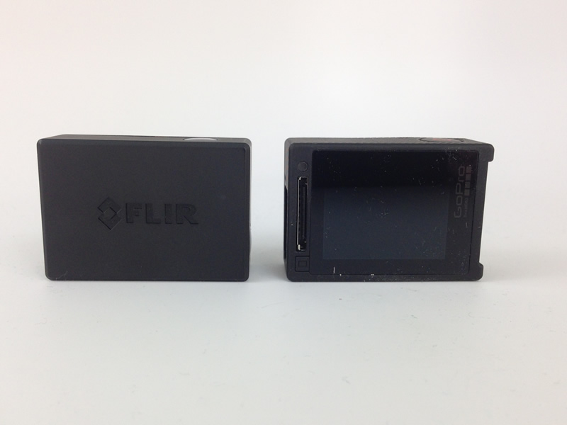

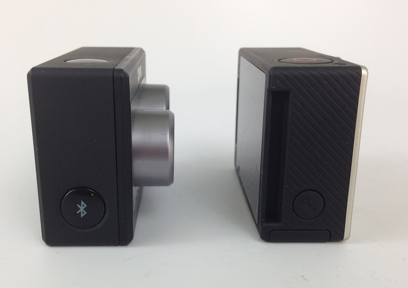

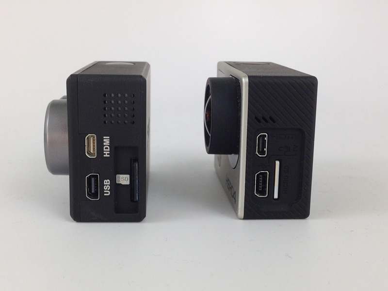

Here's a comparison of the FLIR Duo to a Hero 4:
View attachment 75193 View attachment 75194 View attachment 75195
