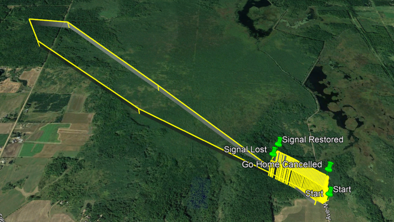

You lost signal at waypoint 4 for quite a long time. It was not restored until somepoint near waypoint 5. At that point it was already in RTH or it just started. You will know more from the .dat file.

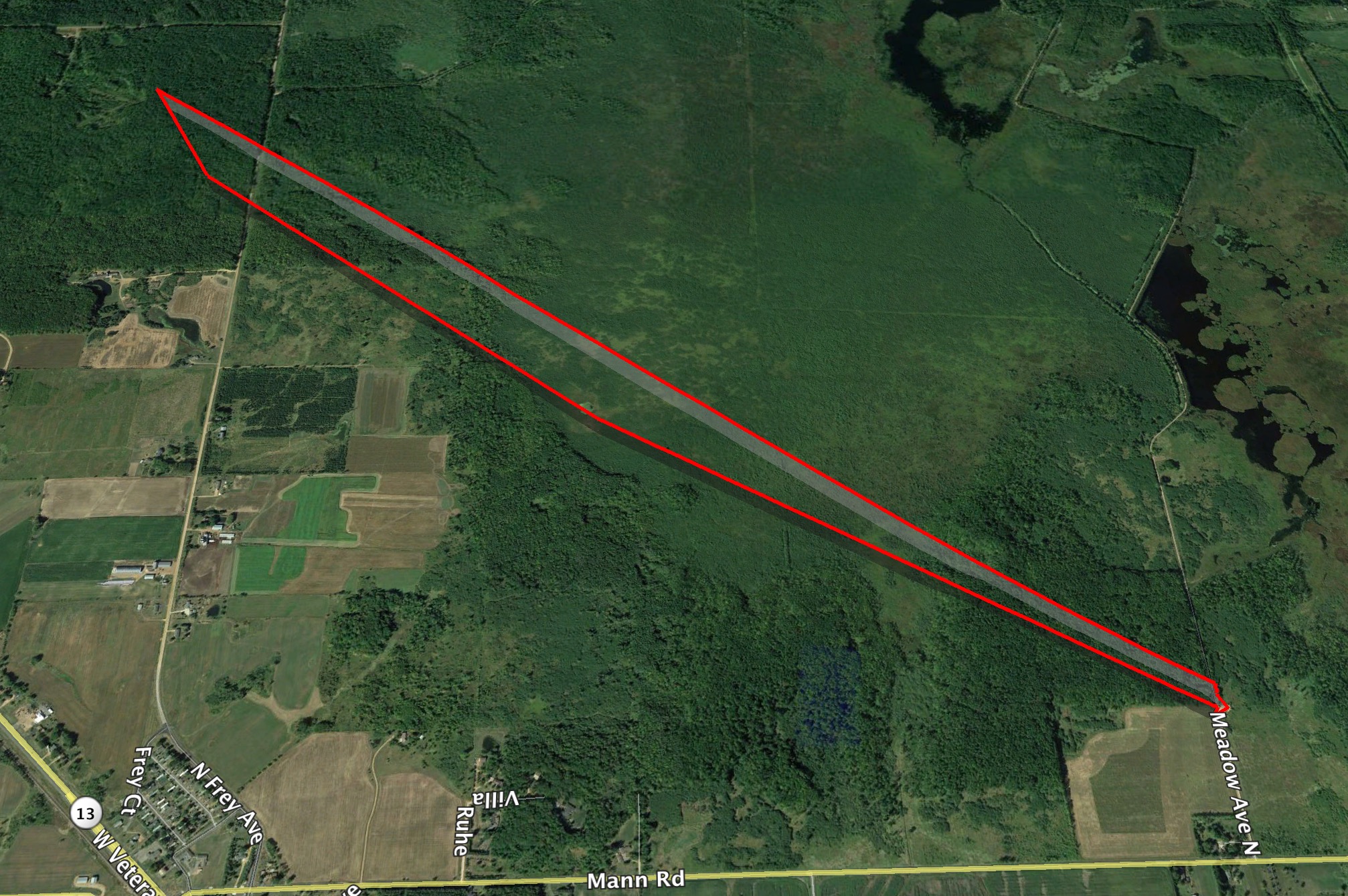

At waypoint four it was to do a panorama, but did not. At waypoint 5 it was to start recording but did not until it came back into telemetry range. Also, it initiated RTH as it came into range again instead of continuing to final waypoint and then RTH.
As per the GE profile above, I suspect that the "actions" did not complete, due to loss of signal at both waypoints 4 and 5. As for the reason for RTH, that will need to be determined from the .dat file. Telemetry transmission has nothing to do with initiating RTH. Some actions do require a connection to function, as was stated previously.

Also, just looking at this farther, your Airdata file does not match up with your mission plan. I had to look twice, but verify this.
The short flight is your Airdata file.

Dawg, that is the flight and file. Airdata will not show data beyond controller range, hence the discrepancy between the airdata file and mission hub. The data quits at around 1754, and starts again at around same distance. A Treeline impeded controller range. Thats why the apparent rectangular flight in air data. Its showing only the start and end of the waypoint flight.

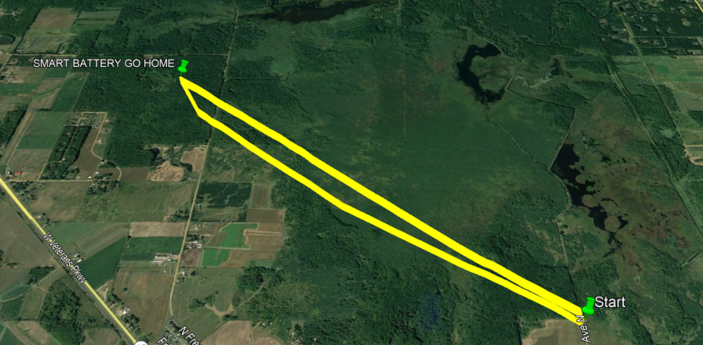

That was the correct file. This was simply a smart battery go home event, initiated at 402 seconds between waypoints 3 and 4. The FC determined that there was insufficient battery reserve to continue the mission:
397.798 : 22249 Waypoint 3 reached, now I am in state 4 size is 6
397.798 : 22249 Ready to handle action [340.29]
401.698 : 22444 [Ctrl<11>] REQ_BATTERY NAVI_GO_HOME ctrl_navi_go_home
This looks better from the .dat file. Smart Battery RTH.

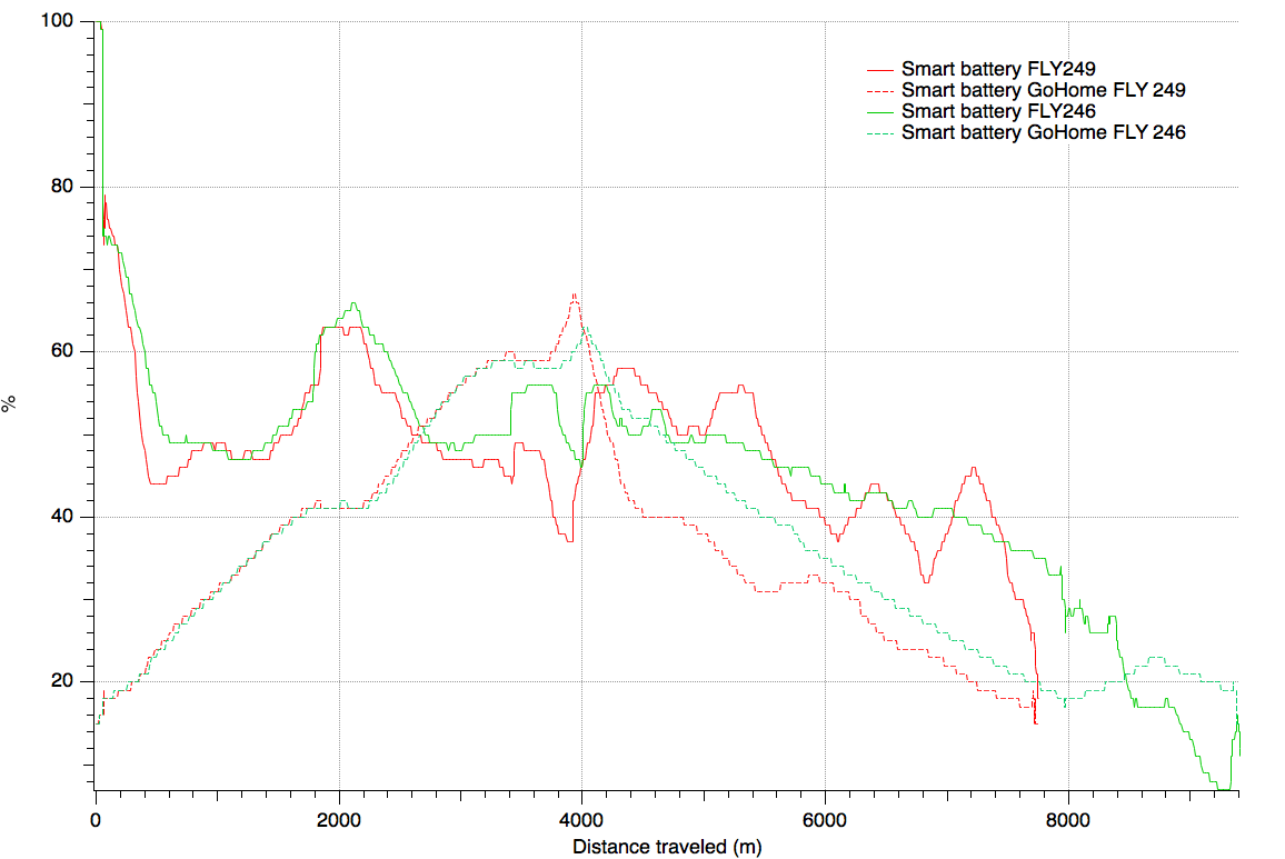

The comparison with the previous flight with the same mission is interesting:
Comparing the smart battery % and smart battery GoHome % values the two flights look quite similar, but the RTH on the later flight was apparently triggered by the sag in battery percentage at 3800 m (solid red trace) that was much less pronounced on the earlier flight. Probably that was due to differences in the wind field.
But I'm still not sure quite how this worked - in other logs that I've looked at, smart RTH kicks in when the battery % drops below the GoHome %, but that's not what happened on these flights. Ideas? Comments?

The solid lines are the smart battery % readings. I'm used to seeing them decrease much more smoothly than that.
The dotted lines are the smart battery "go home" estimates, which I normally expect to be an estimate of what remaining battery percentage is needed to get home from the current location. Those go up as the aircraft heads away from the homepoint, and then decrease again as it heads back. Those look about right, but then RTH should be triggered when the battery percentage falls below them, which it was not in either of these flights.
