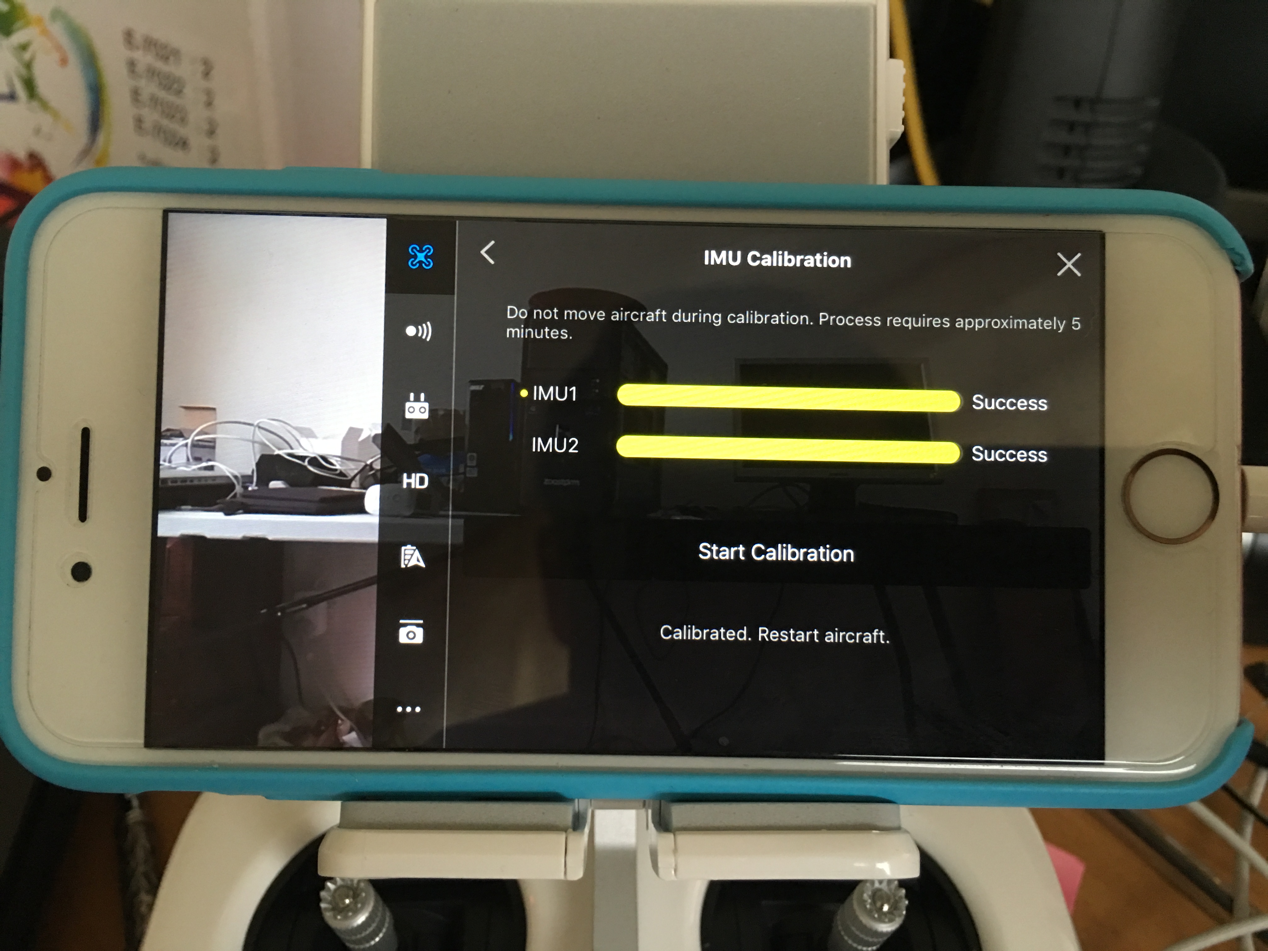

Ok I have had a breakthrough with updating the RC and Bird. I had to use my girlfriends iPhone 6s in order to update. I don't know what the problem is but if I try to update on my iPhone (6s Plus) I keep getting the continue download problem where it gets stuck on 0%. I have no idea, anyway, I am going to plug my phone back in now and check all my settings, calibration e.t.c Out of interest what device do you have ?
I will plug my phantom into my laptop in a sec and see if it finally detects the firmware on DJI assistant 2. Good luck with yours later. Pics below.

Working on the laptop now that the firmware as updated through the GO app. Re calibrated all the sensors and if I get time will go for a flight to make sure all is well.
