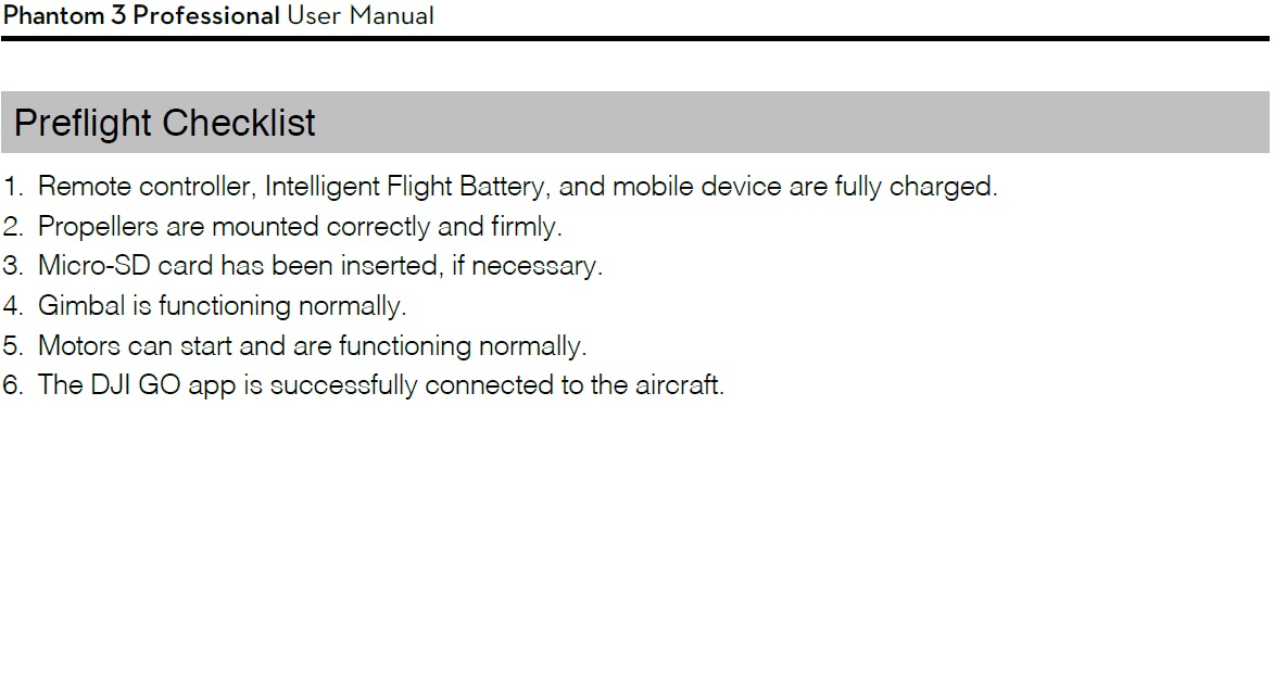

I don't think my post was reactionary, yours certainly fits the definition though. Go back to post 15, he says it is not reasonable to say only fly on a fully charged battery. Well since DJI says in multiple places that you should only fly on a fully charged pack, I think it is more than reasonable to say that you should do exactly that. Also if you think I am not helping the newbs by quoting DJI and spreading the word that you should only fly on a fully charged pack, you are not fit to fly. Please go through all of the DJI material as it has been updated several times and if you haven't, you should read the most recent versions of the manual, and intelligent battery safety guidelines.
Splendid, we can agree to differ then! Let's move on before the thread gets completely hijacked by our little disagreement.
Just don't willingly post mis-information when DJI says the opposite, and the evidence from a lot of crash stories on this forum show that what DJI says is the truth (always fly on a fully charged pack) not what Wacker2611 says to be true, go ahead and fly on your half charged packs but don't spread the word to others that it is an okay practice.
