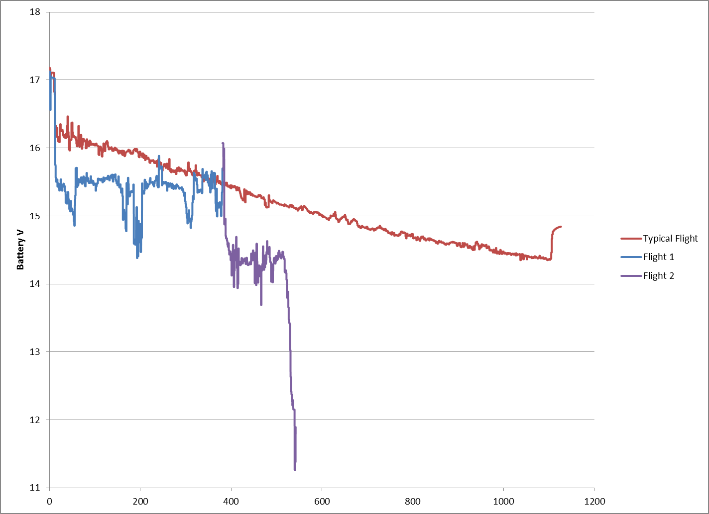

Comparing those .csv has been very interesting....the charge in capacity determined by the Phantom and my calculations by doing current integration agrees, but seems to indicate that you only had 36% battery at the start of your first flight. The voltages under load show it was less than 100%, although the data shows it near 100%, but not that low. The voltage decay does not match my example flights, it seems to stay flat. Also, on my example flight voltage and percentage correlate with a R^2 of near .9 and yours is less than .01. How may charges did you have on that battery? Do you have any idea what the cell difference is between cells? That would be in the .dat files if you feel like retrieving them. It looks like the battery life was at 85%....puzzling....
Was that your first flight?
Here's a plot of your voltage versus flight time in seconds also showing a typical flight I pulled. As shown, the initial voltage drop was higher than normal and it stayed kind of flat with some large dips. When you started the second flight the voltage started higher than were you ended it as expected, but it dropped down rapidly....
No that was the second flight ..these are the first flight
Cell 4 looks like the culprit.. But still don't think it should have dropped like how it did.
1 minor deviation isn't going to do it, guidance has been more than 10 and if from the same cell them keep an eye on that battery. I have minor intermittent deviations off and on in all my batteries and no issues yet.
Perhaps you're right, but if it were me I would still be expecting the P3 to make it home in that situation.

Need to look at the whole flight, but when lowest cell is 3.6 you should land. Check the deviation from full charge to lowest cell at 3.6, it should be small at full charge....

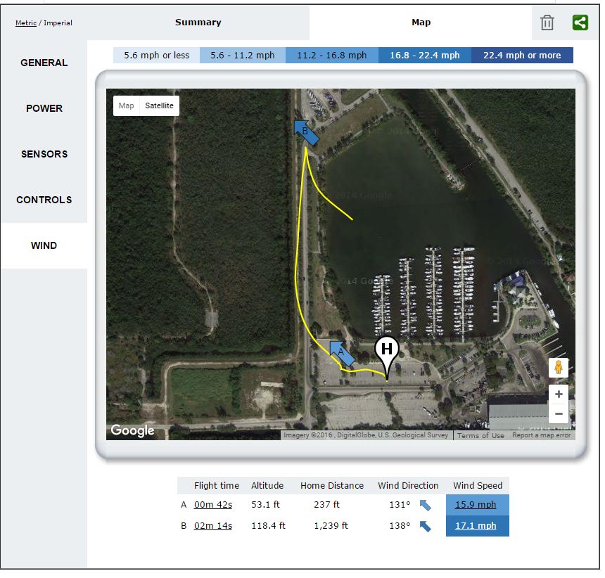

I'm going to make this short.. Flight log is attached..
At 56% left. Low voltage warning. Going to land. Looked at app.. No signal. Looked up bird is gone. Went for a swim. It was the second flight on the battery for the day, I live in Miami where temp is not an issue. Plus I have over 45 hours of flying the phantom and never had issues and pretty experienced with it.. Now what should I do. Besides fish it out.. Also I was on 1.4 firmware. I was no where close it have sticks to center if yall thinking about it too

Power from the battery is as simple as current times voltage in wattage, agree for motors it is more complicated....
There is not real mystery to these crashes, they usually start with battery around 15.5 which quickly drops to below 14.4 and then quickly to 12 V. and then everything shuts down around 12 V, perhaps when any single cell drops below 3V. The mystery to me is what is causing the battery percentage to be off. Flying on a previously used battery seems to be a factor, but so far I have not been able to recreate it...
Unfortunately the problem is when you run a pack down half way, then turn it back on & fly with the now cold pack, the results can quickly become catastrophic.
Assume you normally land at 25-30%. You lifted off at 67%. Factoring in voltage recovery, your pack was likely down to nearly 50% on the first flight. In only 2 minutes the voltage dropped to the point of shutdown. This situation is exacerbated by the power demands of a quick liftoff & countering a 17 mph wind.
