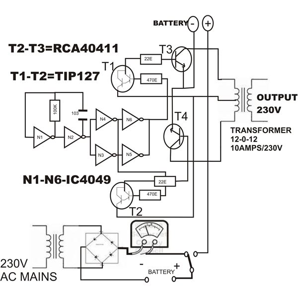

Simple inverter diagram...........

Yeah, more batteries are probably better solution.
For using 48V battery, the solution @cheddarman proposed is best.
There is another way which may in some cases be cheaper - buy 48V-to-12V DC-DC converter (costs like 30 usd), screw in car lighter socket at the end (the socket is like 1 usd) , and then use the car charger. It will charge slower than with a good inverter and wall charger, but is definitely cheaper if you already have dji car charger.
