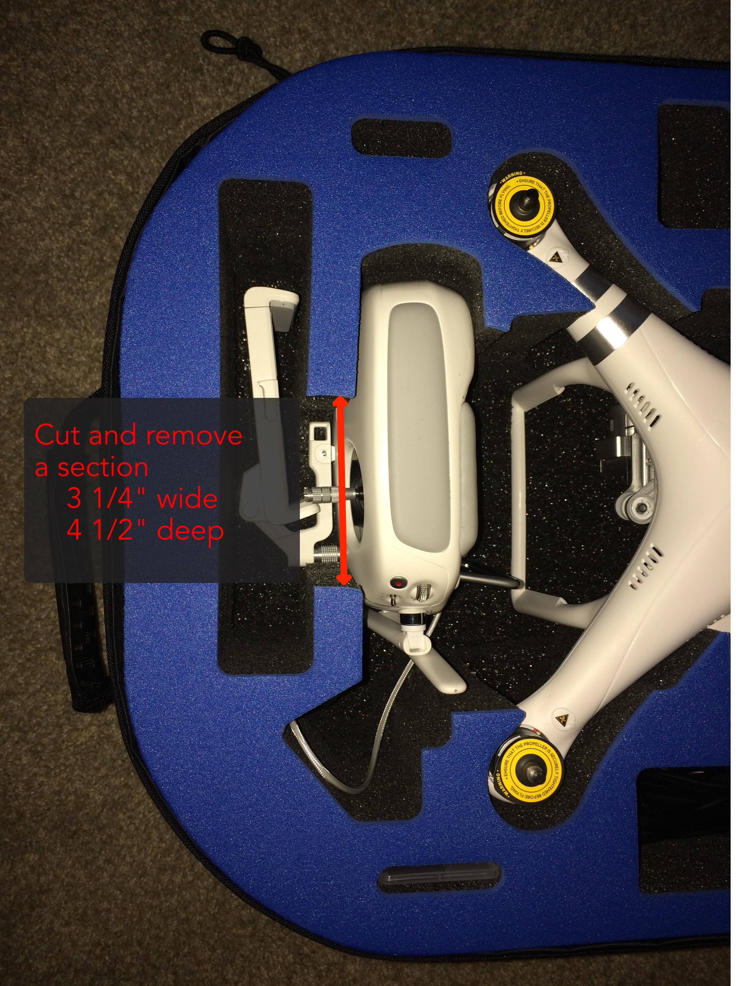

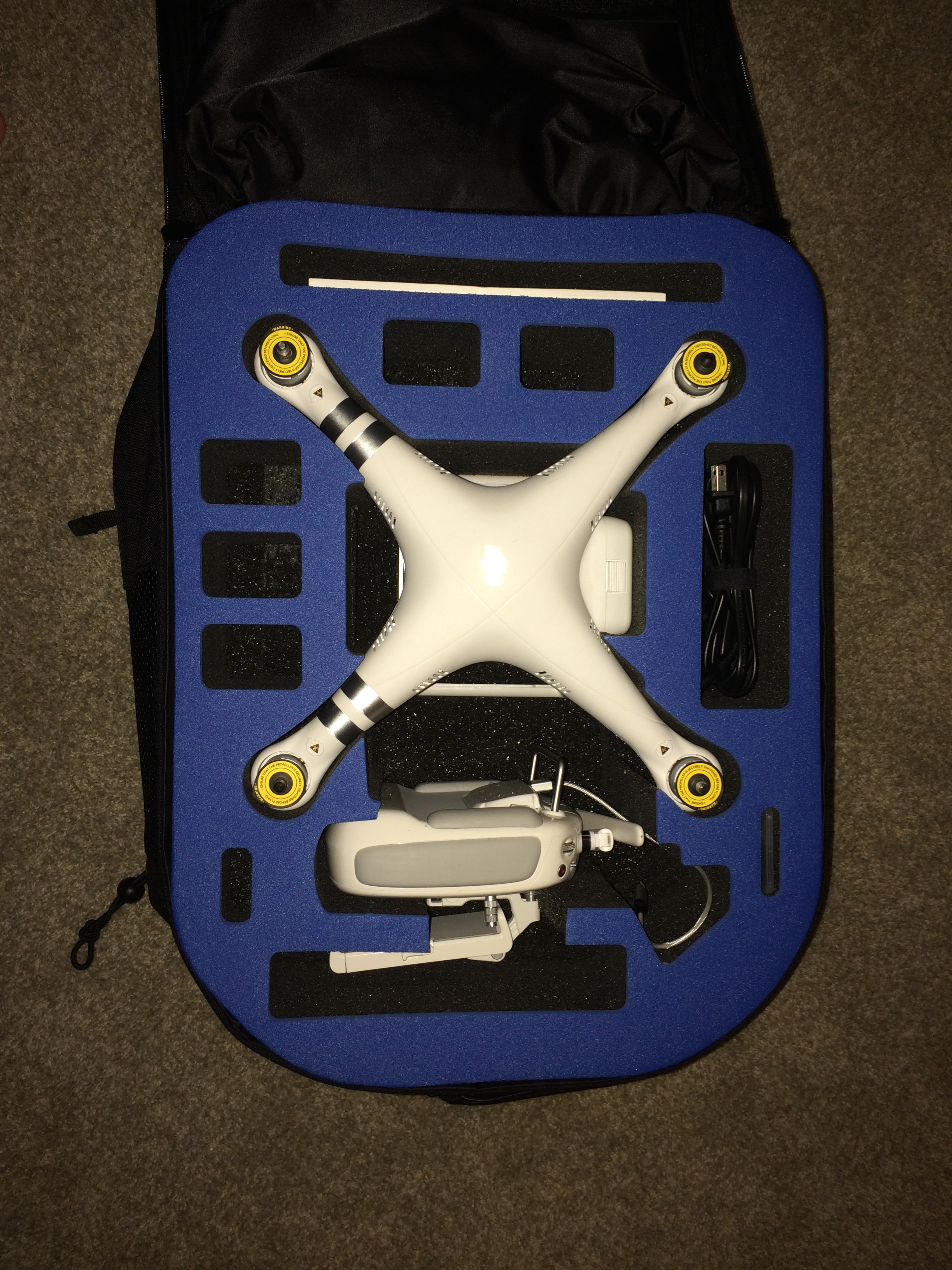

The P3 itself fits extremely well in the Fearless backpack. There is enough clearance for the longer legs and wider base and the foam inserts hug it very nicely. The one small problem comes with the controller. The P3 controller simply won't fit in the Fearless as it comes since it is so different than the P2 controllers.

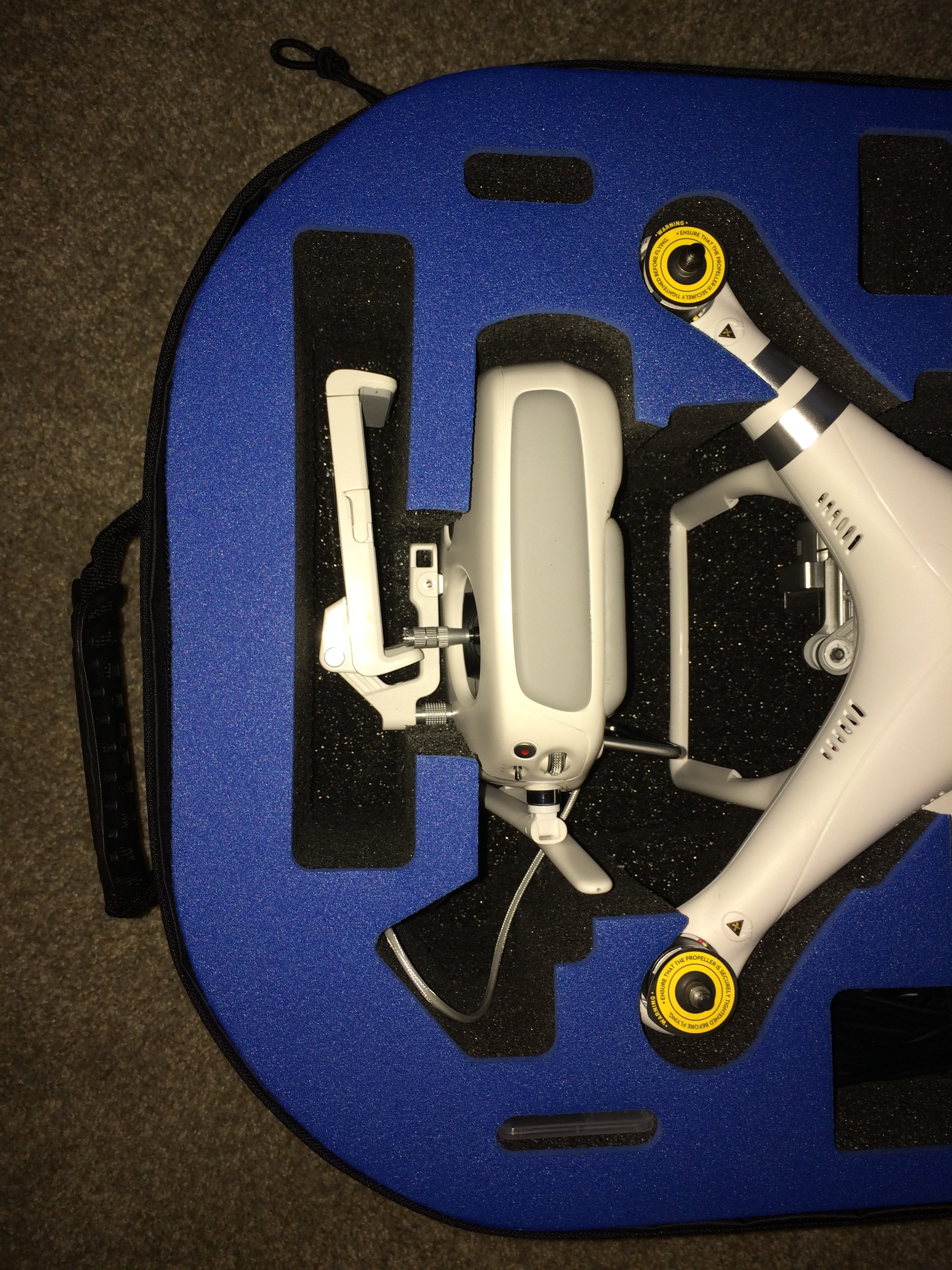

The good news is that a small modification fixed this really nicely! I simply cut out a small section of the foam allowing the tablet holder portion of the controller to extend into the top most compartment of the backpack. The section to remove should be 3 1/4" wide and 4 1/2" deep. The controller will sit in this notch but the foam beneath the notch will keep the controller from resting on the antenna at the on either side.
Otherwise, there is plenty of room for all of your accessories including your tablet, power cords, extra batteries (soon?), memory cards, and almost anything else you want to add. Of note, the propellers fit best in the inside mesh pocket of the backpack cover.
