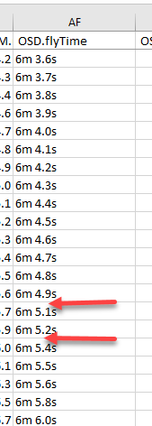

Why did the P3s show downlink lost at 6m 5.4s?
Doesn't look to me like it actually did lose the downlink. Maybe it reported lost downlink because there were a couple of missed packets in the previous 0.5 secs. There is probably some threshold expressed in number of dropped packets per time interval.
